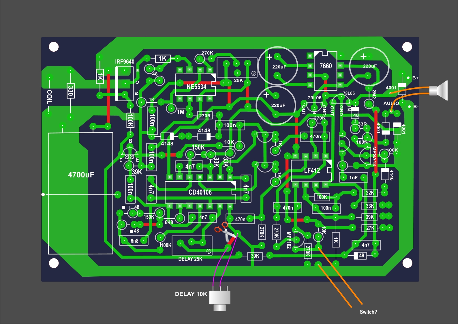

        • #94
          Vector drawing update
          I understand how easily things like that can happen. I might have been a bit strict, but I started with the Baracuda 1 1/2 years ago and found reading all the posts quite confusing and put it to the side.
          I would like newcomers to not have to go through the same experience, although I did learn a lot on the way which I did benefit from.
          As I see it you have kicked off the development of revision 3 with your thread and I am pleased to see that.
          Looking forward to having your improvements added to the new version.
          Hers the basic rev2... Click image for larger version

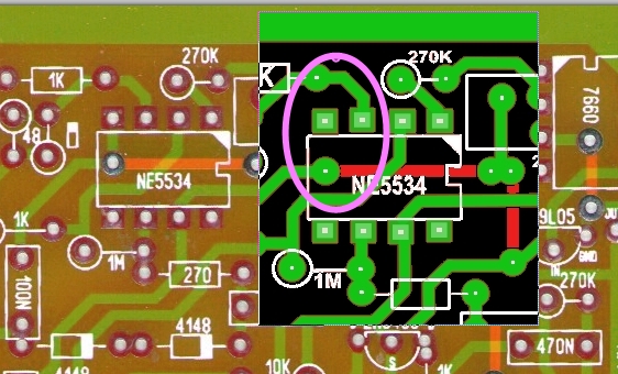

            • #96
              Originally posted by Michaelo View Post
              Hers the basic rev2... [ATTACH]35762[/ATTACH]
              Note! this X-ray and Polymers lack a connection to pin4 on the 5534. I don't know what is going on here. It appeared in earlier X-ray posts like 57.
              • #97
                Hi Old cart
                5534 Pin 4 is OK. It is connected to -5V via. two top of board links going right then down in the board top view. Plus a 100nF to earth. Or have I mis-understood?
                Ray
                • #98
                  @Old Cart: You are right!
                  @Michaelo: I assume you did a complete re-draw for the vector layout and missed that little track. No worries. Could you please put it in and post. Thanks.

                  Here's a closeup of both:

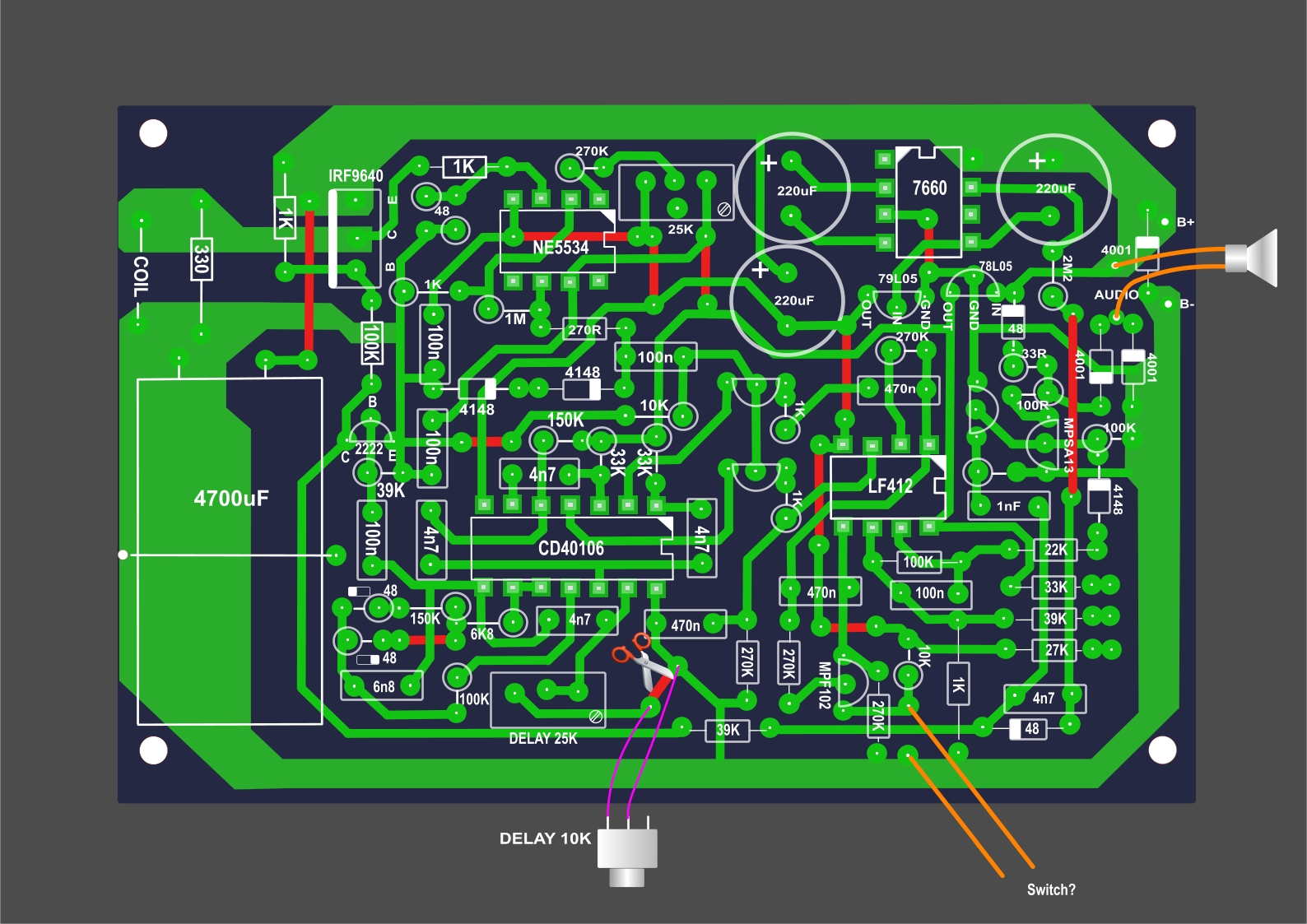

                    • It's not actually an xray it's a hand drawn vector graphics image so that we can enlarge without blur... I could blame my eyesight or old age but I simply missed it...
                      Here's an update...

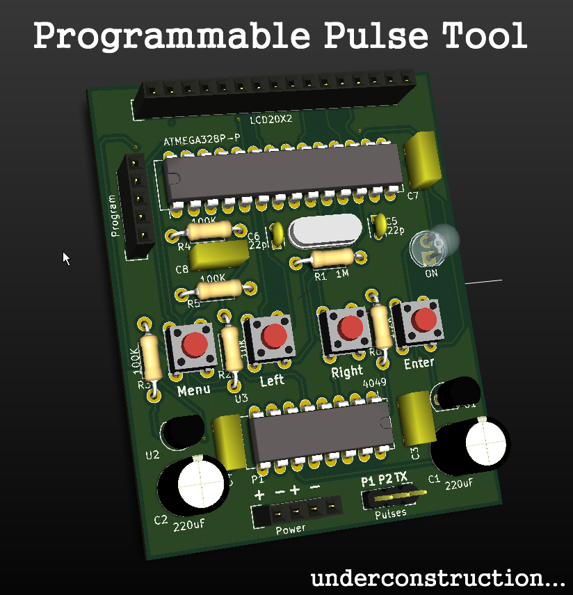

                      Slightly off topic...
                      In the process of building a little tool to allow me to generate pulses for TX and Delays using ATMEGA328...
                      It started life as a front-end to a simple metal detector but after changing several resistors to get the right timing on my bara, I thought I'd use it as a tool before I screw up the bara PCB...
                      The aim was simple, I wanted to generate an exact 100uS pulse for the coil at about 600 PPS, followed by a delayed sample pulse of 45uS and finally the second sample pulse.
                      By using a microcontroller, a 16/20character LCD and four push buttons, I can vary all the pulses and delays in 5uS steps.
                      The basic design is complete but I haven't started on the code yet... still it might be useful...
                      Mike

                        That new drawing is fine. Thank you so much
                        That pulse generator looks interesting keep us appraised about progress.
