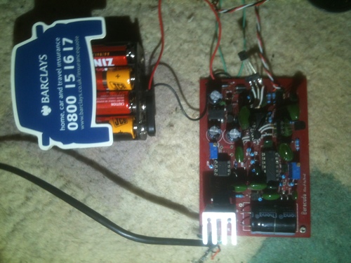

  • Good progress. Still don't see why some work and some don't. I take it my Earth field is working correctly with no modifications. Those advertising fidget magnets made out of magnetic paper have no affect on the threshold. Is this a valid test ??
    • Originally posted by Koala View Post
      It seems to depend on the Baracuda PCB version, and the battery pack voltage.
      Which version do you have? What is the battery pack voltage? And what detection distance are you getting on a pound coin? Also, what are the details of your coil?
      • Coil is about 8.5" and 29 turns of .71mm copper enamelled wire.
        Just over 12" on a one pound coin. Not optimised for that coin so I would expect another inch or so would be possible at the sacrifice of other targets.
        12V AA battery pack
        In the photo you can see the Barclays fridge magnet that's not detected
        Version 2 PCB without the switch and other FET taken off
        ~[ATTACH]35845[/ATTACH
        I will try and get a better photo tomorrow

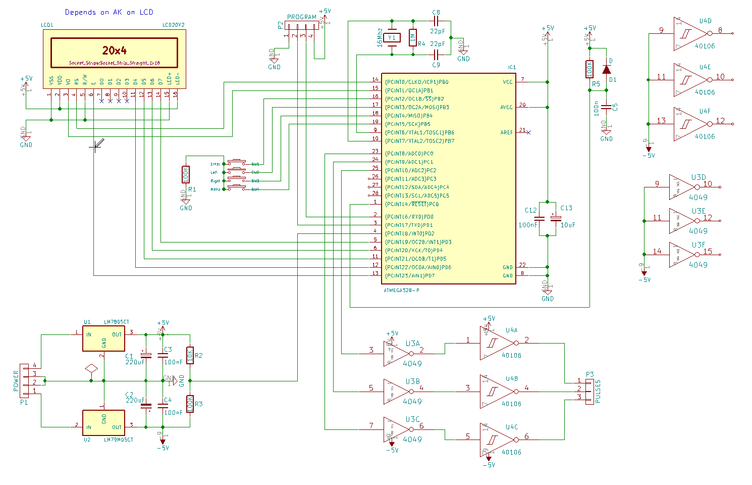

          A word on the Bara Pulse Tool
          (for anyone interested)...
          I've just complete breadboarding the design and tested the code... works a treat....
          Only remains to write the code for the four keys so I can modify the pulse timing (and delays between them) on the fly, in the mean time I'm using the default timing.
          I'm working under the assumption the the default timing is as follows... (correct me if I'm wrong)...
          • TX Pulse Width: 100uS
          • Delay before main sample pulse 10-60uS adjustable...
          • Main sample pulse and second sample widths are both 45uS...
          • The delay between the main sample and second sample is about 80-100us (adjustable)...
          • Duty cycle ~640 (pps) (also modifiable)...
          Pulses can be changed in 1uS intervals...
          The output pulses are level shifted and buffered (using 4049 and 40106)....
          My test unit is powered from four lithium ion batteries (4 x 3.7 volts) in series to provides a common ground making the design considerably easier...
          Although the unit only requires 5 volts, I have also added a -5 volt regulator to allow level shifting to 10 volts...
          This allow powering the unit from the same supply as the bara (you need the positive, negative and a centre tapped ground)...
          Schematic attached, code to follow...

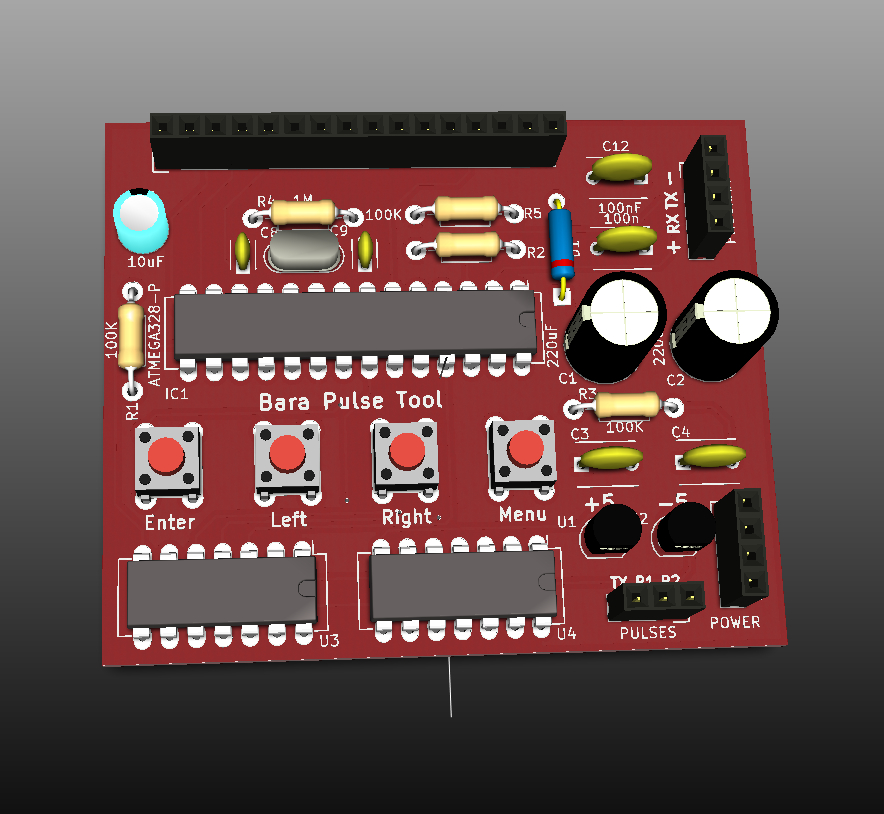

          PCB has changed a little, here's the current version...

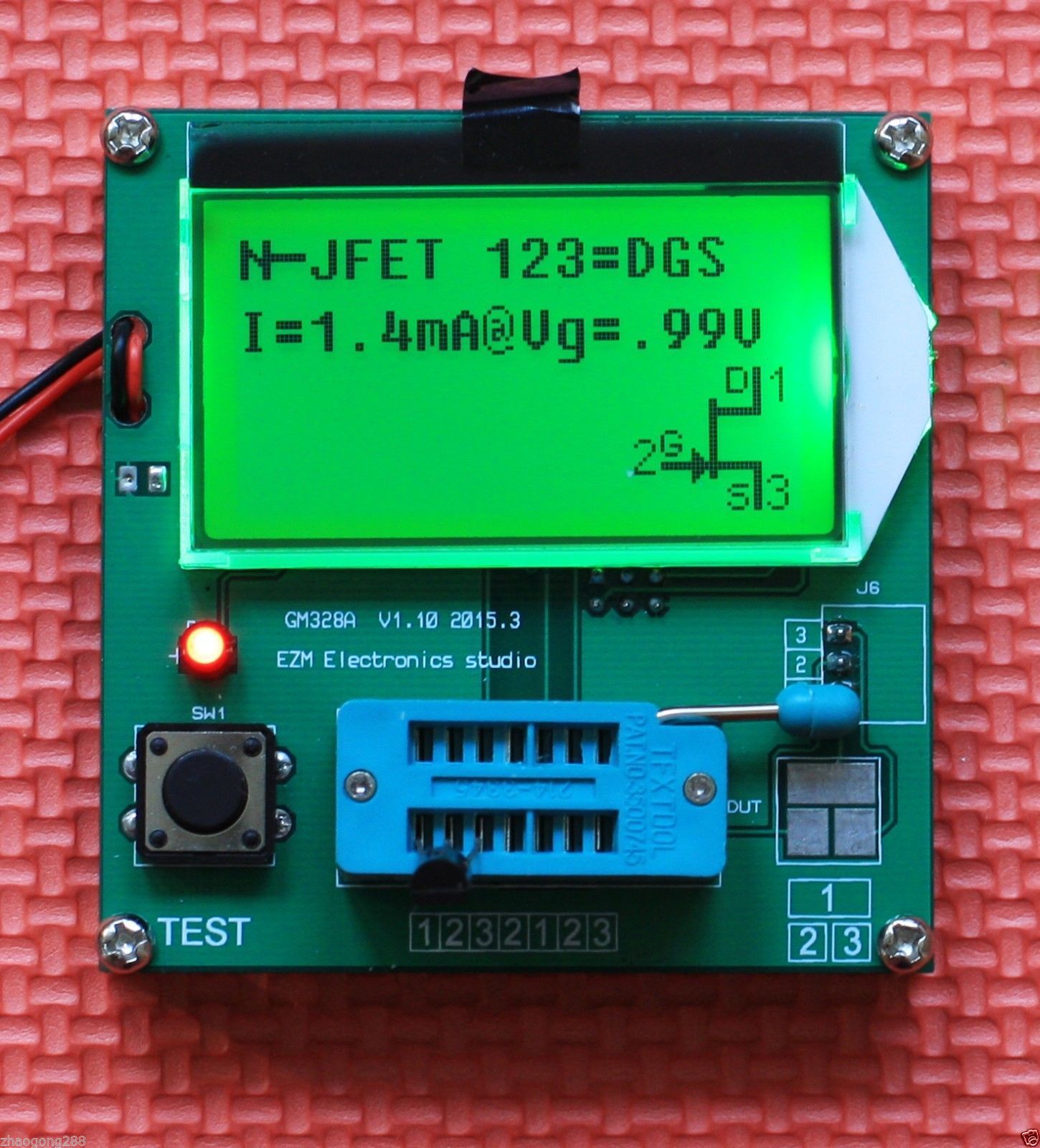

              Thats a good result for an 8" coil.It calcs to about 490uH.
                Measured at 450uH with a cheap component tester. (£10.10)
                ~Click image for larger version
                Don't know how accurate it is on inductance but every resistor/capacitor I have thrown at it have been bang on.
                Also used it to match the FETs

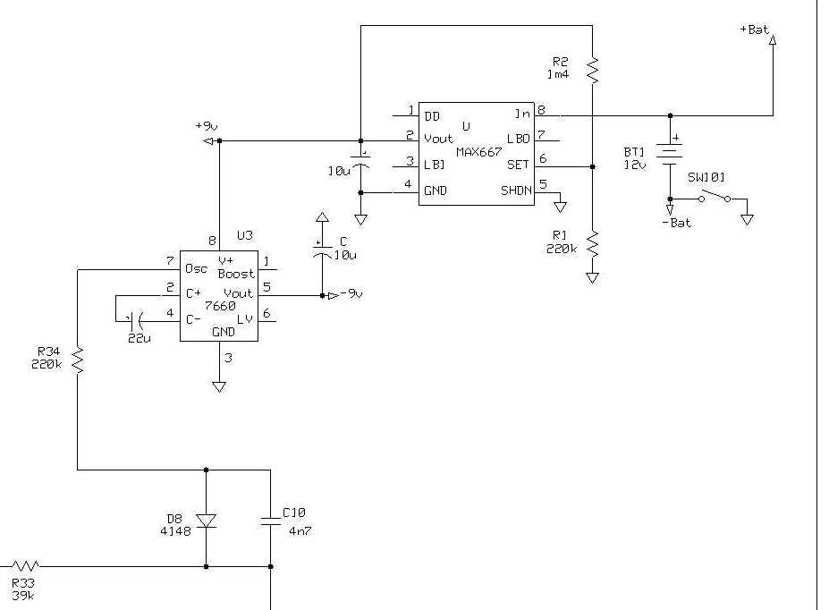

                              Q won't the 7660 still be in trouble with 12 volts applied? Maybe just specify the 7660A or a 7662 and/or add a diode in series with the supply.
                              • On My Bara I knew the 12V was going to be a problem so I added a LDO set to 9V.
                                3 Lipo's input will range from 12V - 9V roughly and the LDO works with 300 mv differance.
                                I have a lot of MAX667's so I used that for mine.
                                At the same time I increased the supplies to +-9V for a little more headroom. I haven't tried this
                                yet as I'm finishing up my Surf just now.
Name:	My Barracuda PS.jpg
