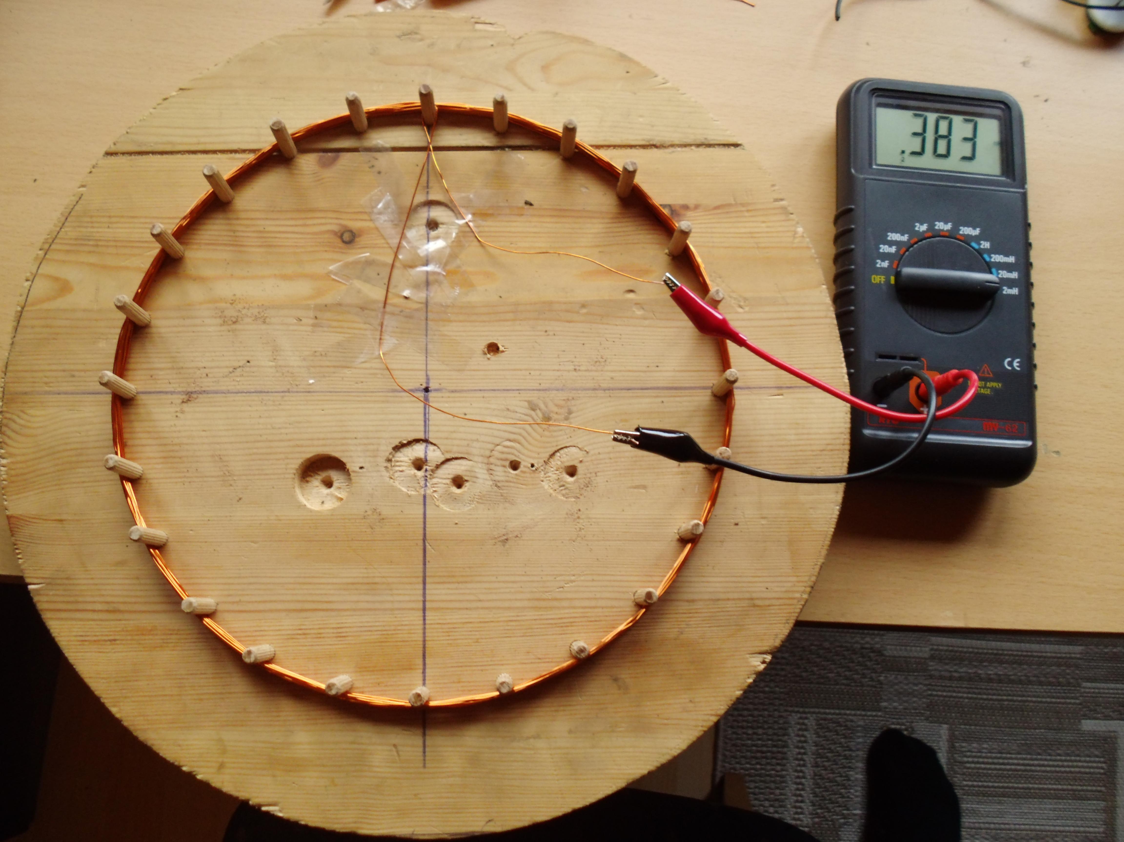

          I tried my 380uH coil with my russian pirat and got the same result as with my barracuda legend. About 25cm with a Euro.
          Unfortunately i can not detect a very thin goldring anymore. I could with my 15cm coil and i had almost the same depht with a euro.
          I will change the resistors.

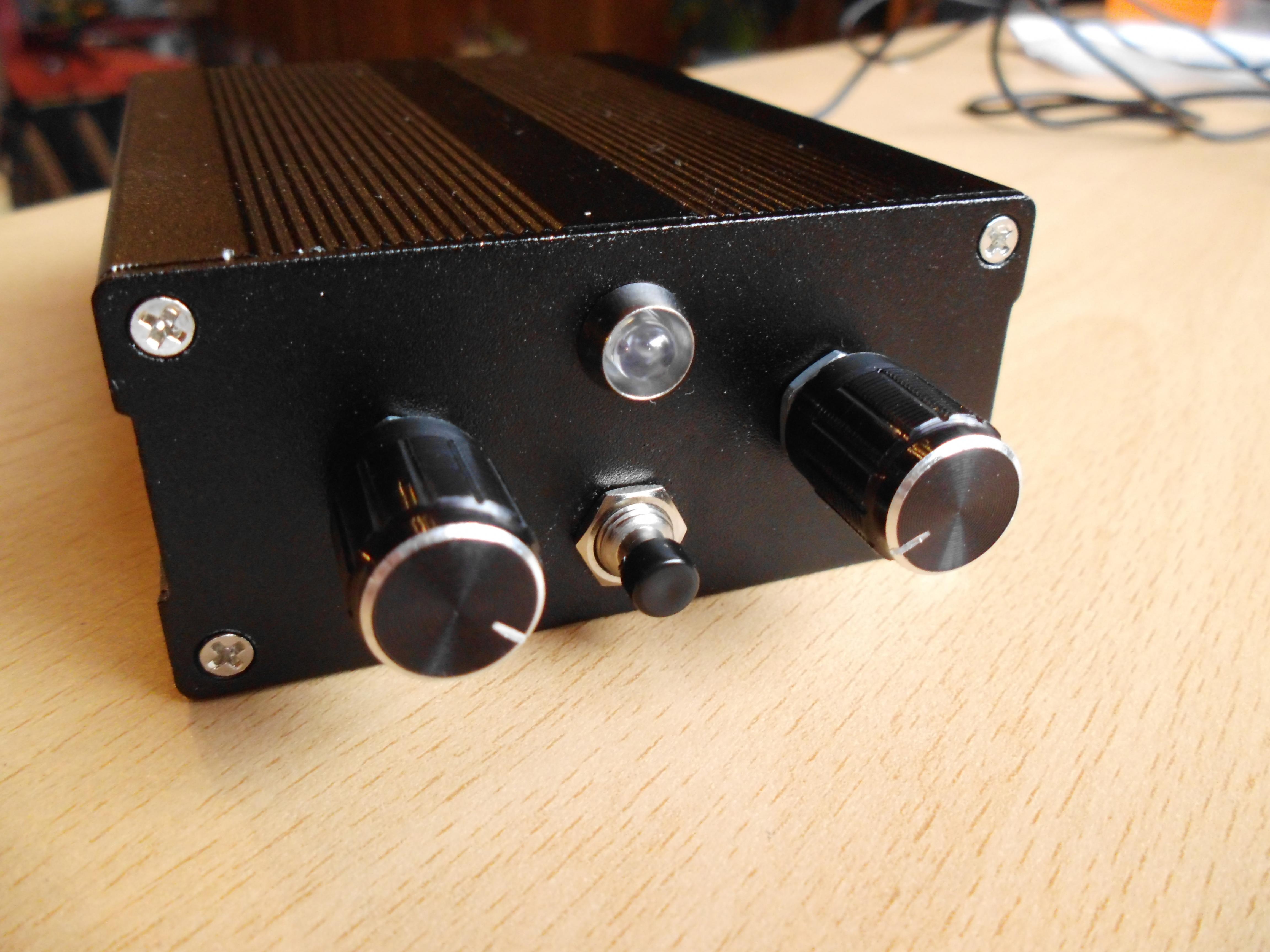

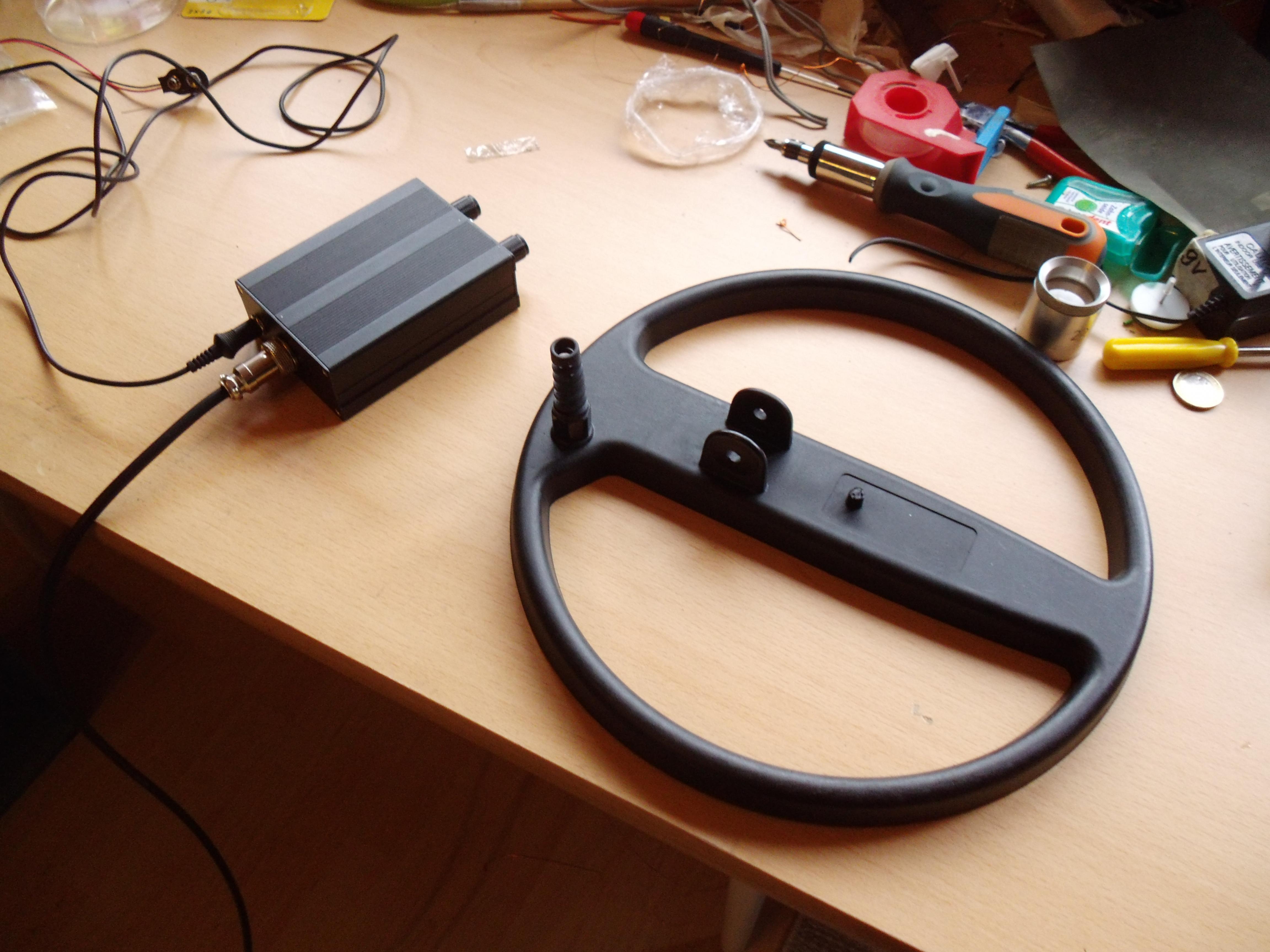

                I made the changes and i have more Sensititvity and more Depht. Changed from 25cm to 32cm for a Euro. I can detect a small Gold Ring now. I couldnt before.
                The Detector is still not tuned properly. I still ned to adjust the Damping Resistor.

                  Well done. This shows that the mods are easy to do on KT315's board, and that they improve the performance.
