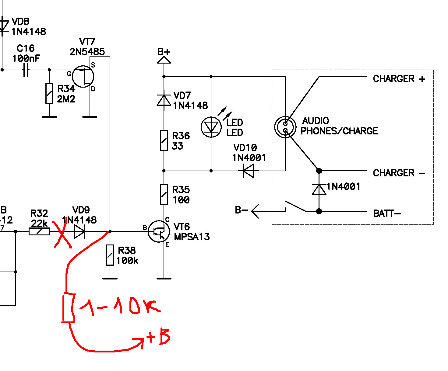

      • I have taken BF247, + 5V and -5V are present, clean curve on the NE5534, you can also see the change on the scope when metal is near the coil, but I get no sound .....
        I'll take some pictures soon, but if I do not find the mistake soon, I give up
        Igot really big pissed off
        • i give a check way diagram 1000th time. you HAVE to hear sound.

                    • Andi , did you try the tip from kt315? 10k Pot.
                      • Why does he need to disconnect the VD9 Diode?
                        • he must check only sound part, isolated from left part. listen him - but I get no sound .....
                          • I tried # 109 - still no sound.
                            And I will not let go of the feeling, something is wrong with the design
                            • I changed VD10, now a sound is heard.
                              Treshholdpot does not respond
