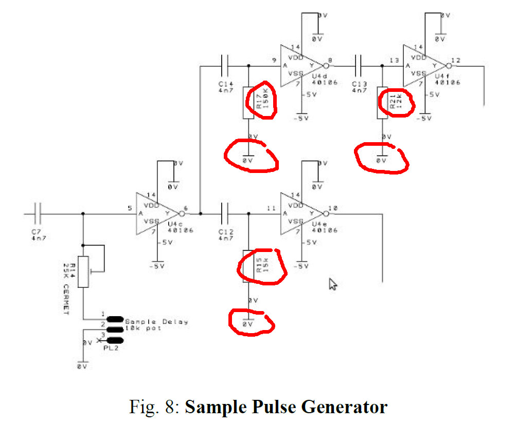

                          • 40106 burnt. reconnect resitors on GND (+E for 40106) - look this pic. change values of them - look the pic.
                            then change 40106.
                            • Kt i changed direction of 2N2222 and now i can zero the voltage on pin6 of 5534. I will change 40106 now.
                              • changed 40106 and it is giving continuous low volume ugly beep
