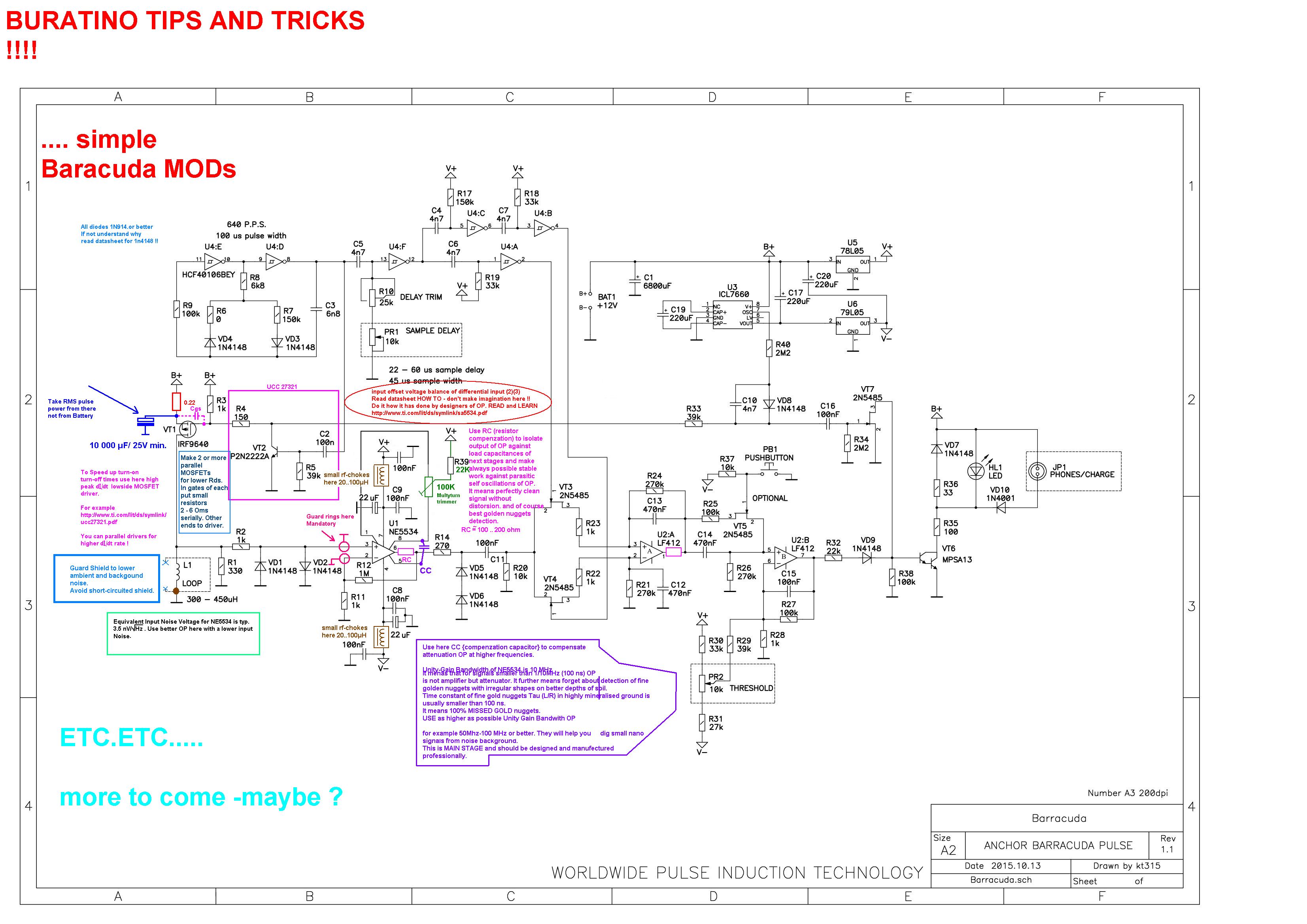

      After changing 40106 i test with metal and coil is giving very very very very small reaction to my mobile phone. It is also giving very small reaction if i change shape of the coil. The tone is low and ugly. My coil is not the precise size but only for testing.
      delete resistor and try get reaction on metal
      • did i write resistorS? delete 10k that was for checking of sound.
        • after i remove the 10K resistor it is completely silent

              Kt i changed direction of 2N2222 and now i can zero the voltage on pin6 of 5534. I will change 40106 now.
              Chubaba if you have constant 0.48v on 5534 and you buy the parts online/unknown store source 5534 from two more places and try to replace. For the rest i cant help as i'm still not started mine, but the offset issue is similar whenever 5534 is concerned.
              • offset is tune easely. tune o-scope on flat part of signal, afar of 'cutted delta pulse' part, and tune zero.
                do not use tester.
                DO NOT USE TESTER AGAIN TO TUNE OFFSET. you guys must know that that is impulse signal, not clear sinus or DC, and you can not use tester in this case.
                • Today it is mostly beeping on its own in lowish tone (i think it is picking its own waves). Detecting a euro size coin at distance of 4 inches but it is not detecting gold at all. I put gold ring on surface of coil but no response. Also it is completely silent if switch 1 is ON.
                    • oscope probe to which pin ?
                      • 6 pin
                        • but it is not detecting gold at all
                          read text in violet polygone
                          • You are a master of metal detectors. I wish i joined the hobby ten years ago so i could benefit more from your knowledge.
