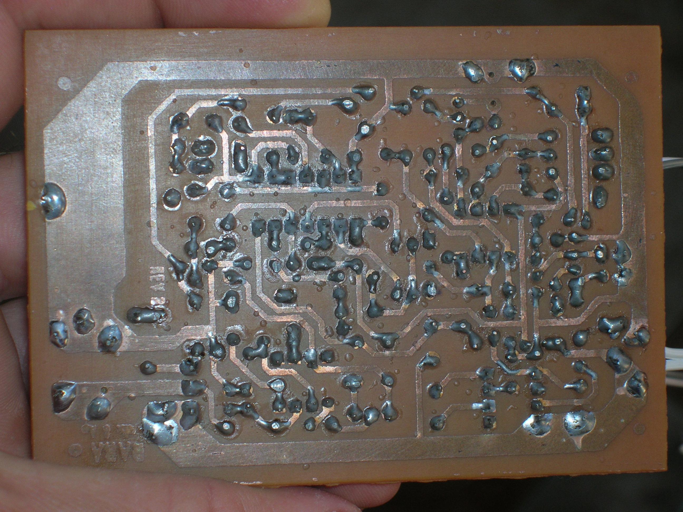

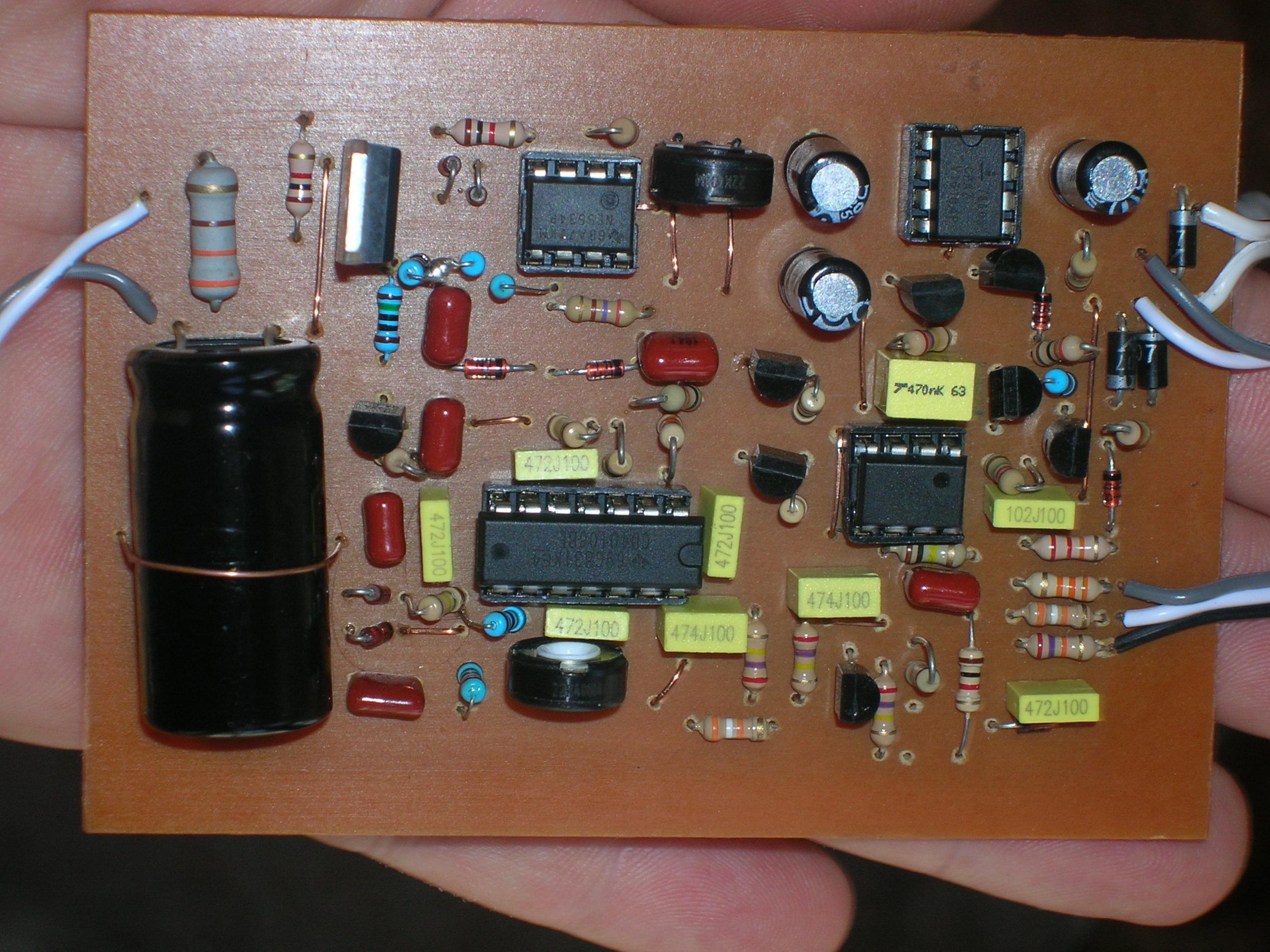

                      • Hello
                        I appreciate your help
                        When I saw that there was someone who said that I had done it and it worked ... I was encouraged to do it but I did not have that luck
                        Thanks in advance

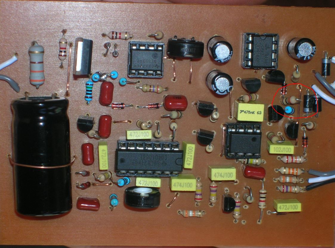

                        • top right next to 7660 it appears that the resistor is shorting to the link ? maybe just the camera angle though?Click image for larger version
                          • Thanks for your reply
                            No, it is not shorted, only in appearance

                                As explained in the Geotech Baracuda REV-A Build Document, one of the design issues is that the voltage converter IC lets out the magic smoke.
                                Also, note that the ICL7660S has a maximum input voltage of 12V.
