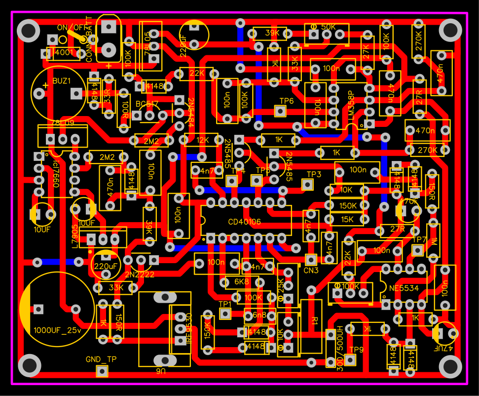

  • Hi Deghbar613,
    Sorry I saw your post late.
    If the pulse width and cycle length are stable, then what you show on the oscillograms is very similar to a malfunction in the input circuit (partial discharge).
    Check for problems with the damping resistor and the serial resistor and the health of the clamp diodes.
    If they are OK, it is most likely a shortening of the cable or between some turns of the coil.
    Try a different coil and cable.​
    PS:Also check the space between the incoming rails, mostly around the high-voltage rail (MOSFET drain).

          Hi boilcoil thx for reply
          i change coil but its the same problem
          i am beginner but i think the problem is from the mosfet is fake. i don't have other one to change it

                              • Who can help
                                this is my pcb it's baracuda geotech rev A​
ID:	437762 my problem is my flyback voltage not stabe as in video
