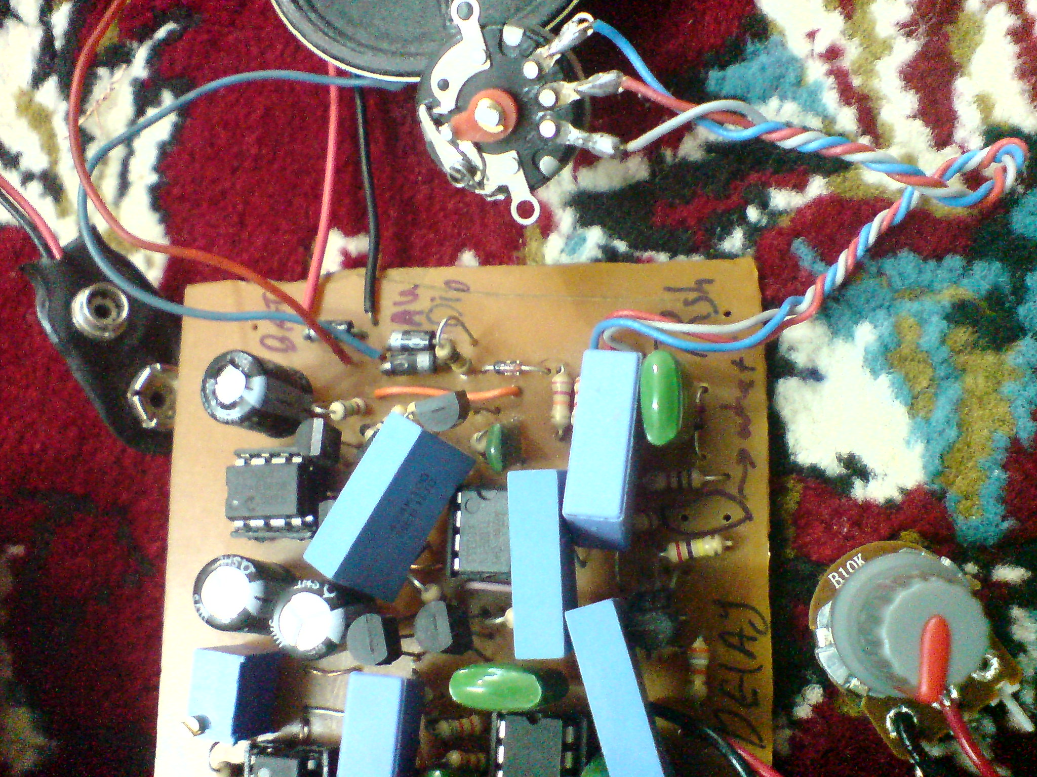

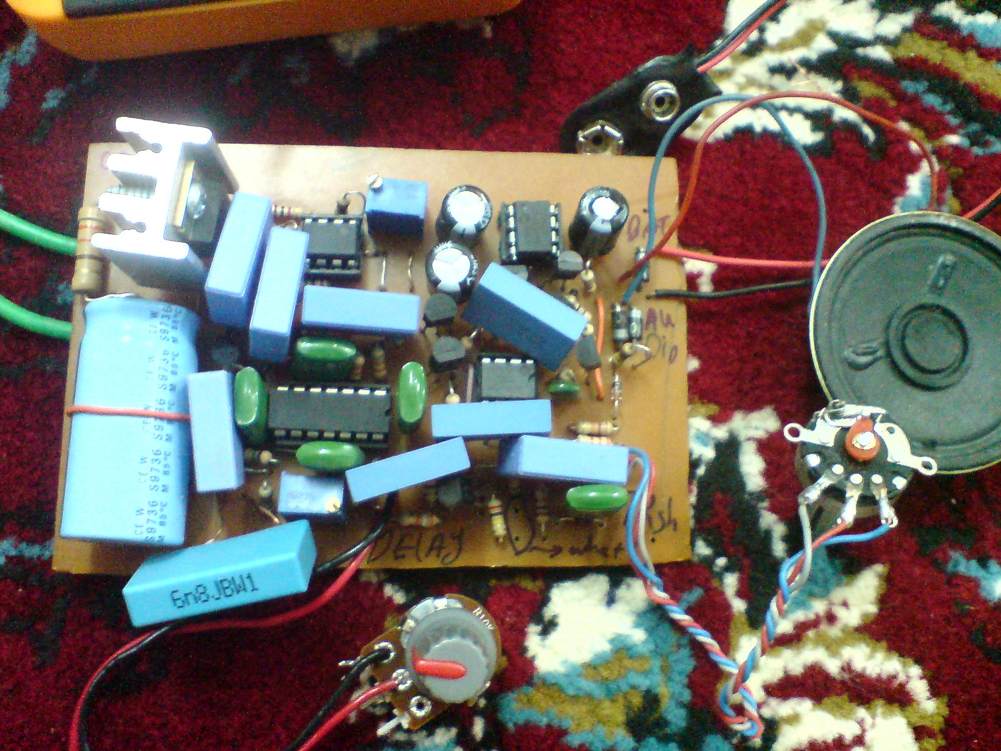

    • no body help me?
      i make it and finish,but i think my wiring maybe have errors.
      please help me
      thanks

      • mohandes,
        you are having problems, to be honest your circuit is a mess - caps are too big for board, component legs are too long we cannot see the other side of the board. There could be lots of short circuits. I would recommend you buy a kit from Silverdog and start again if you want to build this detector.
        • hello mohandes
          threshold pot is totally wrong connected
          blue cable first pin of pot is the lowest holes on pcb
          red is middle hole
          white upper hole
          • Originally posted by tonyh View Post
            mohandes,
            yes
            you say right,i check all by multi meter and are is ok(no short circuit)
            mr wilson say should remove Delay and set bridge instead it, and in pics that i send i certain two hole and write near it what?,thease holes for switch or bridge?

                  • Hi antonioknight,
                    the main problem is your battery: the 9V battery (6A22?) or accumulator is small for the Bara.
                    The 9V battery long-time current is cca. 30mA.
                    please use two 4,5V battery (or refillable accus), for example_ http://olcsoakkumulator.hu/pictures/products/397.jpg
                    or better than working from 12v/3Ah accu.
                    brg
                    Rumcajs
                    • Hi mohandes,
                      the capacitors look like big dimensions for this circuit. The second problem is battery: the 9V battery (6A22?) or accumulator is small for the Bara.
                      The 9V battery long-time current is cca. 30mA. The battery ,,power'' must be at least 100mA or higher, ok?
                      please use two 4,5V battery (or refillable accus), for example batt.: http://olcsoakkumulator.hu/pictures/products/397.jpg
