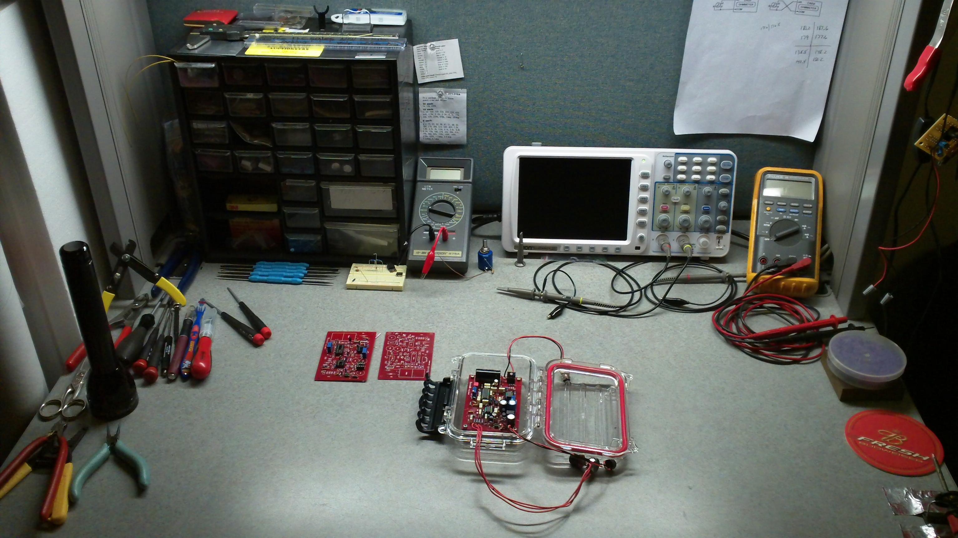

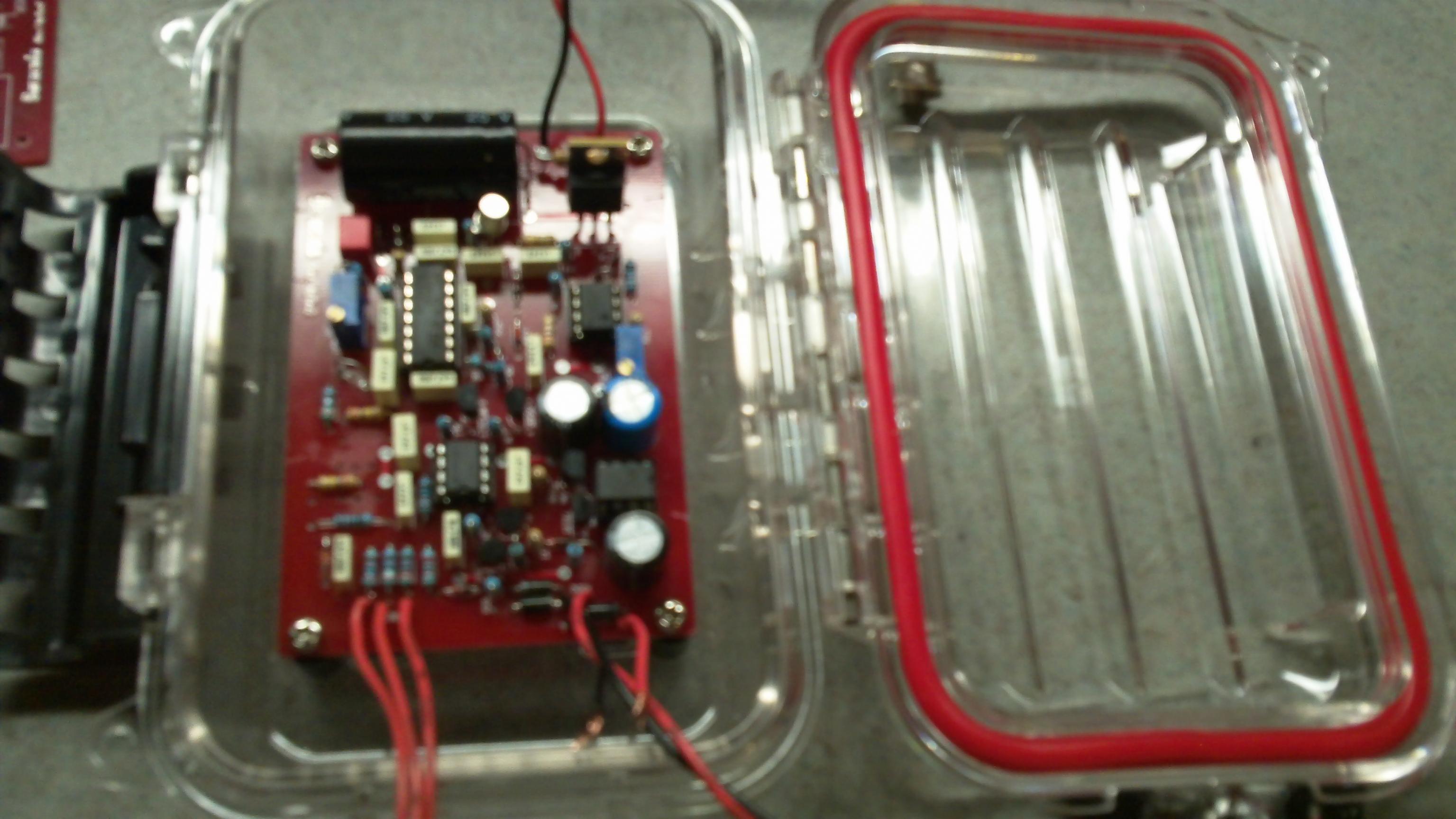

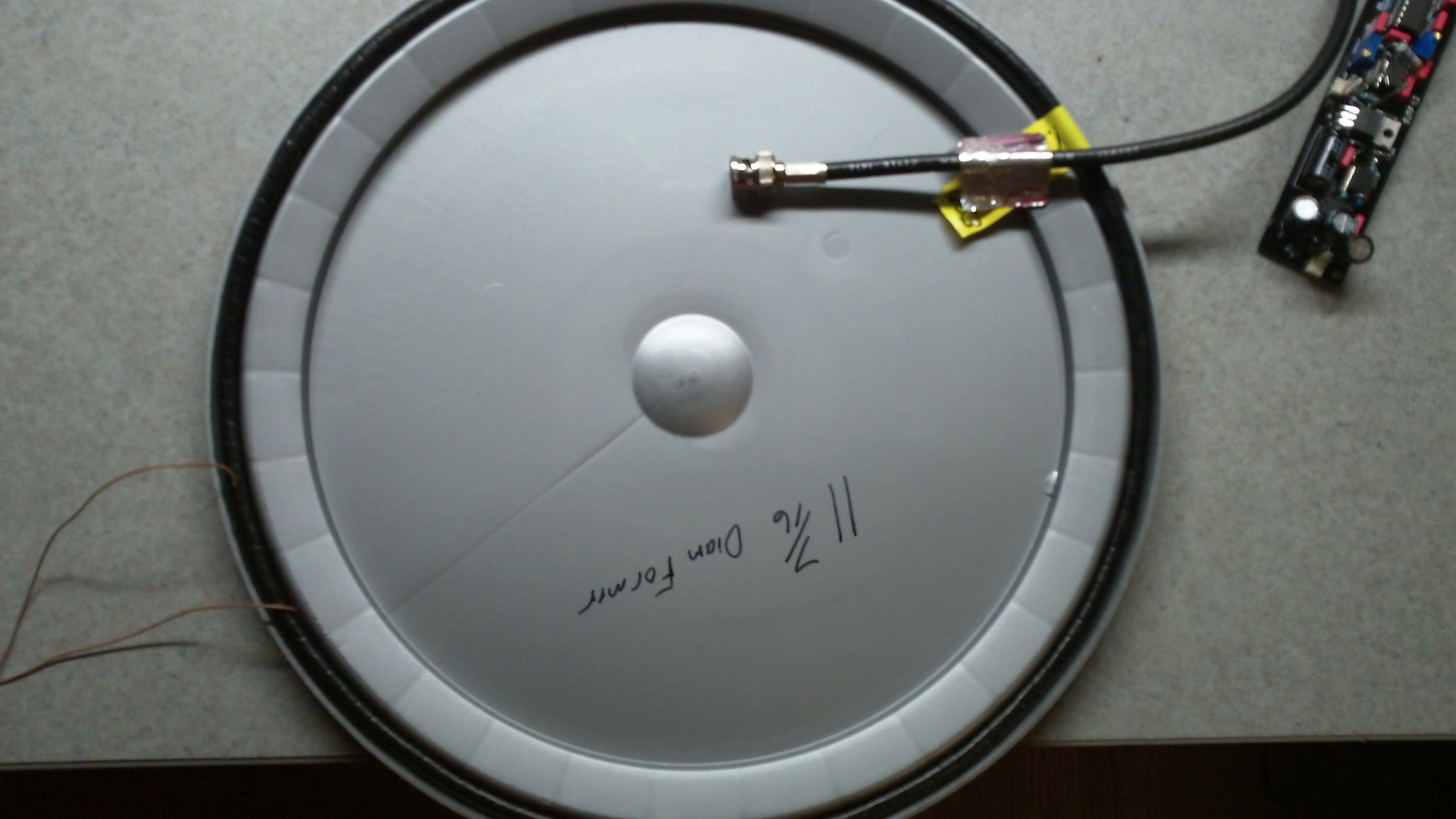

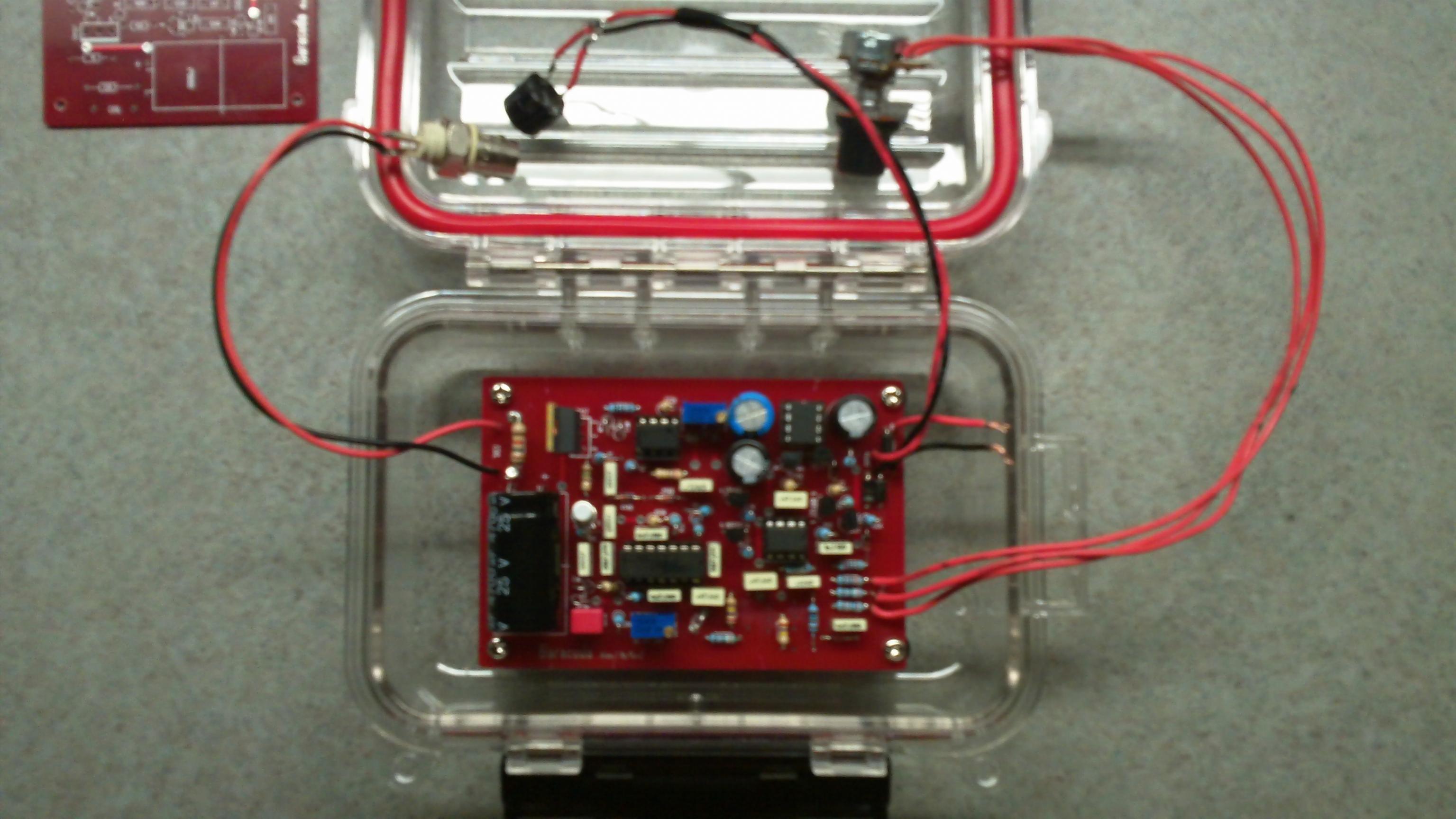

        • Here is some pics of my madness.
