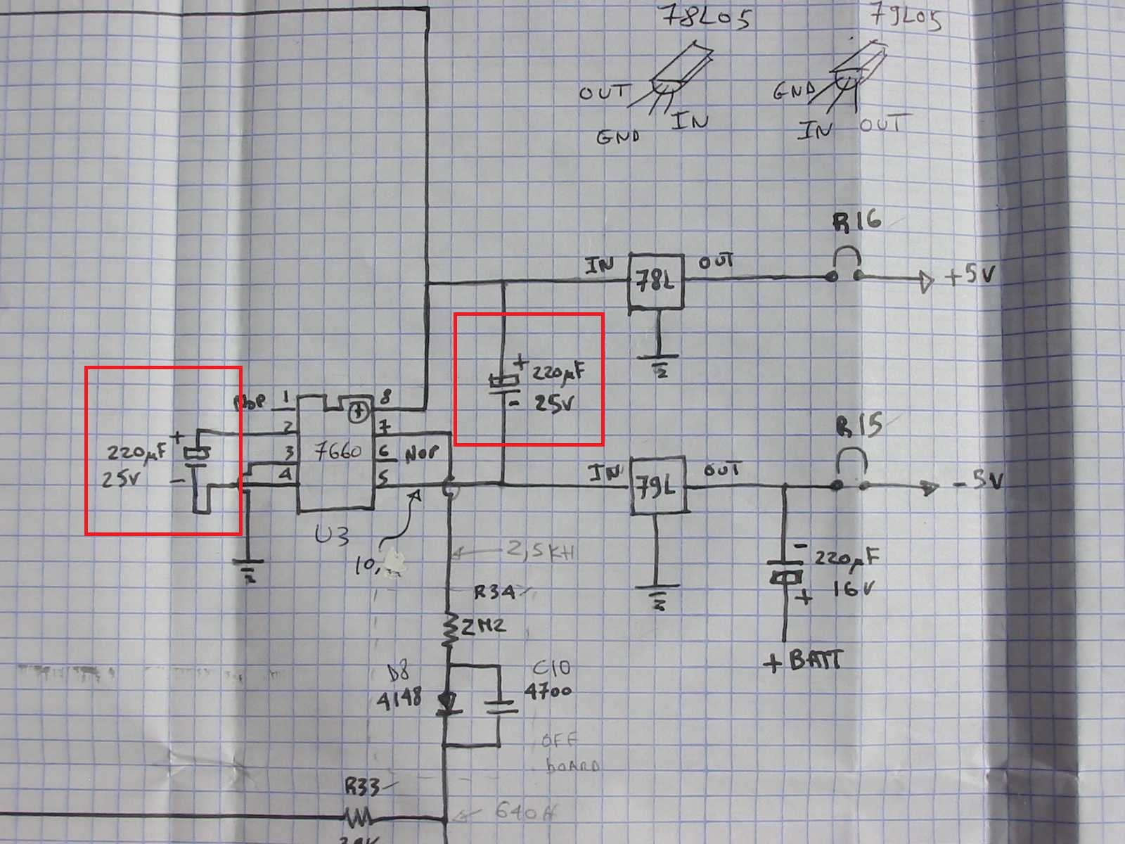

  • Hi Bernd,
    there is no need to cut anything on board, just remove both regulators (78L05 and 79L05) and measure voltage between pin 5 of 7660 and GND. You should measure some 8.5 V to 10 V, if no than the most likely 7660 will be the problem, but first make sure that both electrolytics (marked on picture) are 25 V.
    And finaly inspect diode D8.
    If problem after all those remain trace line from pin 7 of 7660 and inspect everything on that line.
    Regards Marko.

        • hello
          thanks for help
          but i am still not at the end
          i removed 78L05 and 79L05 and measure voltage between pin 5 of 7660 and GND. i measured 9,5V and both electrolytics (marked on picture) are 25 V.
          diode D8 was ok too.
          then i placed 78L05 and 79L05 (new one) back to pcb but when i turn on 78l05 still gets hot
          seems that it is overcharged - think i will check all what what is in line with "in" pin of 78l05
          any other info for voltage of ic´s that i can measure or some test points
          or has anyone interest to buy that board 20€ plus shipping within europe
          external pots for thres and delay and internal for offset
            Perhaps there's a short on the output of the 78L05.
            Try connecting the 78L05 using only the I/P and GND pins, and then measure the voltage on the O/P pin (i.e. with no load).

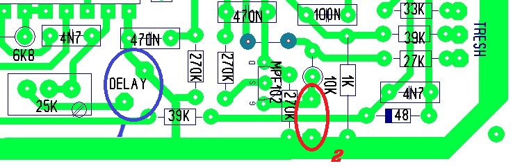

            • Hello ap consultation, in the photo list two points sorry if my question is what intrigues me ovbia but marked with blue # 1. Because the PCB assembly is a jump and the prototype.No
              and number 2 that is going on those two points?
              • Originally posted by Tekeweke View Post
                The link (1 ) can be replaced by a extern pot to make a extern delay.
                The switch ( 2 ) is not used.... see the start from the Baracuda post , it is not very clear what the function is...
                • ok thank Ap.
                  • Well we need to find out what what switch 2 was for dont we, its not good enough
                    • Pinpointing - puts it into non motion mode. See similar mods made to surf pi in the surf pi thread.

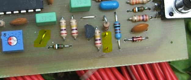

                      • I finish my barracuda, but I feed him the TIP127 burn as an iron warmed anyone knows why this happened because the layout of the PCB is correct
                        • hello
                          if tip 127 gets hot test following
                          r of coil not under 2R
                          L of coil not undr 400micro Henry
                          damping resistor not lower specs as in shematic (maybe your one hs to high tolerance 320r instead of 330 for example)
                          i had in mind that the switch was for fine adjust (offset?)
                          i wasn´t able to see a pinpoint mode when i had switch installed
                          • hello, my damping resistor is 330R and my coil has a 3R or so.
                            Now this function but with 7.53 volts and detects only large pieces of about 20cm or 8 inches in the air.
                            if I raise the voltage to 12V battery. TIP my 127 overheats to the point of almost melting.
                            I use this circuit for a 2N2222 and four MPF102. and a MPSA14
