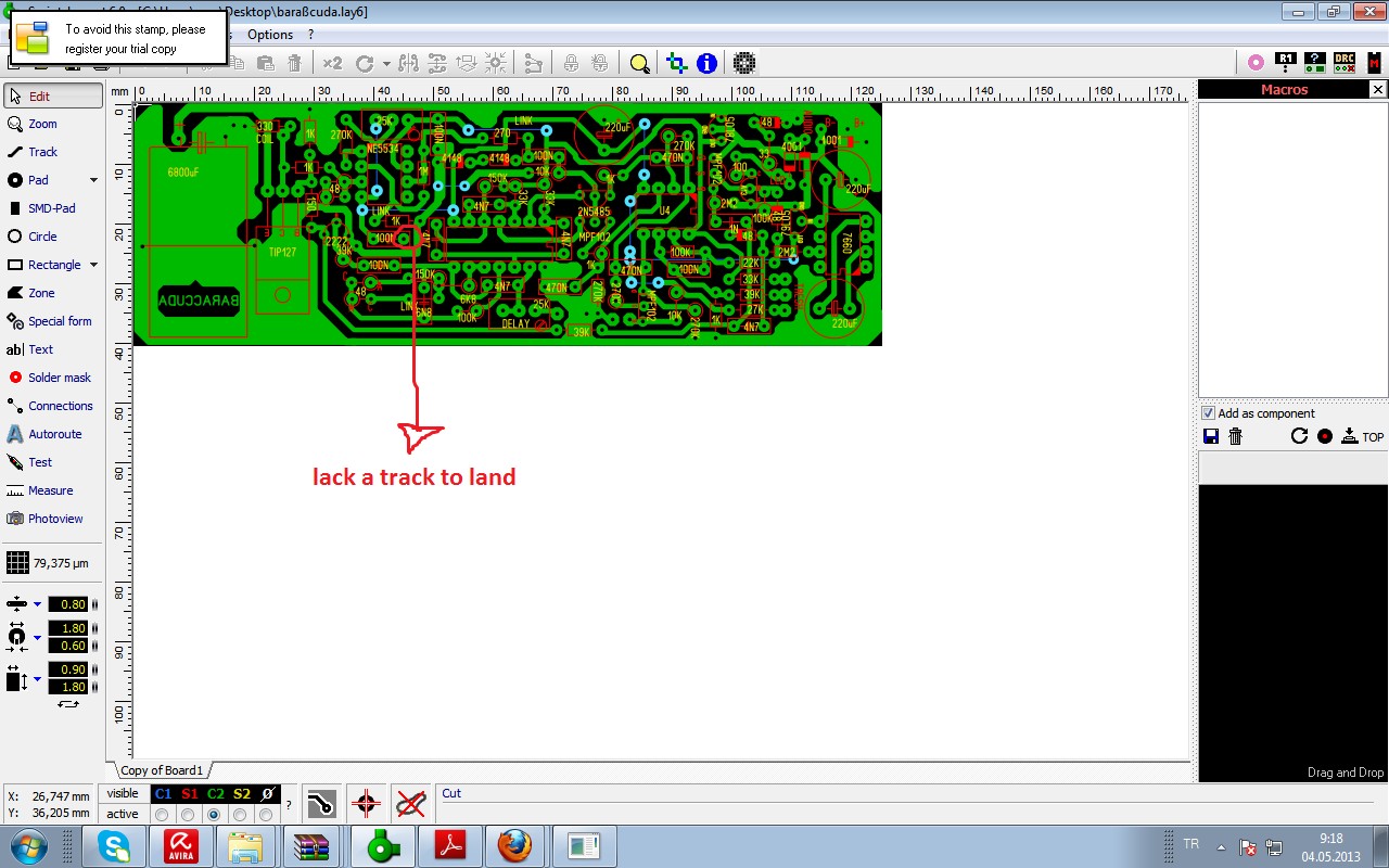

              • Originally posted by samii View Post
                Hello
                I attached pcb in pdf format and screen capture image of new baracuda on the post 704
                Best Wishes
                sami
                This is not a printed circuit board with a post 704 .... Who will do it, add power to pin 8 of 7660. I have everything downloaded and works well with 704 posts
                • sorry for mistake
                  I attached 704 again This is true files
                  • Barr bmp is wrong ,zoom and PCB is correct. pin 8 of 7660 need to connect + voltage like zoom
                      Just rename the extension from lay6 to lay and it opens fine in a viewer
                      @Davor it seems that the problem is with me... i have an old program "layout 5"...
                      @samii thank you
                        • Thank you! Indeed mistake. Who wants correct.

                            • BARACUDA
                              sorry for poor english, please help me, barracuda about pi, does not work and after 5 seconds the heat ic 7660 ACPAZ ?
