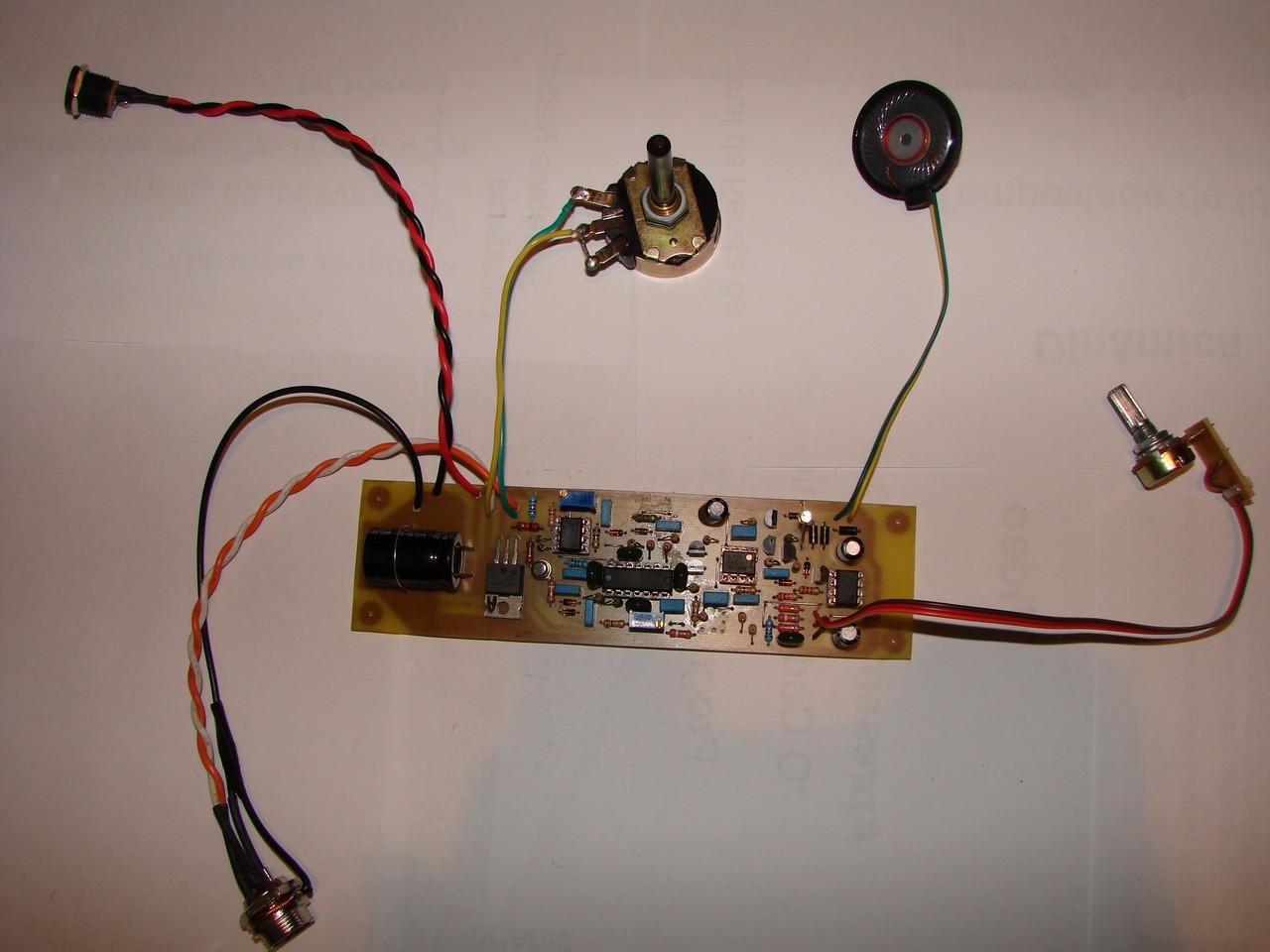

  • It was developed by our friend ApBerg, and Alexismex. I played around a little Tetris.

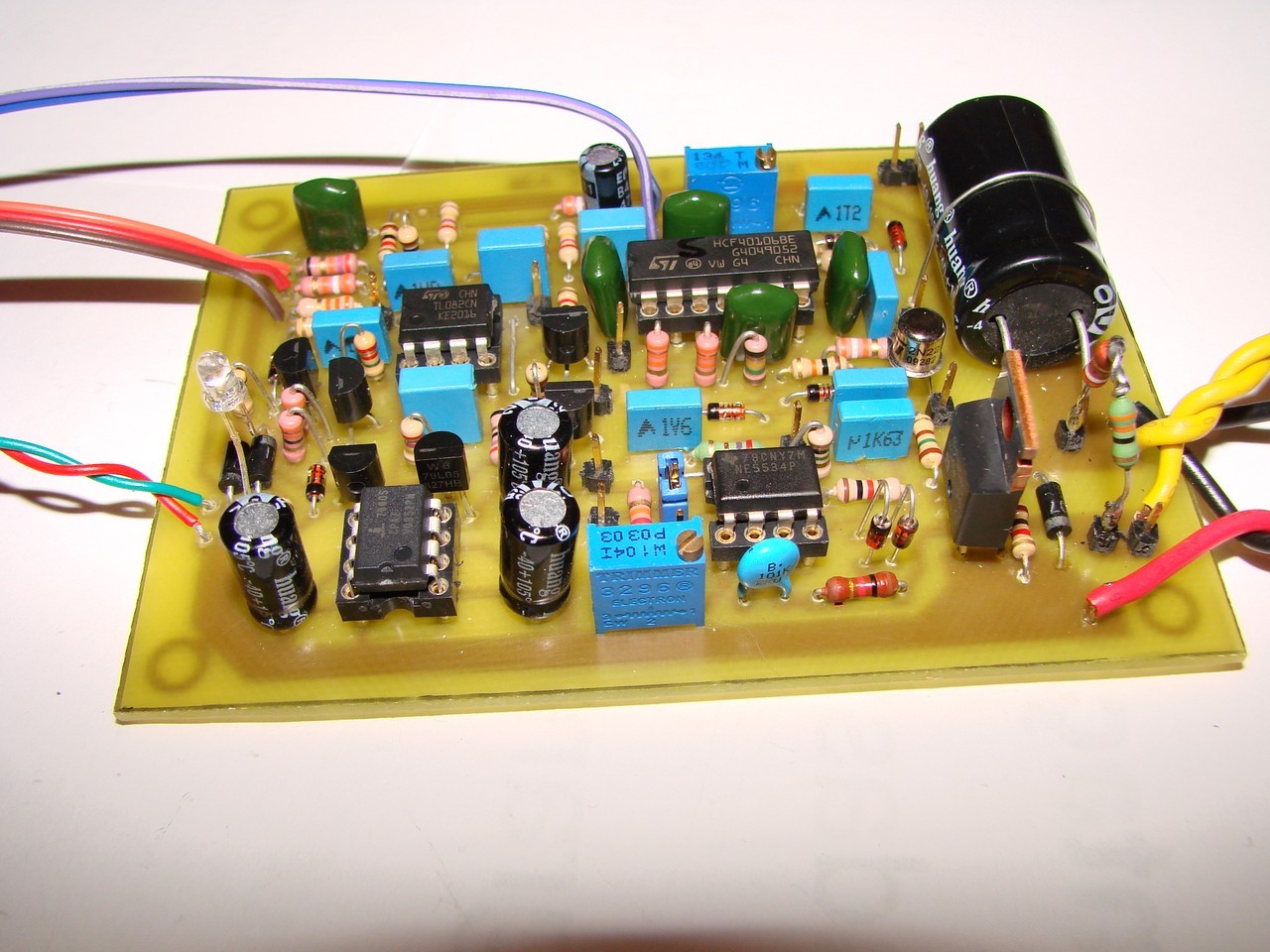

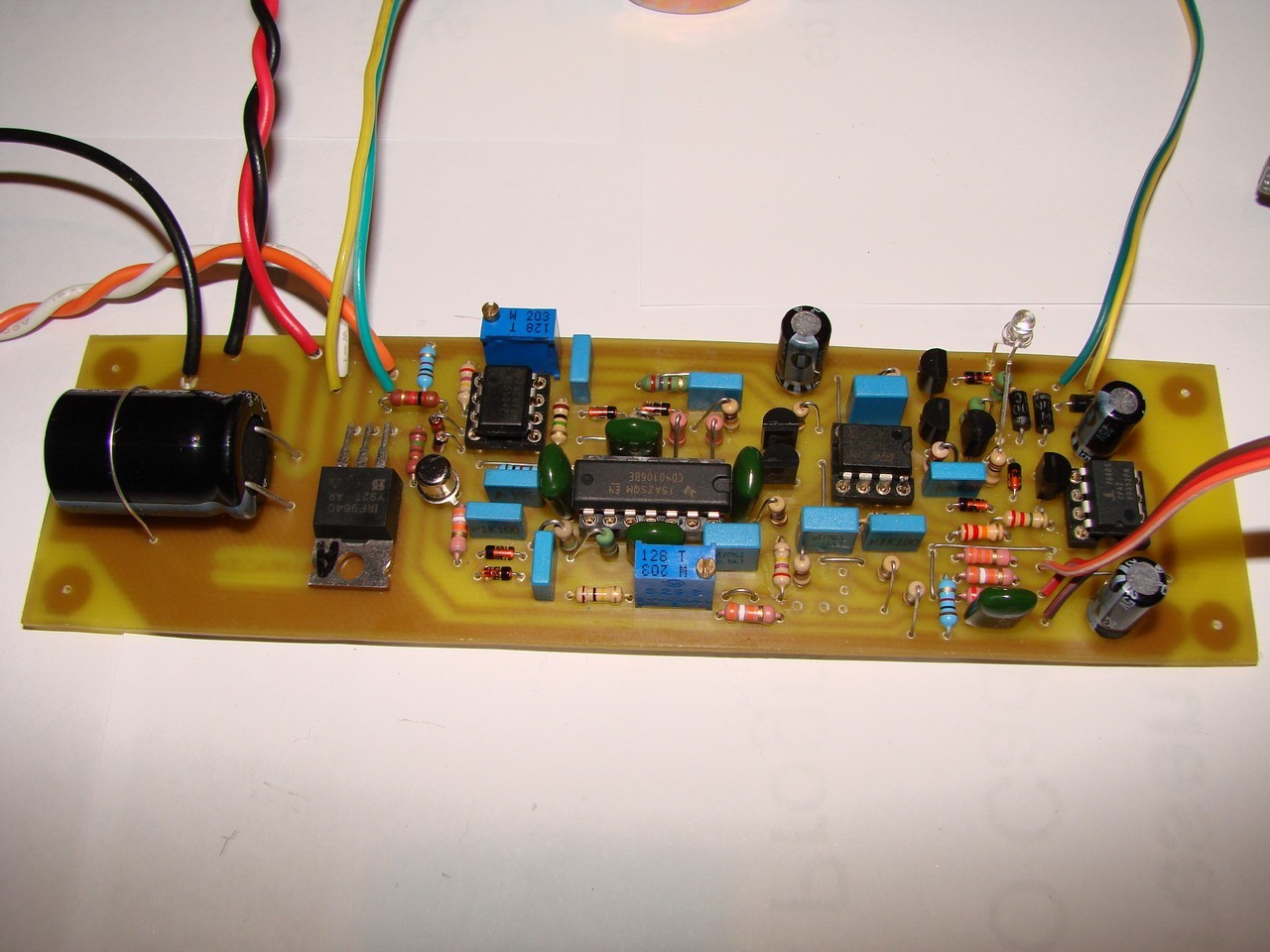

    • Smity Ok sorry, I did not know it had been created pcblongboard by ApBerg and Alexismex but thank you all the same.
      I made some changes, I'm using BF245C, transistor BC517 audio, all must be fitted with a rotation of 180 degrees because the pinout is different.
      Hug for everyone.

        • Wilson, congratulations to you. You are probably the first who made ​​a long circuit board. To the question for you. How does it work? Does not make noise? Now in its tube (diameter 50 mm)., Sealed and under the water!
ID:	336182Thank smity, remember to thank those who have started the project longboard I just did some modifications.
            As proof of the extruded water should be studied very well, should probably be used a tube of transparent acrylic wall 4 to 5mm, the circuit contains an LED purple high gloss that can help in the hunt, but also has the output audio should be studied a means of installing the conectores or use special plugs and headphones.
            I apologize for my English, I'm using a translator ok.
            Hug.

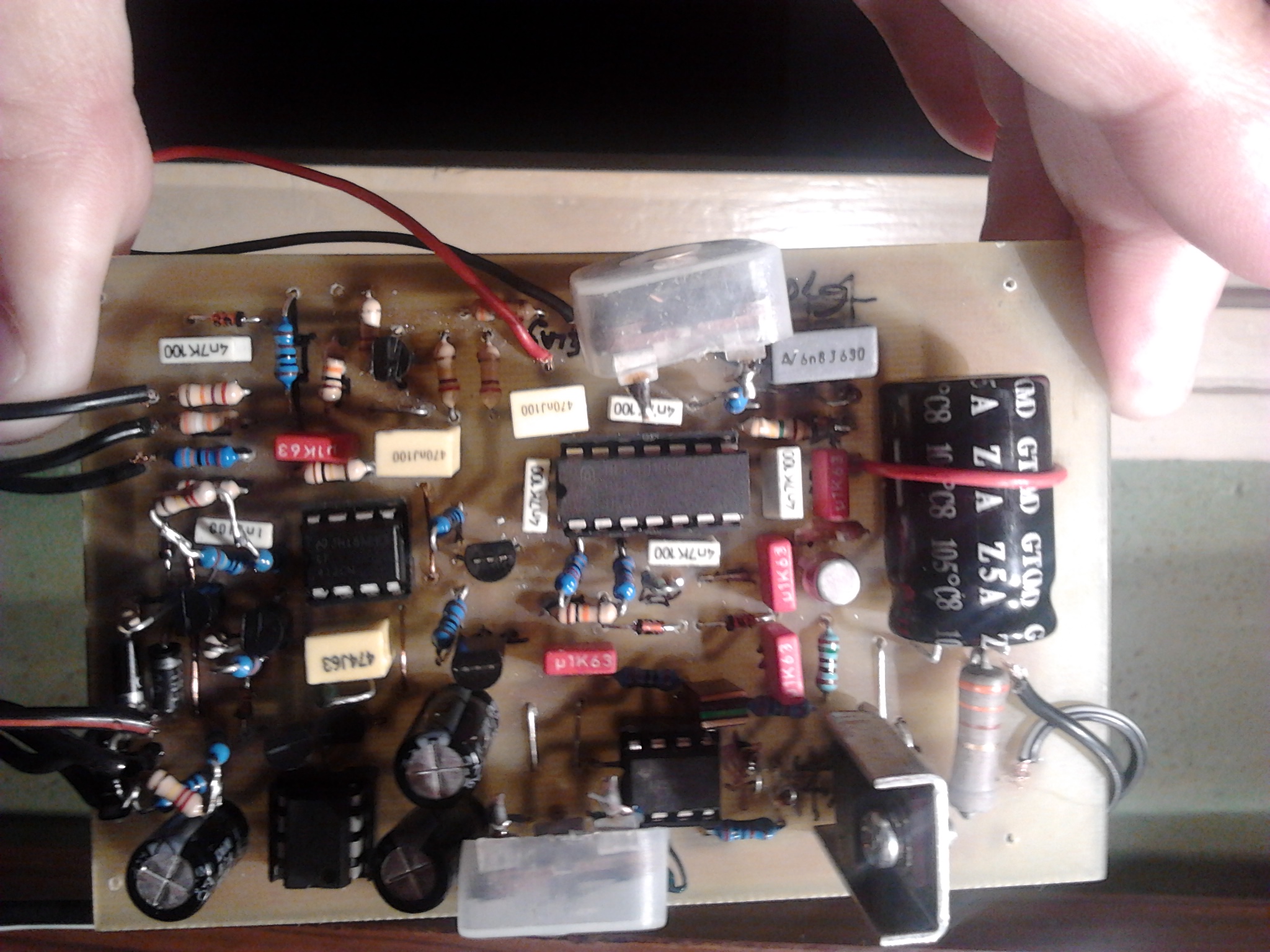

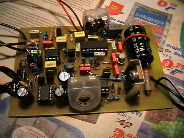

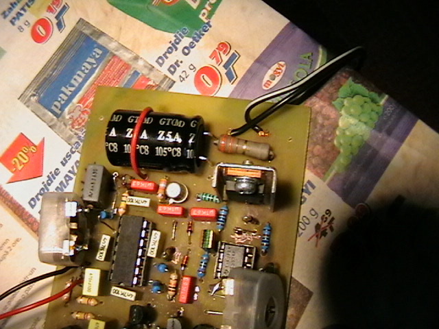

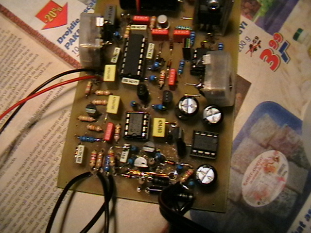

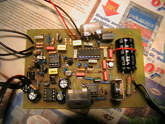

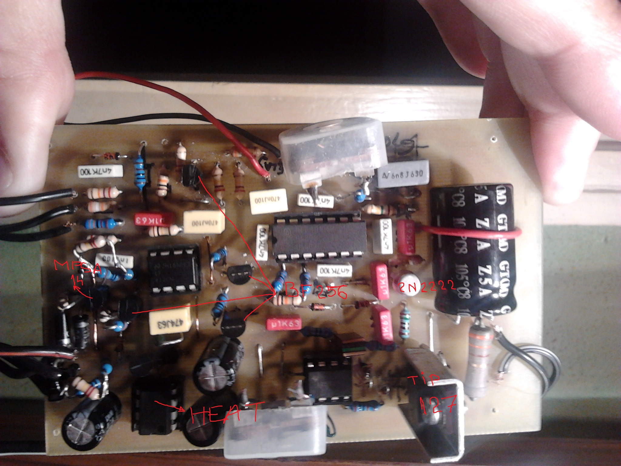

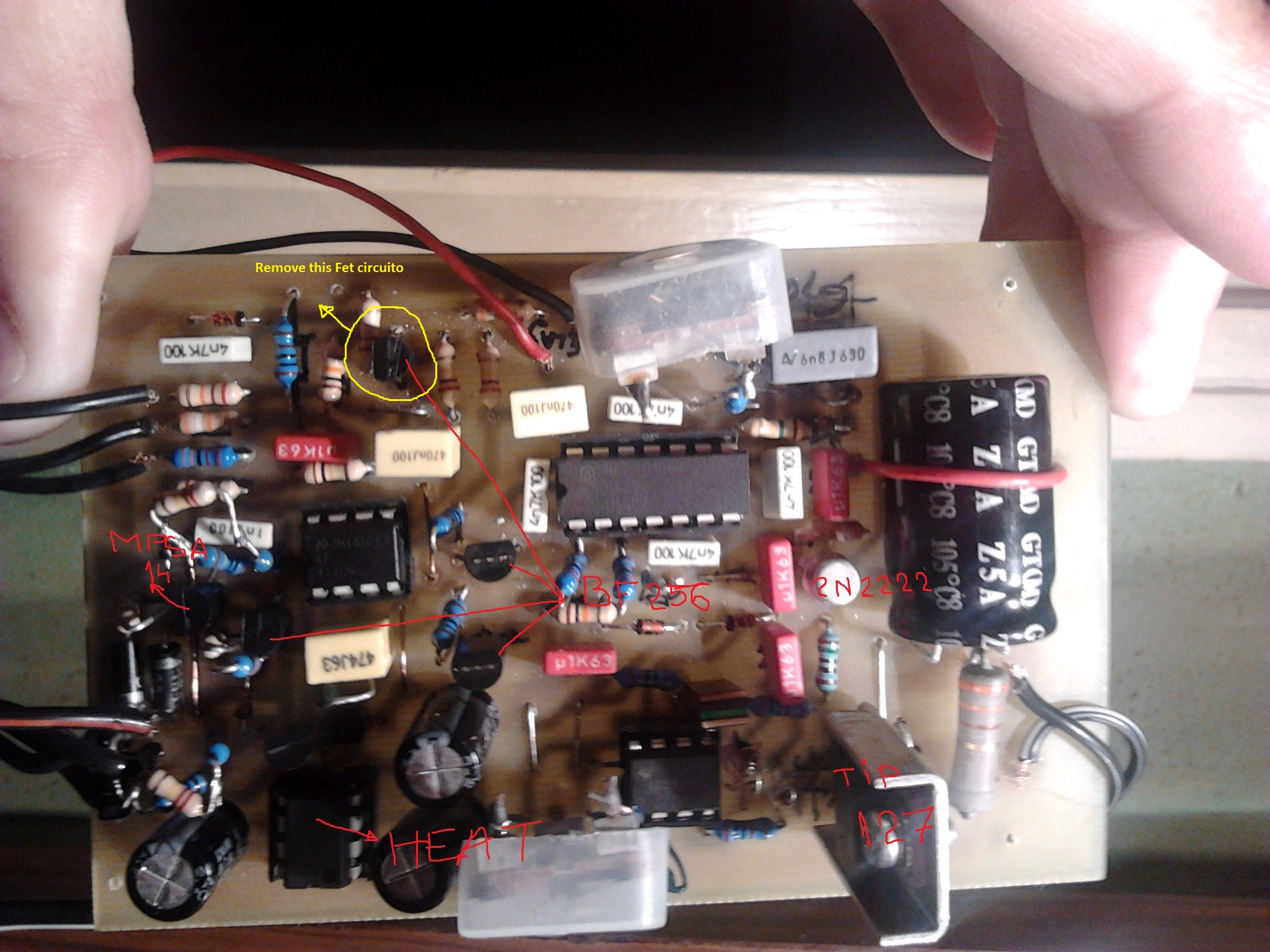

            • sorry for poor english, please help me, barracuda about pi, does not work and after 5 seconds the heat ic 7660 ACPAZ ?Click image for larger version

ID:	336183,not function....all new electronic parts and I know electronics....

                • Do a picture just like that but of the underside, so we can see the tracks.
                  Pics of the underside probably tell us more than the top, there's nothing amiss in the project, it's more than likely something simple.
                  • Hello Nokia, I'll try to help you, check the welds and possible short between tracks and pad, do a clean side of the welds on the pcb to check better. If all is well remove the ci LF412 and NE5534 and check the voltage +5 and -5.
                    The ci 7660 should be the model that supports 13volts (ICL7660SCPAZ). Maximum voltage for the circuit PI Barracuda is 12volts.
                    • Nokia, remove this Fet circuit. Do not install the fet again. Click image for larger version

                        • I tested before fitting parts pcb magnifying glass and the meter is good, I tested after I installed all the parts out of ic is ok, we test at the end and it is ok, I've removed and replaced the FET socket and integrated all ..I think he's right ..... i dont like people who say detectors are useless under £ 250 thats a lie
                          as is any radio under £ 400 is not worth Also the operating
                          • You already removed the FET Q5 and turned on the circuit? Most mounts barracuda does not work well with fet Q5 installed, do a test.
                            The tension-5volts this correct?

                              • chek pins of 2n2222
