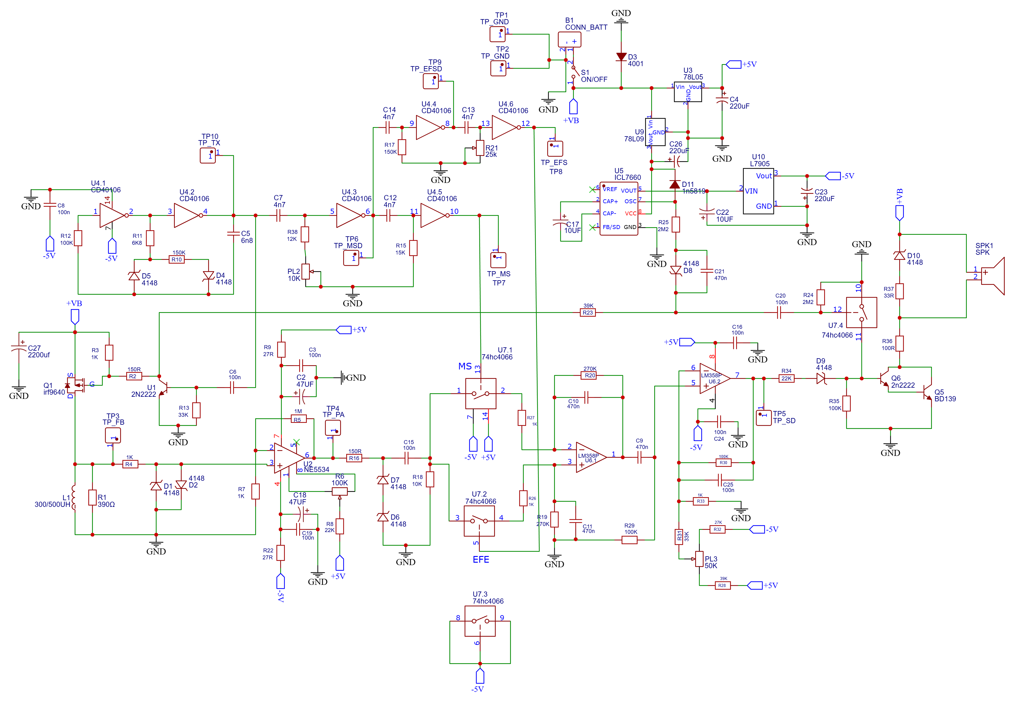

      The preamp output looks good, the sampling pulses look good assuming the pulse widths are matched. That's what R21 is for, to trim the EFE pulse width to match the main sample width. You should adjust this while waving the ceramic magnet until EFE is canceled.
      If you cannot get an EFE null by adjusting R21, then here is something else to try: remove C13 and short U4-pin13 to U4-pin11. This will cause both sampling switches to sample at exactly the same time with exactly the same width, and should cause any target -- even a large piece of metal -- to have a very minimal response, or none at all. If you are getting a good response then either U8 is faulty of there is a problem with the components around U6. If you do get a minimal response then R21 is not correctly adjusted or it is not EFE.
      i did what you told me and the result is i get a minimal response the coin before i catch it at 30cm on the air but now is 12cm and no response on ceramic magnet other thing main sample and EFE is 11.8us

        The schematic in post 1661 has U8 at the bottom, CD4066.
        • Originally posted by Deghbar613 View Post
          It sounds like things are working as they should. Originally, did you try adjusting R21 to cancel EFE?
            yes you have right
            it's my fault i changed it for that i didnt find it in new one

            what do you think about my test result ?
              I would have expected a little less target depth but it sounds like the circuit is working.

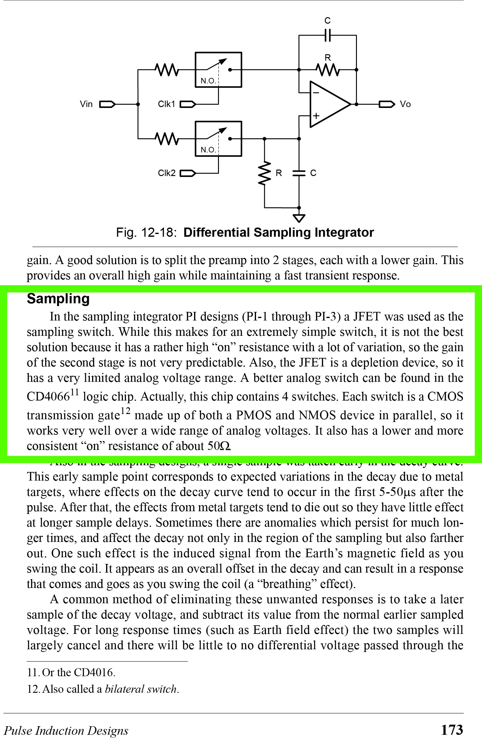

                    my cause of changing FETs is what Carl write in his book (Inside the Metal Detector)
                    he said

                    • Hello Deghbar613,
                      check the data sheet of the CD4066. The control voltage has a big range but it is always positive. The control voltage from the CD40106 how it is connected in the circuit is negative.

                        you are right
                        so i forget to use 4066 or there is other way to use it
                        • Hi Deghbar613,
                          If you want to use a CD4066, you'll also have to change the timing circuit. This can have further effects on the entire circuit. It's really not worth it. I would use the original FETs, as we know they work perfectly. If you want to improve the circuit, I would use a good coil. There's a guide for a fast coil in the Geotech forum. Take a look at it. That's probably a better way to improve the detector than replacing the switches.​
                            Hi Deghbar613,
