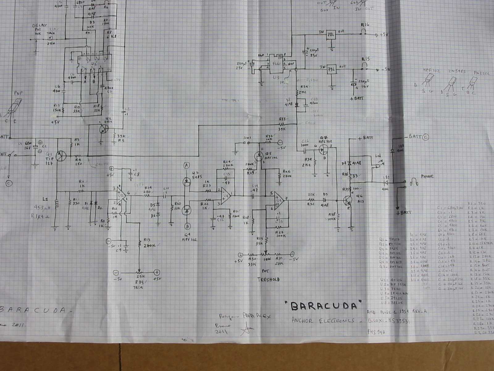

BARACUDA-Legend-1
  • We are using this cct by Alex 2011, for the silverdog BARACUDA-Legend-1 project, as listed in post number 4 of this thread
    see post 4 for all ccts. There are a few changes from the old REV D cct to make it work.
    http://www.geotech1.com/forums/attac...1&d=1296185337

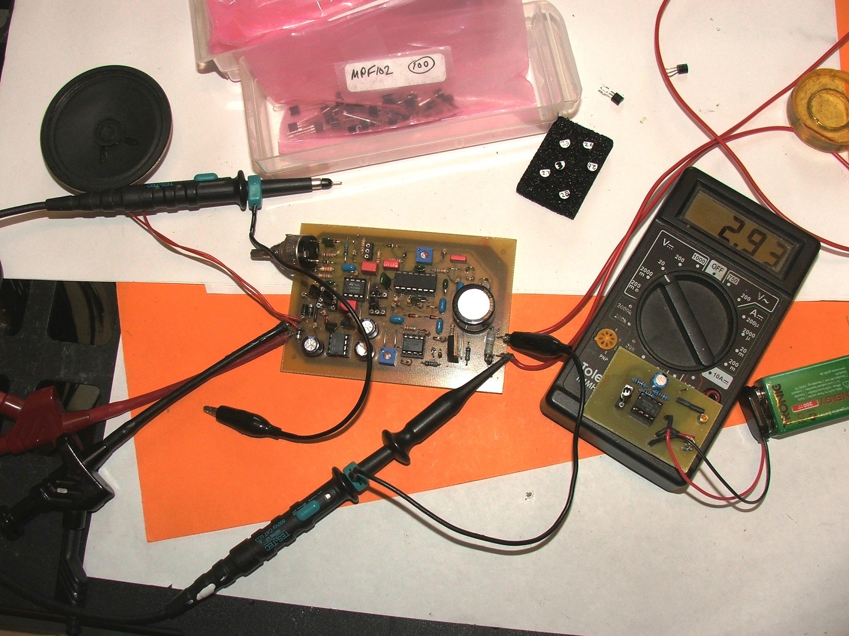

          • Hello Friends
            Made some test … checking fets.. marking them with Typex and a number on top.
            ( fist I used nail paint in a sort code.. little paint dots on top .. not good !)
            First conclusion :
            It is not important if you use the MPF102 or the 2N5485 both work..
            What is important that they are matched..
            If I insert fets that have a mismatch .. a MPF 102 that has a 3 volts switching point and a 2n5485 that has a switching point from 2 volts there is less sensitivity and a there is lot 50 Hz noise !?
            Best is 2 fets that have the same switching point , for example both 2 volts or both 3 volt.. this gave (indoors) the best results… no 50 Hz ?? and best sensitivity.
            Of course this is my opinion…
            The term switching point if perhaps not o.k...but it is a indication that can be used ?
            Best regards
            In short time I mail the litlle pcb that I used for the fet selection.. first have to sears on Internet where I found the info to make it..
            Ap

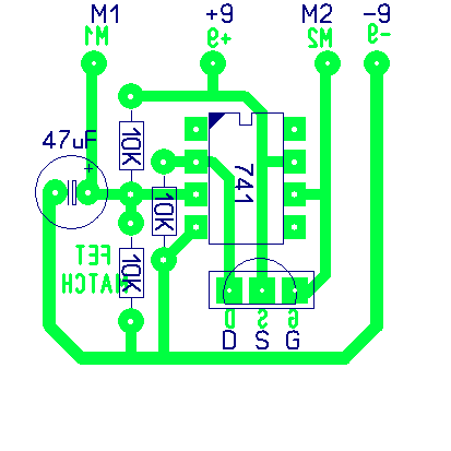

            • Hello Friends
              Found http://www.geofex.com/article_folder...h/fetmatch.htm this is the origin for the Fet tester I think..
              In the zip is the sprint layout file and also some info from a other electronic hobbyist that has done some fet-testing
              Best regards.
              Ap
              • Thanks Apberg for your information
                very interesting for us.
                • Hi Ap,
                  thanks for the Tip, works fine.

                    • Ap did you notice much difference in the sensitivity of your MD
                      when using matched and non matched fets ?
                      How many cm's ?
                        How many cm's ?
                        Hello,
                        Yes.. there is real improvement ! I think that between a bad and good selection, from those 2 fets, is more then 5 cm differents..(if not more) The sound from a good combination is much 'cleaner' no 50 Hz ?? ( can enybody explain?)
                        If the offset form the Ne5534 is zero and then looking at the output from the lm358 /1 (lf412) you see much differents in out put if selecting different fets .....
                        Best regards.
                        Ap
                        • Hi AP
                          wow 5cm, thanks, I better get out the soldering iron
                          on my bara I do not get any 50hz, but it is a little unstable for about 1-2 minutes
                          after switch on
                          but then settles down.
                          • Originally posted by ApBerg View Post
                            Hello,
                            Best regards.
                            Ap
                            I won't (or can't) get real technical here but U4A is a differential amplifier and...
                            When you select FETs for matched Vgs(OFF) you are also narrowing the difference between Rds(ON). That difference can be pretty significant and is effectively in series with the 1k input resistors and will affect the comparative gain between the U4A + and - channels.
                            CMR (common mode rejection) can suffer as a result and that can be why you see differing levels of AC mains hum at U4-1 with different FETs.
                            I really hadn't thought of that before you got the idea for matching pinchoff voltages. Good idea, Ap.
                            • I'm not getting this. What FETs are being changed to get the depth increase? Some sort on diagram would be helpful. My understanding of these components is limited but I'm great at looking at pictures...LOL
                              • We are talking about the 2 FET's that are used to gate the output of the NE5534 into the LF412.
