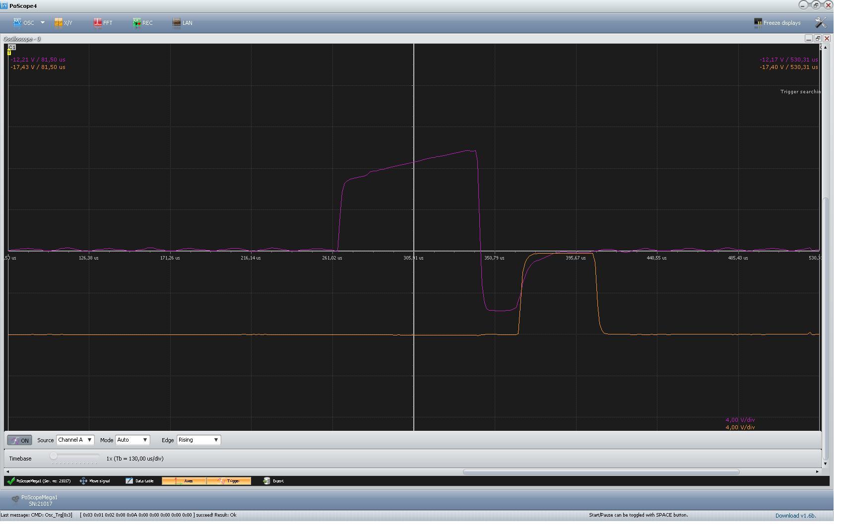

    • hello wilson
      something like this? make a screen capture some seconds ago with an untested coil

        • Wilson you are correct. Pictures are better. It is harder for me because I do not have digital scope so I must take pictures. Bernie, that is a pretty good capture. If you make it 2 times as big it would be even better!

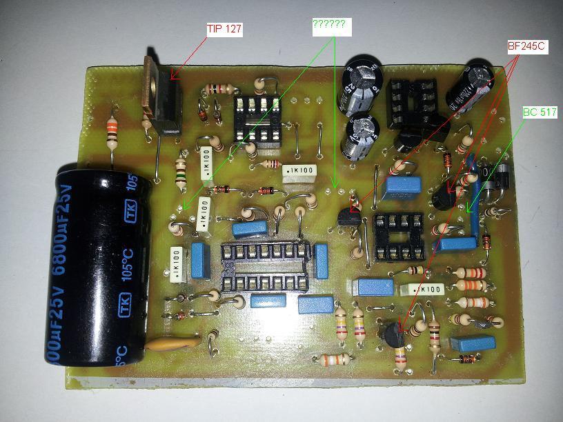

            • Problem with transistors
Name:	Copia de 20130917_204645.jpg
              Hello everyone. I have almost finished my Baracuda but I have very difficult with transistors and integrated. I replaced some transistors: MPF102 with BF245 C and MPF meeting BC 517.No A13 with 2222 BC and the 2N5485. I need help I can put as 2222 and 2N5485 ?please Thank you very much.

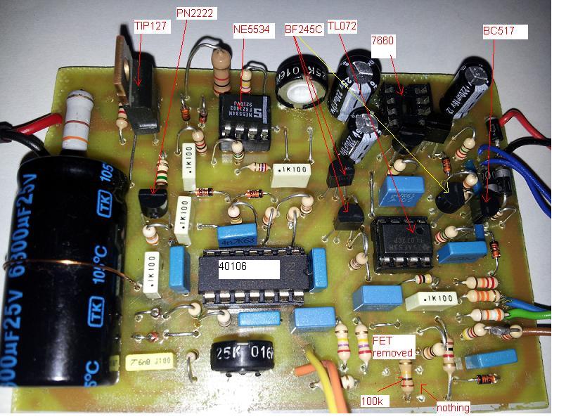

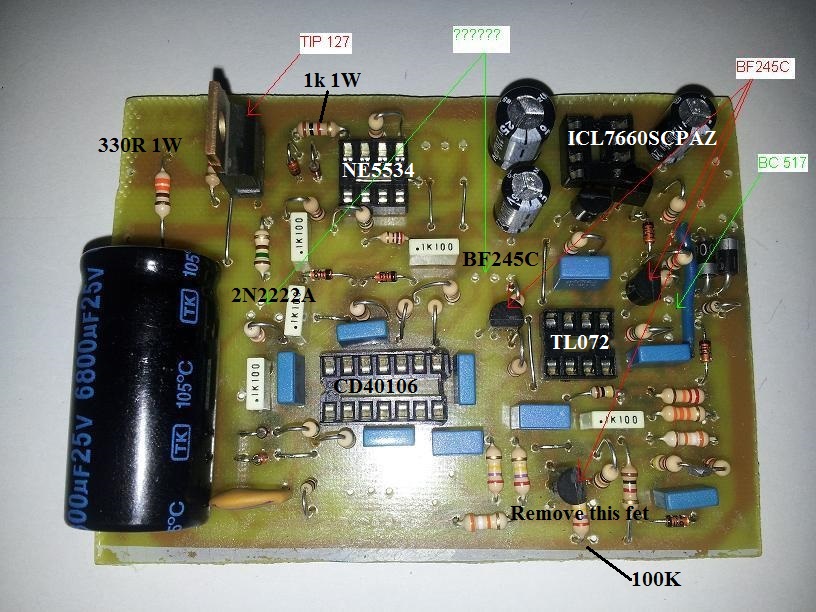

              • Hello Bion, is attached configuration of my barracuda.
                • Thank you very much Wilson.

                          • Hello Bion, is missing the CI ICL7660SCPAZ on board?
                            Before connecting the circuit to make a review of all the parts and also the welds, make sure no short circuit between tracks and islands, only then turn and check the voltages-5V and +5 V. Centralize Trimmers & potentiometers, adjust the zero volts DC on pin 6 of the IC NE5534. The coil has to be away from metals. Use a coin to move over the coil and adjust the delay on the potentiometer. Make adjustments to achieve the greatest distance between the currency and the coil. Adjust the potentiometer also Treshold threshold for audio.
                            Hola Bion, falta la CI ICL7660SCPAZ a bordo?
                            Antes de conectar el circuito para hacer una revisión de todas las partes y las soldaduras También, asegúrese de que el corto circuito entre las pistas y de las islas, sólo entonces la vuelta y comprobar el voltaje-5V y +5 V. Centralizar activadores y potenciómetros, ajustar el cero voltios DC en el pin 6 del IC NE5534. La bobina tiene que estar lejos de los metales. Utilice una moneda para moverse sobre la bobina y ajustar el retardo en el potenciómetro. Haga los ajustes para lograr la mayor distancia entre la moneda y la bobina. Ajuste el potenciómetro También umbral Umbral de audio.
                            • Yes missing ICL7660 until tomorow.Thank you Wilson. Muito obrigado.

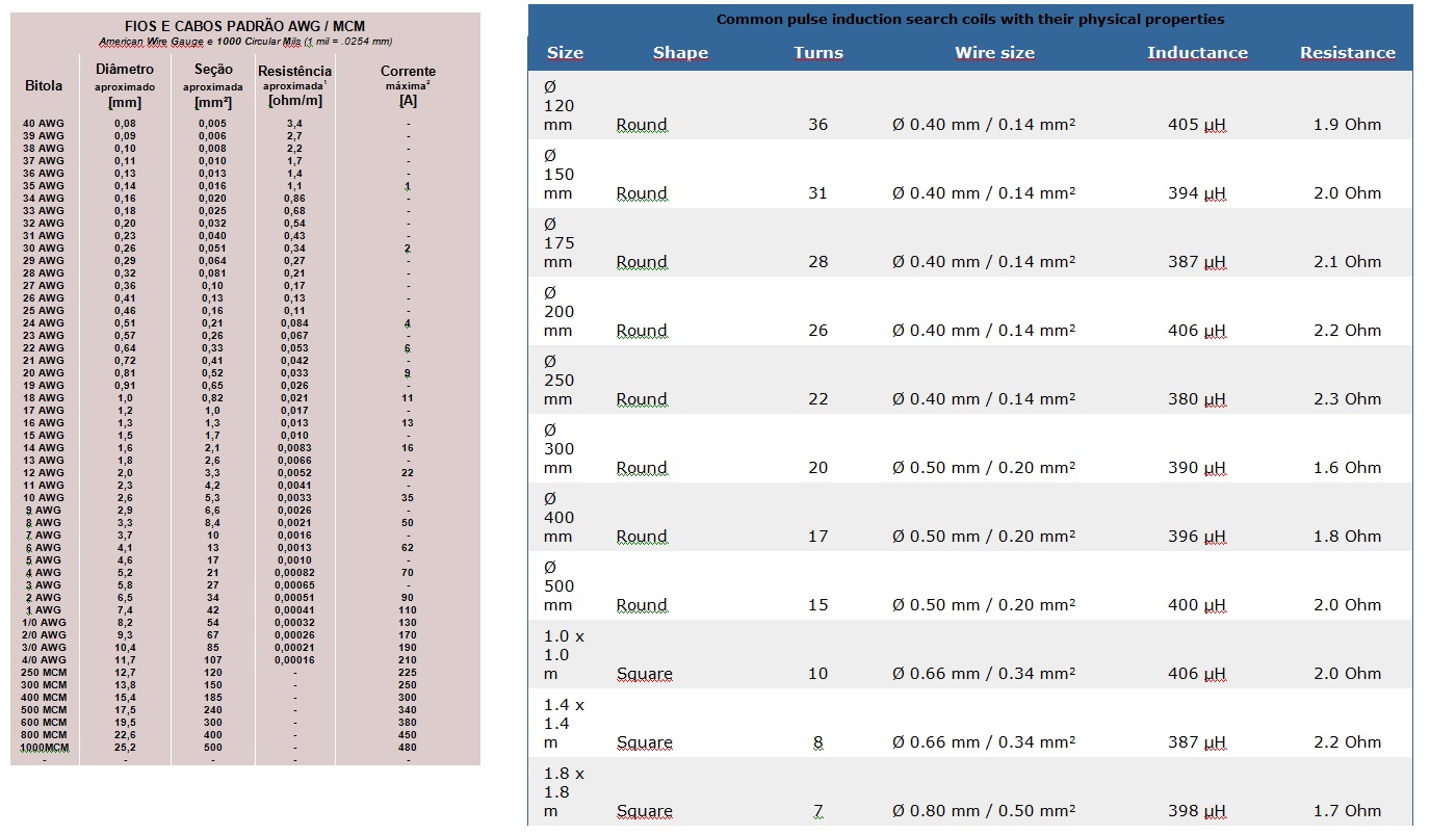

                              • Table Construction of coils
Name:	Table Construction of coils.jpg
