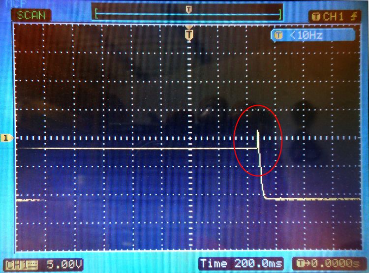

          • killer spike
            Hi All,
            I have to admit that testing a stage at a time has been a good idea.
            At first I was disappointed to find out how many “dead” (used) IC’s I kept in my drawer. At the third died 40106 I began to doubt…
            After a few attempts I find out that the problem was a damned sneaky spike at pin 5 of ICL7660 at powering. This was lowered replacing electrolytic capacitors, but, as you can see, the as$hole is still there!
            I know that a parallel diode can simply solve the problem but I’d like to know if somebody else assembled a CMOS burner instead of a metal detector.
            Thank you in advance

              hi
              first i think you say have problem to find your error on board.
              1-when your detector is off , leave all ics then measure your regulator out put.if ok then again off the detector and put the 7660.
              then measure your out put.
              please take photo your board and under it.
              check by beazer mode(diod test) all component and near STREAKs and pins.
              and step by step do this.
              but first check it

                • No, mohandes, it’s just because I’m sure that now there are no errors in the board that I’m asking if somebody else finds this spike powering the circuit.

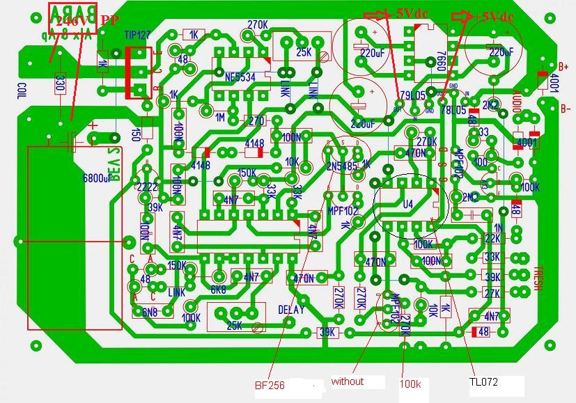

                    • I ended Baracuda. Conclusions: The TL 072 works like the LF 412. With the BF 256 (Q3) is fine, but if we put the BF245C works very bad (triple bad). With an experimental coil diameter 20cm, I can detect a € 1 coin a distance of 22 cm. The Baracuda is much more stable than the Surf PI.Click image for larger version

                      • [QUOTE=bion;177782]I ended Baracuda. Conclusions: The TL 072 works like the LF 412. With the BF 256 (Q3) is fine, but if we put the BF245C works very bad (triple bad). With an experimental coil diameter 20cm, I can detect a € 1 coin a distance of 22 cm. The Baracuda is much more stable than the Surf PI.
                        hi can i see your coil and ne5534-6 waves??please
                        i think bf256 more better than bf245c.
                        very good
                        please tell me about your coil ?mkh & ohm?
                        Edit lease return 180deg Bf transistor
                        if you have or find oscope can see 250 volt p-p in your coil.
                        please show me your waves.

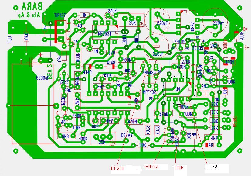

                        • Hello Bion, tell me what difference you found between BF245C and BF256, BF256 improved the What?
Name:	Copia de barra (1).jpg
                          • I dont make measurances in this points,(same coil ) with BF245c detect euro coin at 5 cm and with BF256 the distance is 22 cm.
                            • Originally posted by bion View Post
                              Bion, I have trouble finding the original and also the fets BF256C here in my area, I find it strange what you said because I can detect a gold ring at 30cm distance using the BF245 I already posted a video on the forum with this test .
