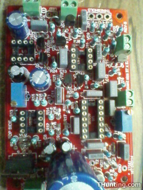

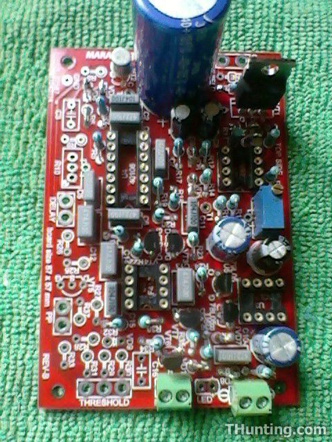

    My current board, please dont scold me tin every where
    Top
    [ATTACH]36377[/ATTACH]
    Bottom
    [ATTACH]36378[/ATTACH]
    And this is unfinish bara, i will use it as pointing detector.
    [ATTACH]36379[/ATTACH]
    Thanks for supporting me old_chart.
    I think you have it. The 0 volt track is the one attached to the minus side of the battery.It usually runs around the outside edge of the board, but you should be easily able to trace it from the battery- lead.

                          • new pics of new rev B pcb
                            • You did a Nice Board ! I just needed the BOM to set parts. Thank You. It's all but completed. All voltages getting were needed. Now need to get a coil hooked up and Damped.
