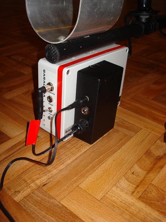

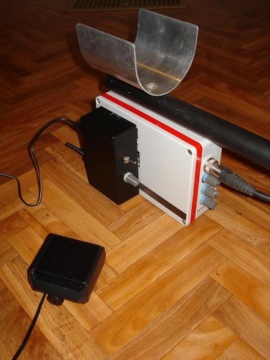

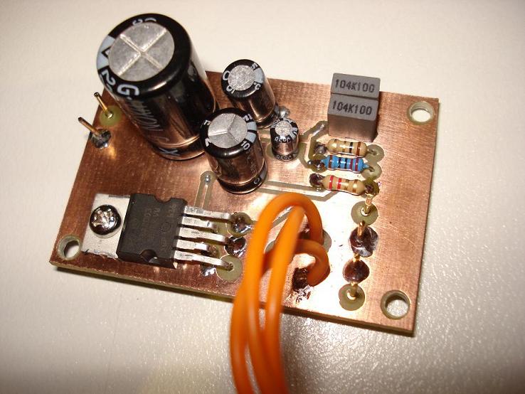

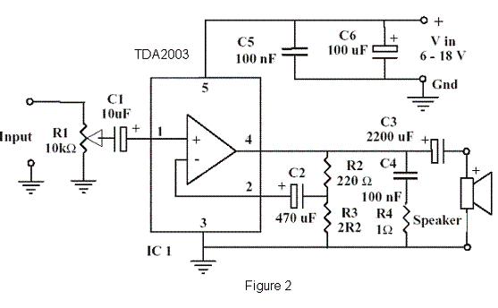

                G'day,
                The only mod done was the LM4562 that replaced the LM412. The unit plugs into the headphone socket on the control box and the external speaker plugs into the audio amp - have attached photo's of how it looks and the schematic. Now I really love the bara as a beach detector - to give you an idea of depth performance, I dug out a $2 coin at approx. 30cm and a 20 cent coin at approx. 35cm at Dromana beach.
