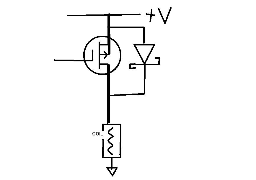

                        • ADAM
                          If you are smoking lesser FETs you may improve them with a schottkey diode..
                          as attached..
                          most of the hi voltage fets have these in the package and makes them a hi volt device
