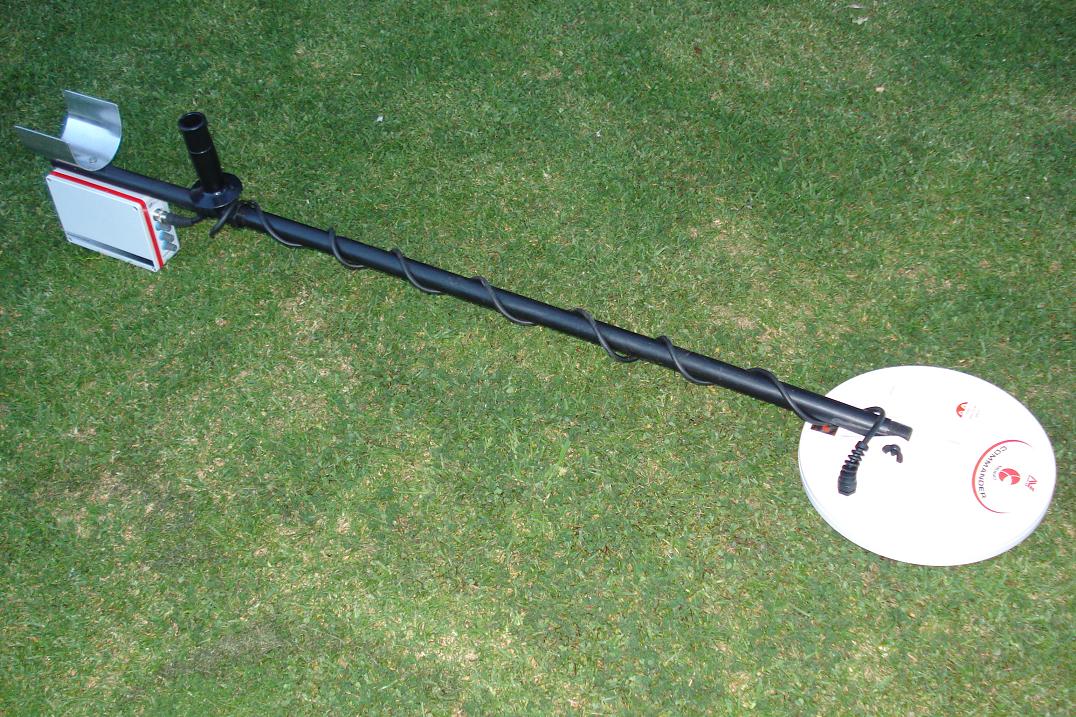

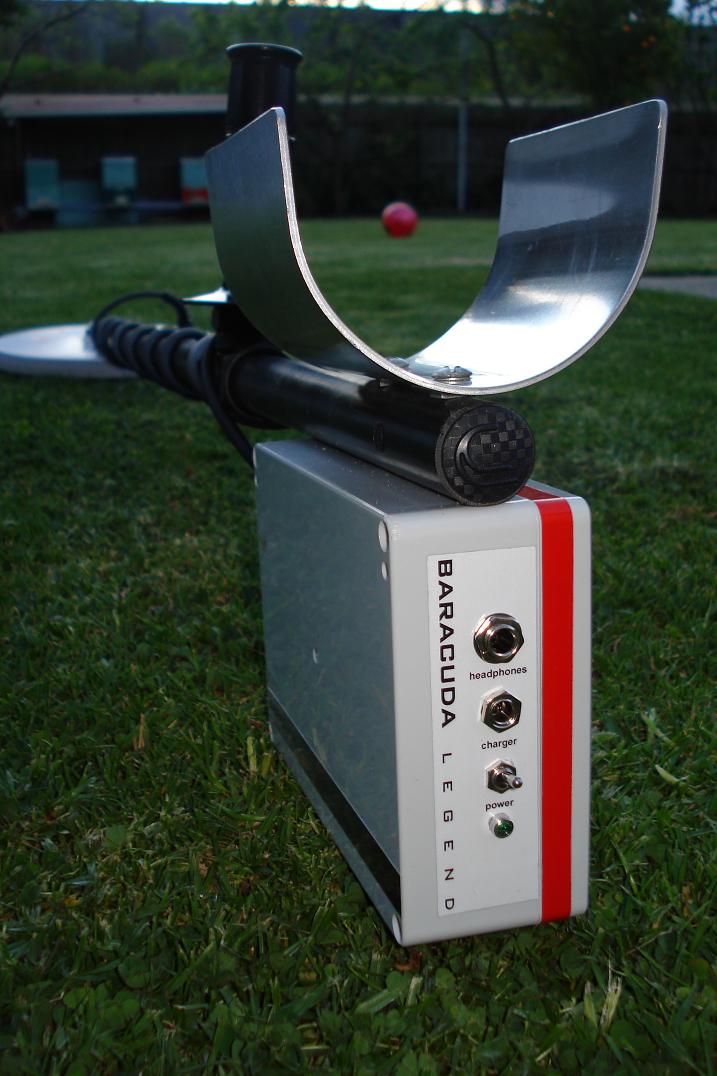

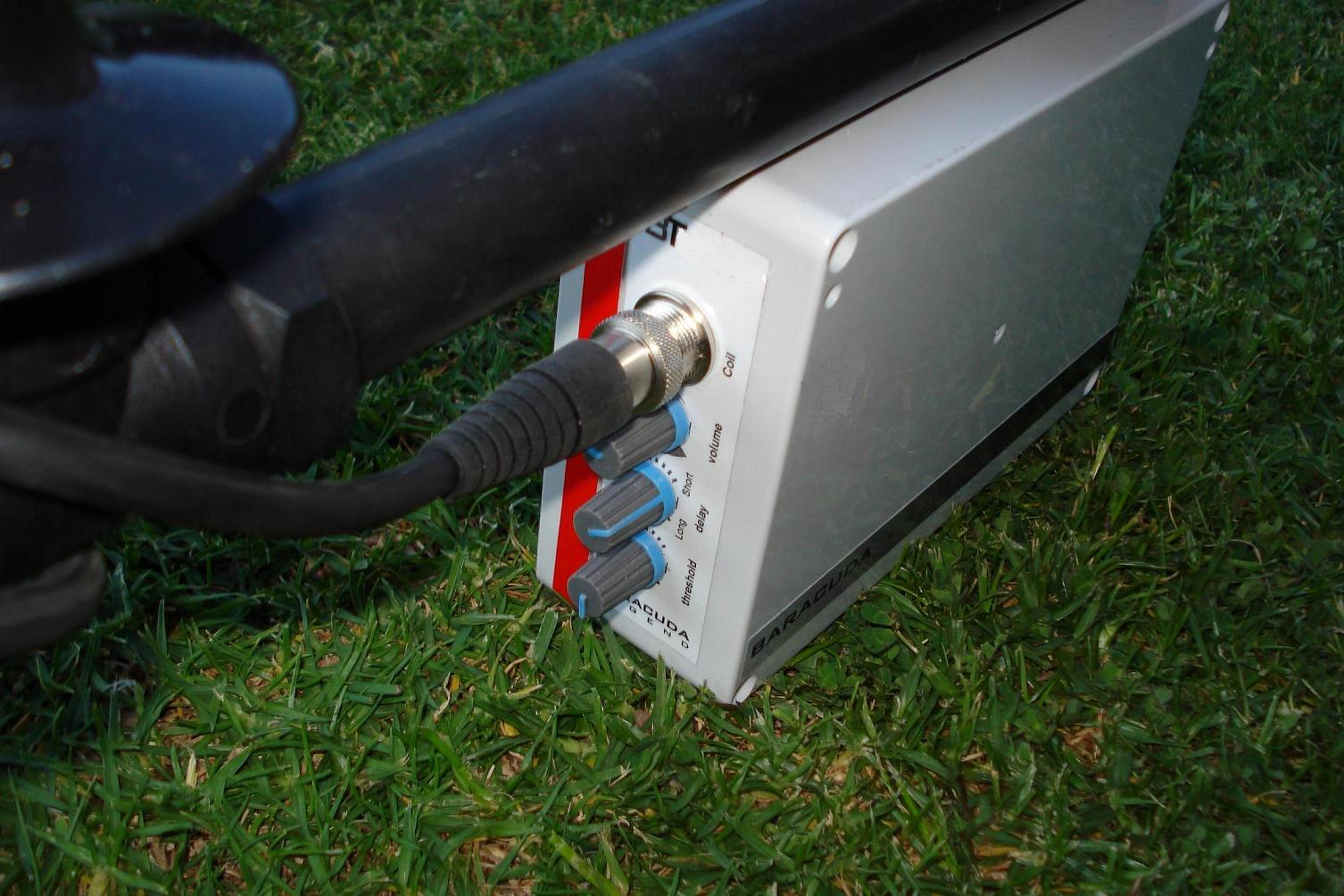

    Hello all,
    My finished baracuda with Minelab commander mono coil. Baracuda is a great diy p.i. project and it is a very stable, light and simple detector to use. It works lovely on the beach, football fields, playgrounds, etc - on any ground where it is not minerialised as the machine can get quite chatty. I have found that adjusting the external 10k pulse delay pot will reduce ground noise, but you lose sensativity. The only trouble I had from the beginning was the tip127 power transistor, as it could not handle the 9.6 volt battery pack - the machine would not work properly and the tip127 got very hot. I replaced it with a irf9640 which fixed the problem. I also have a gary p.i. pulse 2 which also is a nice project, but the bara punches deeper and rarely do I have to adjust the threshold. I have built two of these circuits - my first bara I etched my own board and purchased parts from element 14/jaycar and the second was silverdogs kit.

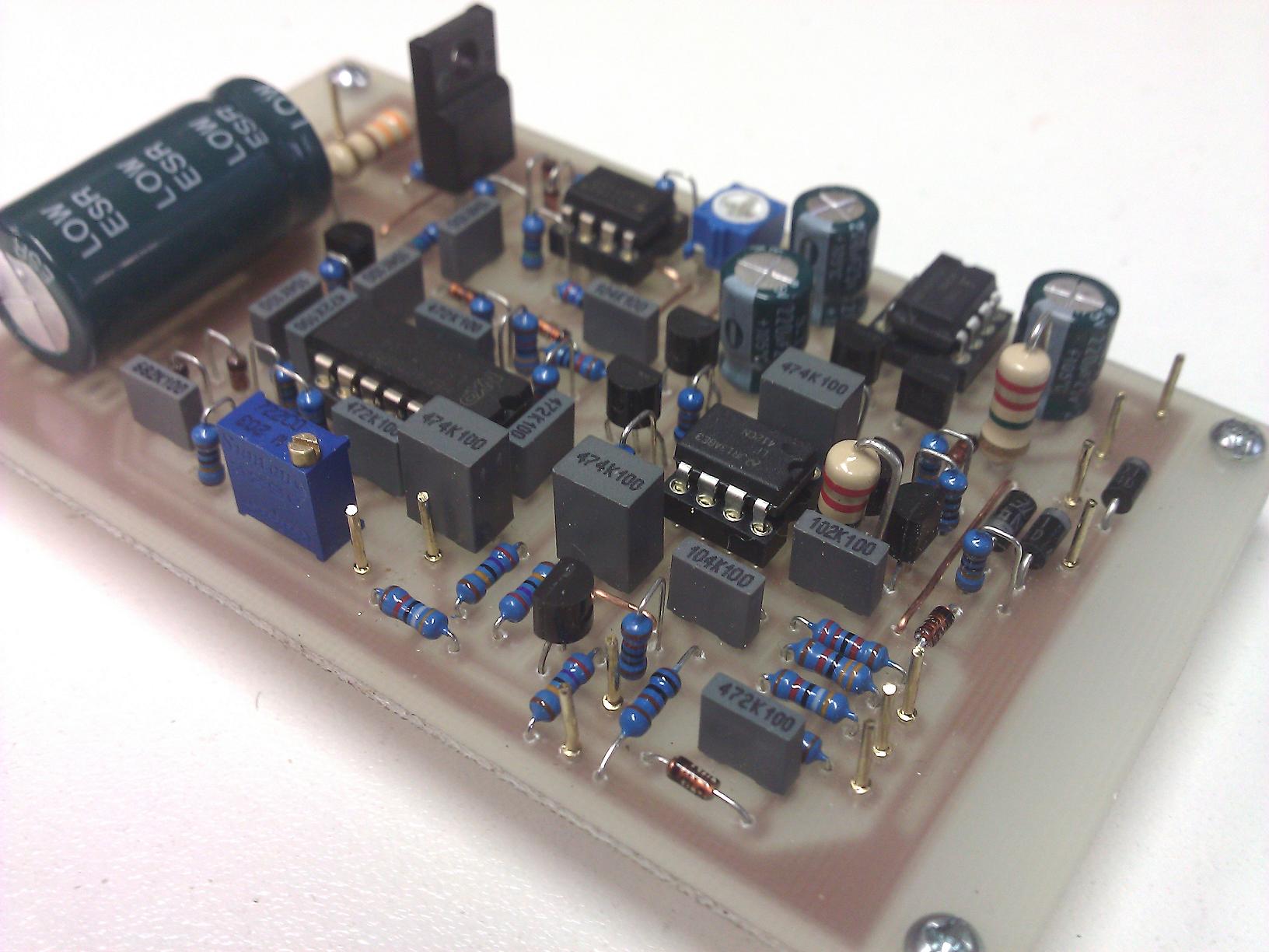

      • Finderskeepers, very nice ...the Baracuda deserve that work because of this cool design
        • now that is one tidy board , and a pleasure to look at ,
          makes me want to stop using vero board and go all professional !

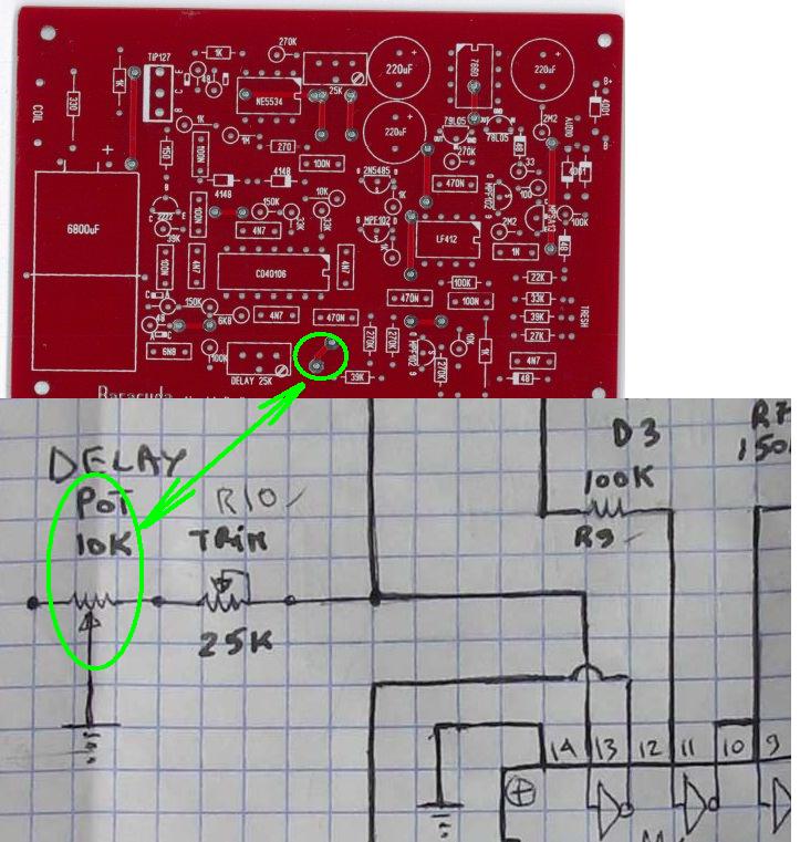

                            • Hi Don,
                              I guess I should have explained my post better. On my Barracuda I have externally mounted a Time delay Pot. in series with the onboard Time Delay pot (fine and coarse). I also made both the threshold and Sensitivity pots external/remote. Having the Sensitivity pot external allows you to optimize the detector based on the ground you are hunting (this adjustment had a noticeable effect between air testing and real life hunting situations when I was adjusting/setting mine up). The sensitivity acts similar to a Ground balance on my detectors.
                              The "Tone ID" I was referring to was brought to my attention by a friend of mine. Based on where you have the Pulse Delay set, large targets/ Large emf fields (quarters, cans, large iron, big brass items) respond as you approach the target, go silent when directly over the target, then sound off again as you leave the target (similar sound as going over a "cold rock" with a vlf in All Metal). Smaller items (pulltabs, nickles, rings, small brass, nuts, foil) give a quick solid sound all the way through the coil swing.

                                Hi dfbowers. The silverdog kit no potentiometer DELAY = 10K ( external - fine adjust), instead it is a "bridge".
