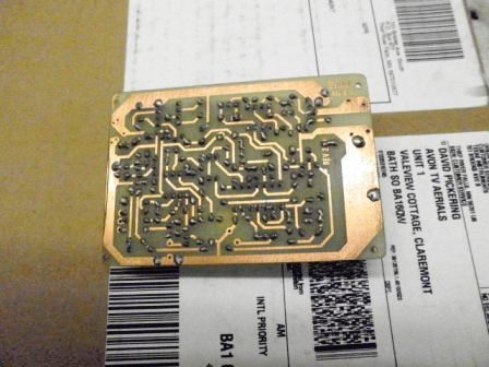

      • There was a short circuit between the pins of the 7660. A defect of PCB manufacturing. It was so fine that it had not seen without a strong light behind the plate.

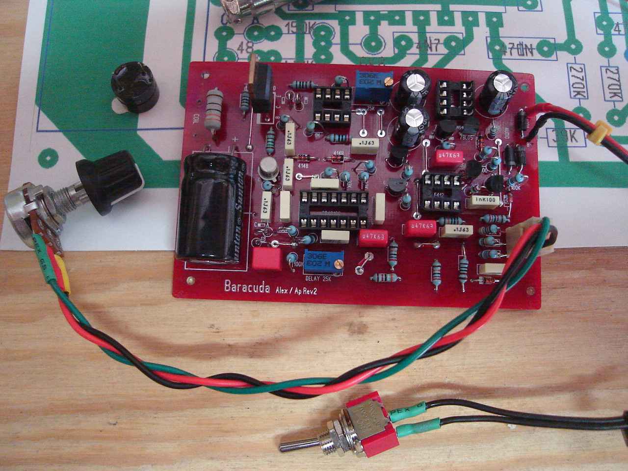

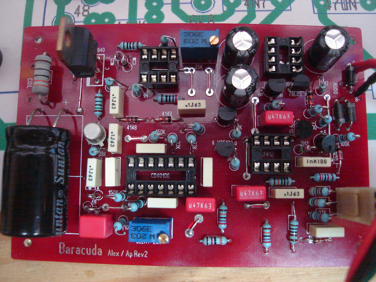

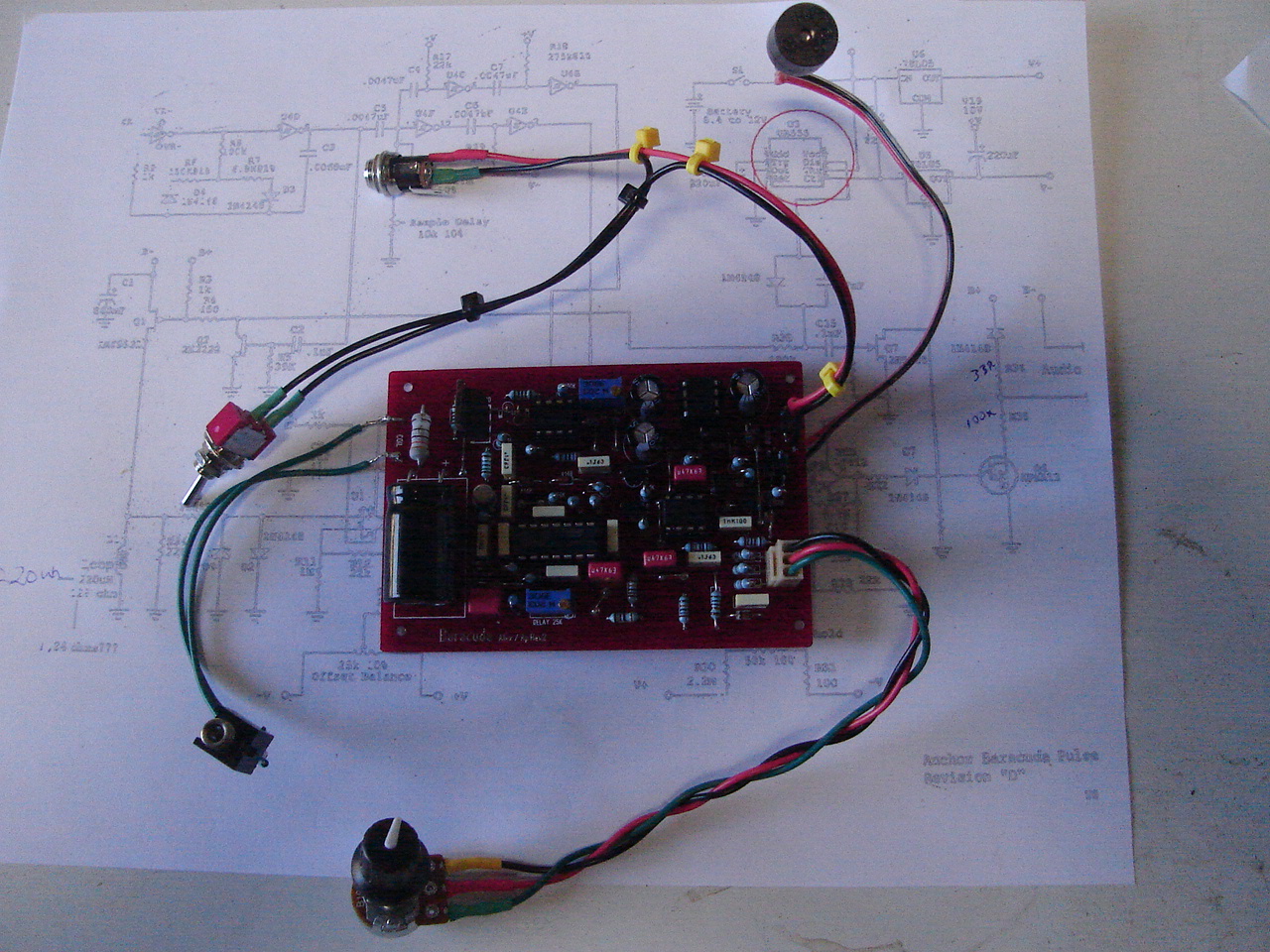

            Received my baracuda kit from Andy (silverdog) on friday and saturday morning spent 2 hours checking all the parts and layout then to assembly.
            Nice little package and was a breeze to build.
            Prelim tests in my garage gave what I thought are some very good results considering I am using a 10" .5 enamelled copper wound coil with 21 turns
            with no shield for my surf pi.
            I will assume once I order some more wire and build a coil to baracuda spec it should be just as good if not better. This little guy smokes my sm pro pi
            and it isnt even tuned up or using the right coil yet..
            I had some of the other mod parts on hand so gave the TIP127 a try, it did get very hot quickly so I put the IRF9640 back in, also switched the LF412
            for a TL082 but it seemed a little chatty so swapped them back for now. Have a 6800uf cap on its way for C1 but for now it has what came in the kit
            which is a 3300uf. Will be adding an external delay along with the LED.
            Not sure what box I'll use yet, I have a pelican 1030 case and it fits nicely so it may end up in there, dont know yet.
            All in all, great little project and kit. Very happy with the result so far. Attached a couple images of board and with my test objects and gave air
            test depths. These are "pre-tuned in" results and using an open surf test coil.
            Thanks silverdog for a great little kit and to all the members that have contributed to this thread.

              the surf coil is what heated the tip127, the irf fet is more tolerant, while the fet is fine i like the tip127, aim your coil at 400+uh and 1.5r and you will get no warming of the tip127, i would add a heatsink to the tip anyway, if you want to run surf coils you need to retune the damping resistor with a scope.
              but if you wind your own coil to specs this is not really needed, i have built two of these one on the fly to recommended specs, and the other fine tuned with scope both work as well, since you have the surf it may help you to run on surf coils.
              but i dont and very quickly retuned it to the same barracuda specs, for interchangeability between the barracuda coils, dropping the voltage below 12v helped mine too, mine run perfect at 10.5 volts(alkaline batts).
              • Hi
                Nice Job, Sinclair is correct the original using TIP127 Darlington transistor was designed around 10.8v max supply, How ever the transistor is quite robust whilst using a heat sink will tolerate 12V supply OK for hours of use.
                Maybe of interest to some here, I managed to get hold of the original Surf PI which interestingly enough used a TIP32c 100v 3amp Bipolar transistor, so may put one of those together and see what if any difference it makes.
                All the best

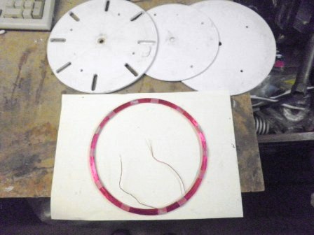

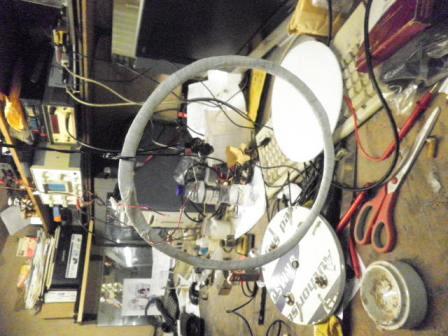

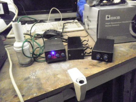

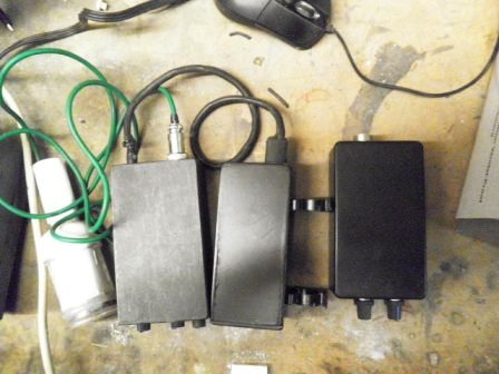

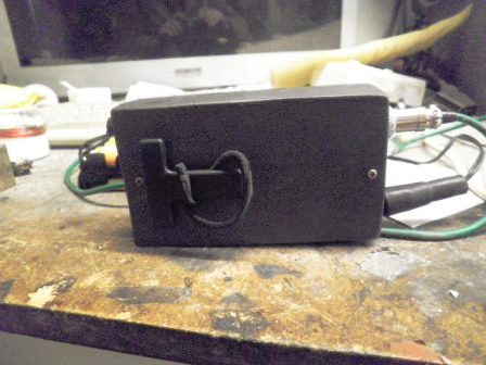

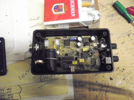

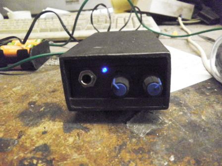

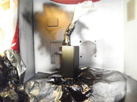

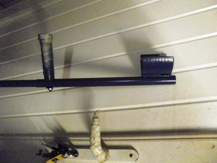

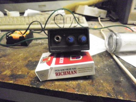

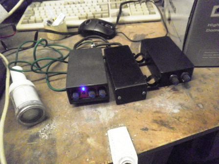

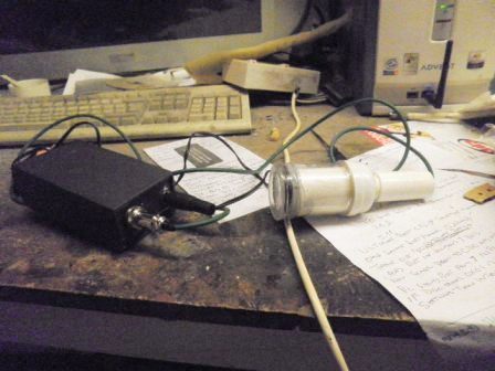

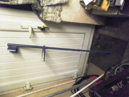

                    • Some pictures of both builds
                      Hi
                      The second build was mounted in a purchased cheap housing built for extensive tests which are still on going hence why all the plugs and sockets.
                      First build is all hand picked components tested to original Barracuda specification, housing made out of scrap styrene painted with my synthetic graphite potion , Front fascia is tatty because since fitted a fine delay pot and had to move things around but will be sorted at some point in time. If you notice it has belt clip which will also clip directly onto the stem together with battery pack which can clip under arm cup to balance things up
                      Universal battery housing made out of scrap styrene, The stem made out of alloy which I normally use for mounting aerials, plastic lower stem wood dowel inside that, The arm cup from old cable drums inners, didn't chose the paint colour as such just bought from garages when they have end of line flog off's £1.00 a can, lovely blue lol, mind you I did pay retail price for the black spray on battery housing.
                      Larger coil wound with my electric coil winder project, The three forms I used are cut bespoke for the very original Barracuda specification 7.5" inner , 2 outers 8", The actual configuration of the spools were taken off Garry s winder its just a scaled down version made out of some type plastic or man made fibres that came from one of my old business boards.

                        • hi geocash, the extra finetune delay pot is 500 ohms, not 500kohms.
                          if you like non motion detectors the extra transistor and two resistors, will achieve that, but while its still simple to do its not as easy with the newer boards.
                          and to be honest ive tested it both ways and if you like motion detectors i would not bother, the tip 127 instead of the irf fet is worth it, i think it has a better "attitude" with the tip127, the best tested components make a noticeable difference too.
                          the second one i built has only hi grade and millitary spec components, totally over the top, but i'm proud of it, i'm looking for a quality clear enclosure to finish it.
                          it is an excellent project, i recommend it at any level.
