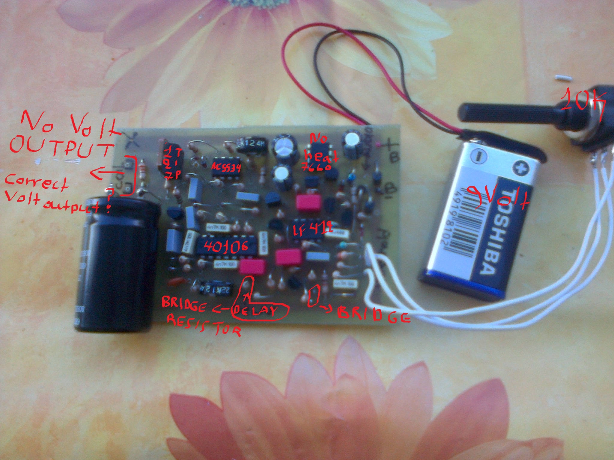

ID:	336758 please help me output voltage zero please helpme nothing dosent get heat
                          may god help me
                          • Hello antonioknight, install the speaker, the coil also use a 12v battery. NOTE: use a fuse on the positive battery 1amperes.
                            Check the voltage of -5V +5V positive and negative pins of the integrated circuit.
                            Check all welds and possible short circuits on the tracks and pads. Remove fet Q5.
                            • wilson what is the output voltage of the coil
                              • what battery i should use ????12volt ampere??
                                why no 9 volt?? thank
