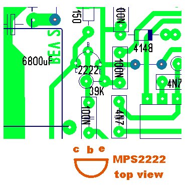

    • I think your damper resistor cannot be 0.25W. Consider that by using IRF9640, the flyback pulse may reach as high as 200V and most 1/4 watt resistors will not be rated for 200V.
      Should use 1/2 watt resistor as minimum, and even better would be to use
      1W resistor. Also, your 1k preamp input resistor should also not be 0.25W. Get something bigger or else it may crap out one day and you will likely never find the problem. Just my opinion. It's an uphill battle trying to get PCB "engineers" to design their boards to be durable.
      The MPS2222 silkscreen has the package outline reversed. E,B,C printing is correct but the outline should be turned around as should your transistor.
      Please do not use TL081. The null pins don't match.

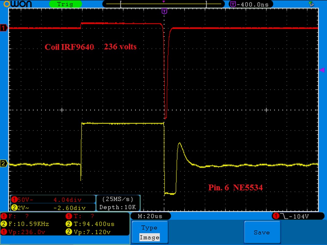

        3. The NE5534P pin 6 is acting funny. In the picture is the signal.
        4. Also there is no signal on the coil.

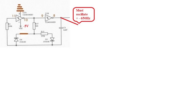

            • Pepsy, measuring oscilloscope pin 8 IC CD40106 and coletor 2N2222.
              • Hm...
                PIN 8 IC CD40106 has 0V and nos signal
                Collector on 2n2222 has 9V.
                I'm afraid maby along the way i reversed battery polarity or something... as jap said - fatal mistake.
                Well i hope the problem can still be found..

                  • Well pin6 NE5534 is like this...
                    So i guess i'm in a world of...
                    And there is no voltage on coil...
                    Do you have an ide what component could be faulty?

                    • Pepsy, check pin 7 IC CD40106 -5 volts pin 14 GND pin 8 must have pulse width around 80US often 'close to 640 hertz, if not teetering verify components and IC.

                          CD40106 pin 8 no signal! (What components to check? ALL? )

                          • Check these discrete components including IC CD40106
                            • Hello!
                              IC CD40106 is not working. I will replace it. Hope it will work than!
