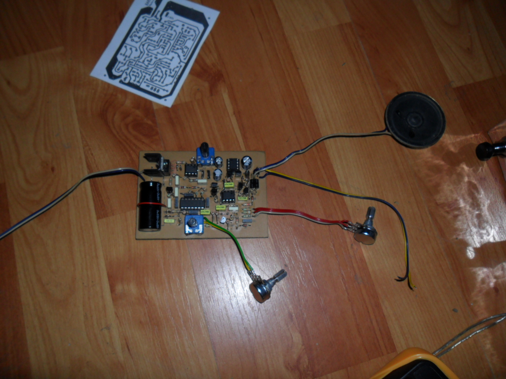

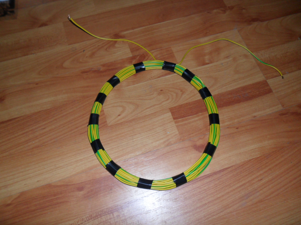

      • Hi,
        I just finished my baracuda and is working with quick done search coil from 0.5 mm stranded pvc insulated wire on 200mm diameter with 29 turns.
        Now i want to make a coil(with your's help) for small nudgets of gold ie. 3-4 gr.
        I have some enamel copper wire 0.25mm and i wonder how would work if i do double winding with this wire on 200 mm diameter with 28 turns?
        Sorry for my English.
        Here some pictures:

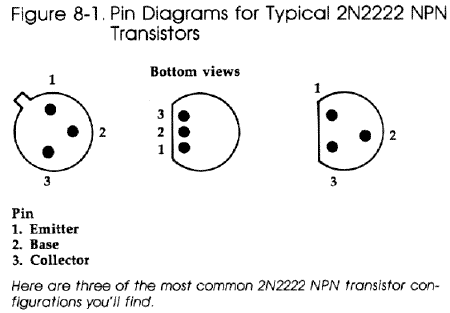

        • Hi wallker. If you already have the wire you try and let us know the results... do not be afraid you will not spoil anything... but I wonder that your Barracuda works with such position Q2=PN2222 ???
          • MPS 2222A
            Q2 is MPS 2222A=PN 2222A and must be positioned this way(PCB is designed for metal case transistor)...it work's very fine without removing Q5 check out pins:

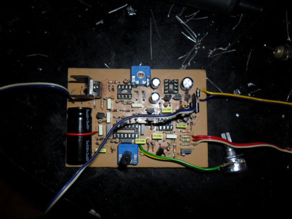

                    • I was busy couple of days,but sunday is a day for barakuda
                      I will make a few turns for some coils,but after replacing TIP 127 (which is burned up when i was looking damping resistor value...) with some substitute...
                      What would you recomended for substitute ?
                      Best regards.
                      • Dear Nikolaj,
                        where are your damping resistor from your photo?
                        a) Please never testing your circuit without damping resistor (220-390R min.1W!).
                        b) We strongly recommended mounting the steel cooler plate in the TIP127(why use TIP127?)
                        From this position better an FET (for example IRF9640 & Co.)
                        These a) and b) parts are heats (approx 60 Celsius is normal , i think.)
                        My suggestions:
                        1) 555 Oscillator working? Not halted?
                        2) If working, please check the oscillator time period. if the period is very short (higher freq.)
                        it is quickly opening the power transistor, and battery current is higher
                        (The normal PI-s are uses approx 100-225Hz, sorry im dont remember the Barracuda freq. The battery power is concerning with freq. and tank capacitor, but approx 100mA is very good for metal detecting.).
                        3) Oscillator capacitor is good value? For example: in the drawing write is 47 nF, and you use 4,7 nF (check for your drawing for the correct values -- im dont remember.)
                        4) About oscillator part not an short circuit? For example: potentiometer connections, panel, etc.
                        Brg
                        Rumcajs
