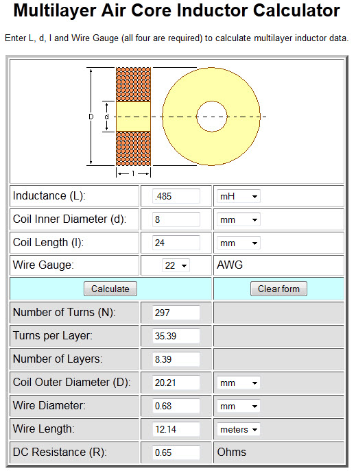

  • Hello,
    You can try those parameters, good luck
    All the best

      • Originally posted by Legaucho View Post
        Hello,
        All the best
        hello
        thx, but look at the parameters
        you calculate with milli Henry (result high number of turns and layers)
        we need here MICRO Henry (sorry)
        i have made a multi layer coil with litz wire some weeks ago (posted already here)
        result was very good
        but some here make good copper wire coil (simple monoloop)
        so i thought ok back to simple copper wire but is was not good (i think of thin isolation)
        regards bernd p.s good caculator

            Hello bernd
            Thanks for your answer, I confess that I am a bit lost, because I made two different coils, one with these characteristics:
            N (Turns) = 36
            D0 (internal diameter) = 183,0 mm
            (Tickness) = has 4,0 mm
            d (wire diameter) = 0,7 mm
            L (inductance) = 0,491 mH
            O (wire length) = 21,20 m
            W (wire weight) = 72,8 g
            R (total resistance) = 0,9 Ohms
            and a second (that I use as pinpointer) with these characteristics:
            N (Turns) = 279
            D0 (internal diameter) = 10,0 mm
            (Tickness) = has 20,0 mm
            L (inductance) = 0,487 mH
            O (wire length) = 14,76 m
            W (wire weight) = 50,7 g
            R (total resistance) = 0,7 Ohms
            to measure I have one device inductance, with two possible ladders mH and H, then I think that my information must be good, but I can make a mistake.
