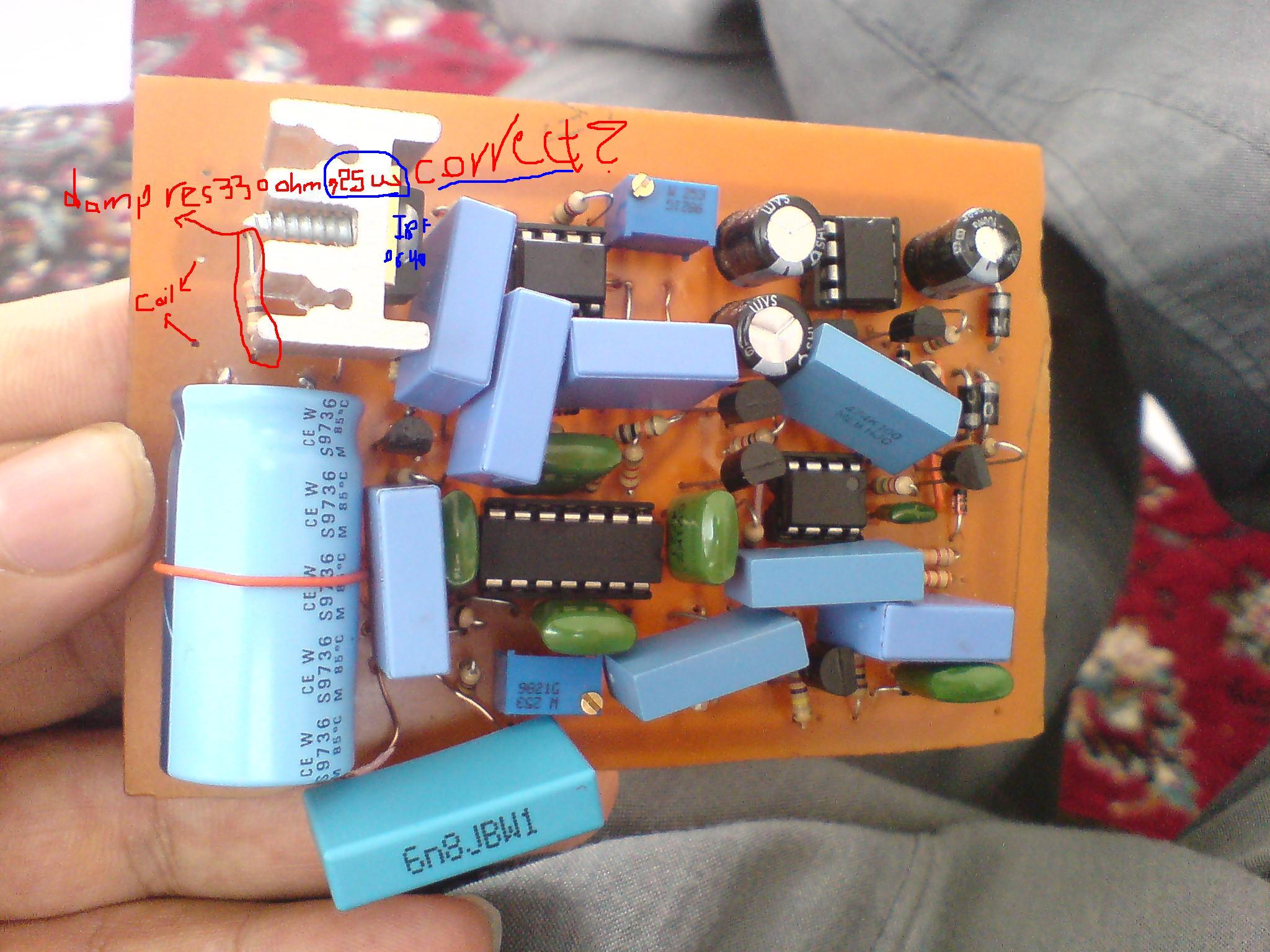

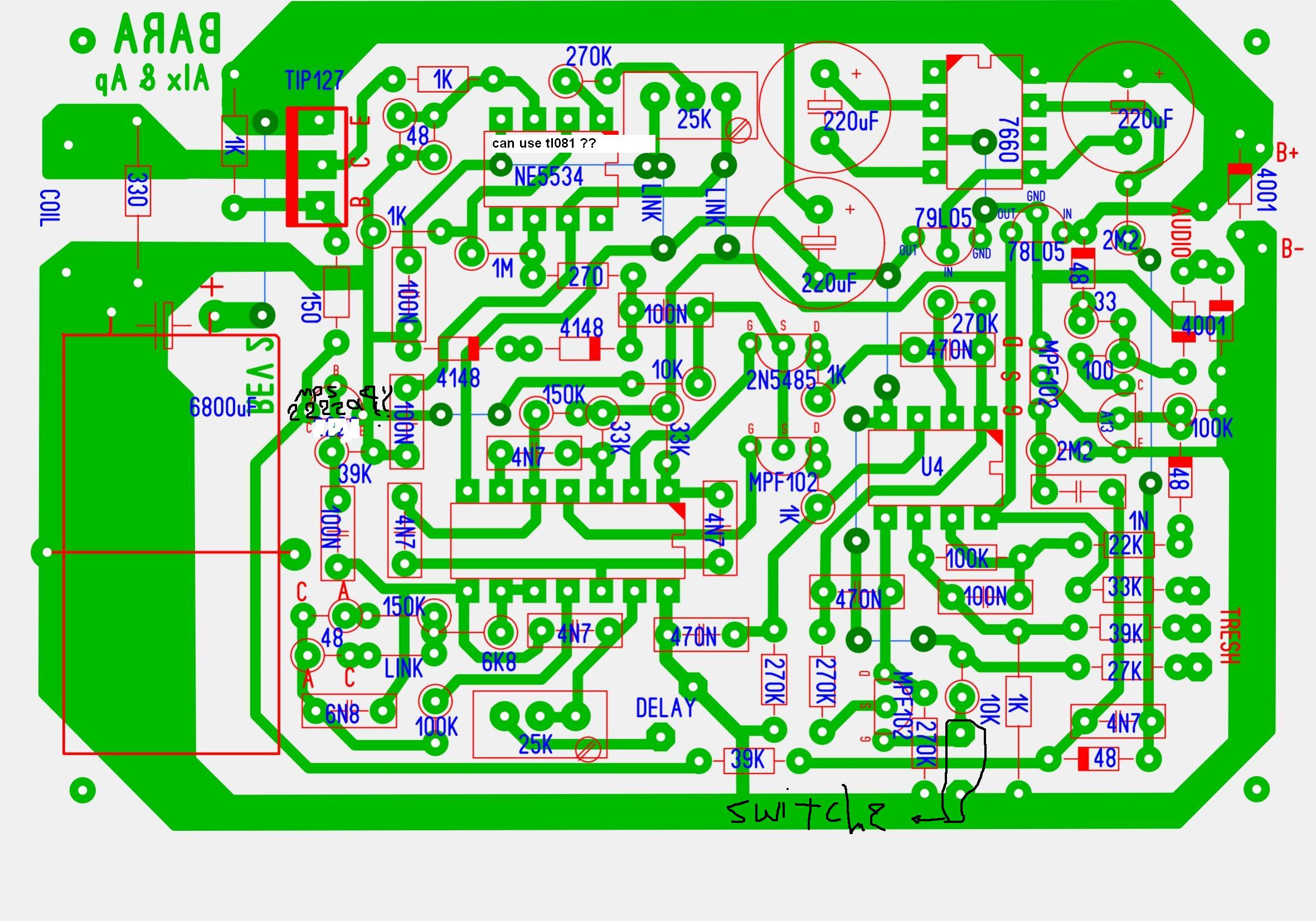

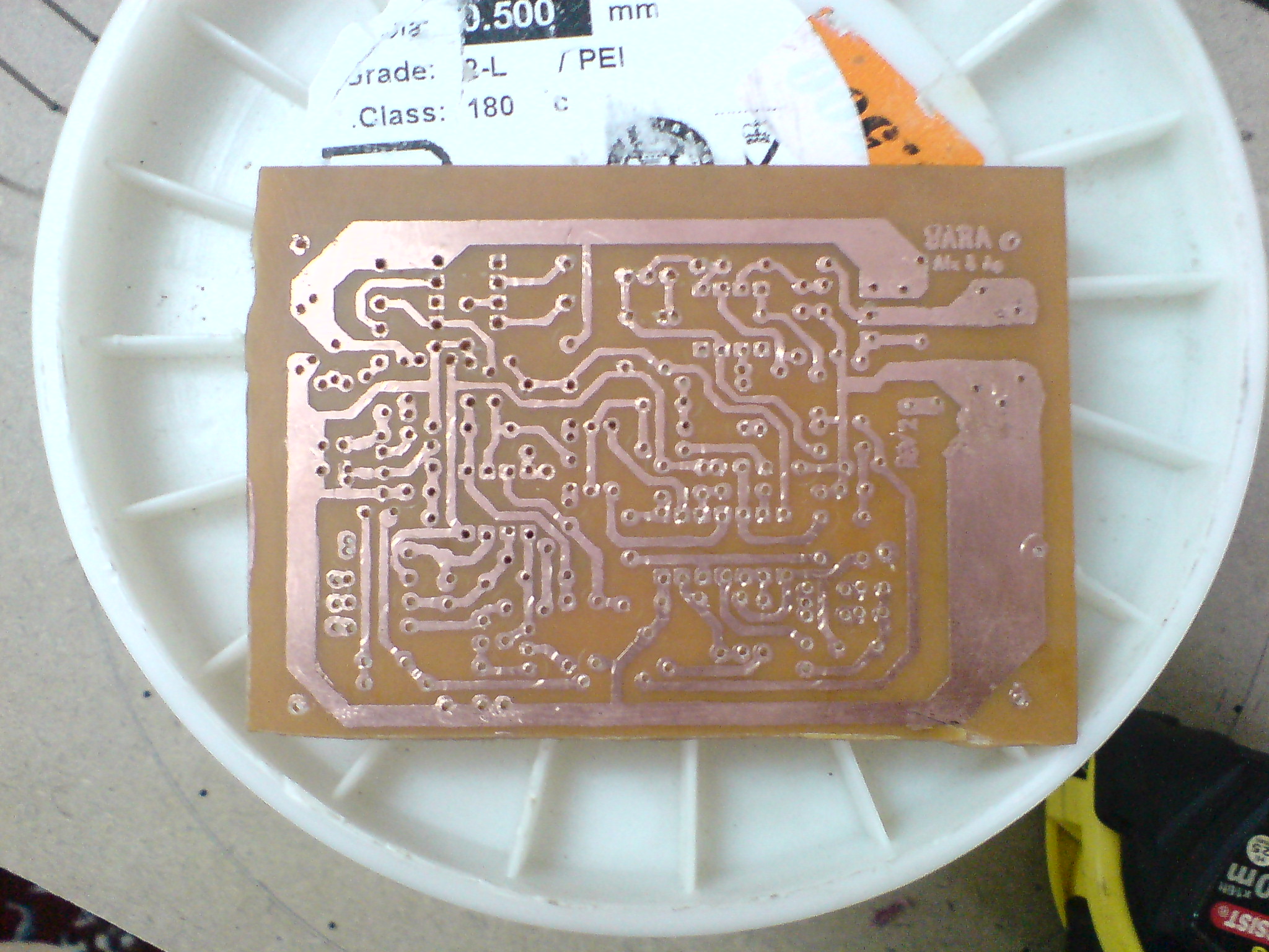

        • this is my pcb
          i am going to make it,mr wilson please tell to all your detecting in the ground please
          and my engish is bad i think your means i use bf247c( but i said have bf247a, is it good)
          cheers and regards

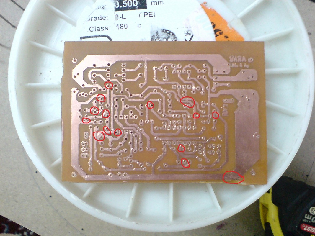

          • Mohandes you will have problems with this PCB, many points in a short circuit and other points too close, check very well compared to the original design.
            How to use the fet BF247A I believe it works, if not we have to leave the original for what we have at hand with characteristics as close as possible.
            Hugs.

              hi my friend
              yes i know because my paper not good and do that,i know these errors but i say thanks for your attention.
              ok i buy bf245 and 256 and 247a and i set on my board and check their works(each times one kind them)
              merci
              • Ok Mohandes, good luck!
                Hugs.

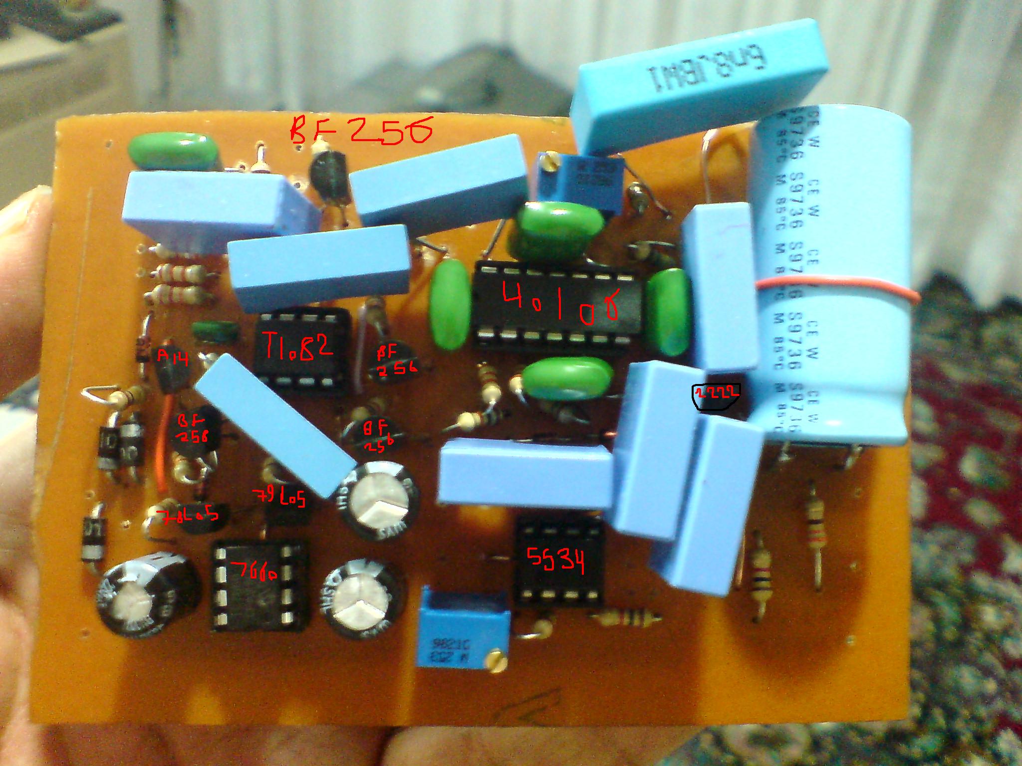

                • need to guide

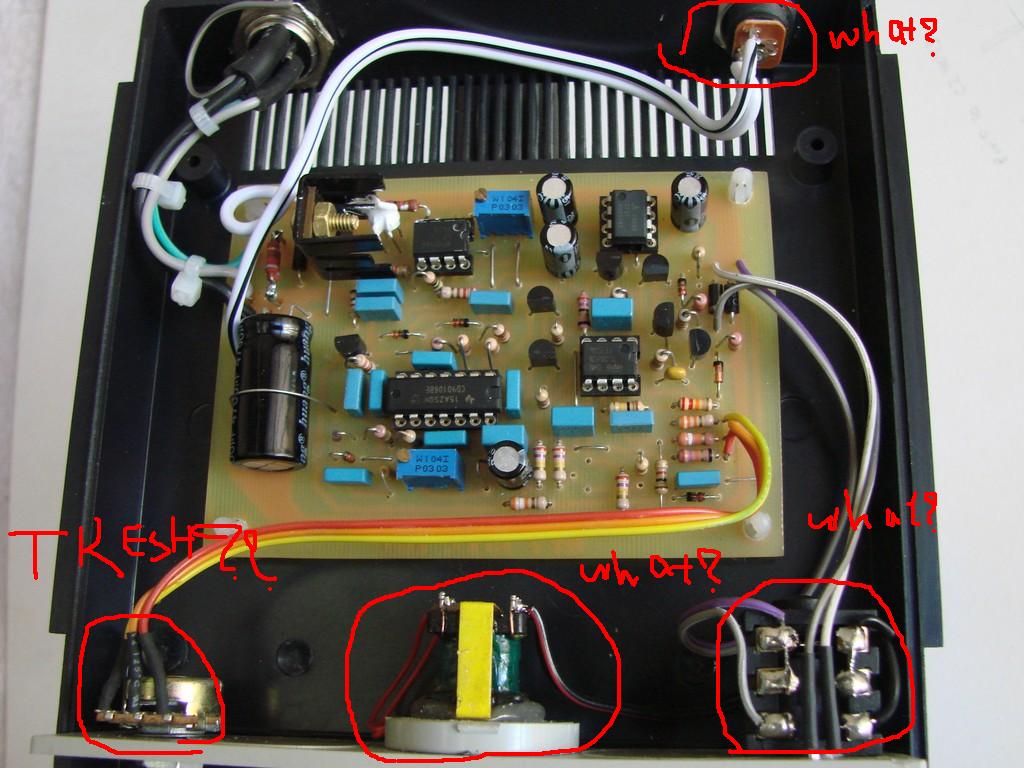

                  hi tonight i finish baracuda that design by Apberg,
                  now mr wilson and Apgerg i ask my ? in the pics and need to help ,please answer.

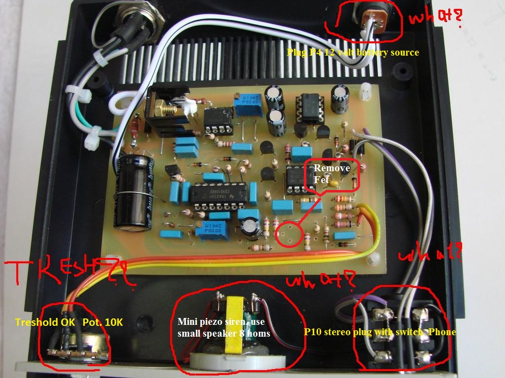

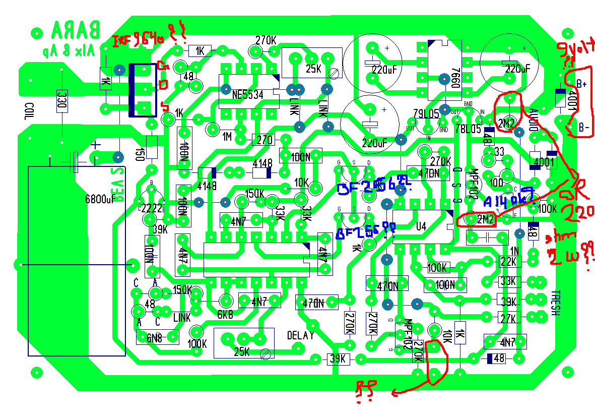

                  • Mohandes,
                    I believe the BF256 are installed backwards. It looks like the PCB was created for 2N5484,5.
                    2M2= 2.2MΩ
                    (You penciled the IRF9640 pin assignments backwards.)
                    • Mohandes, the reason has Porkluvr the fets should be rotated 180 degrees, the resistors are 2M2 or 2.2 Mhoms (red, red, green) The IRF9640 is installed in the same position TIP127 and A14 is correct.
                      • i do that mr porkluvr and mr wilson

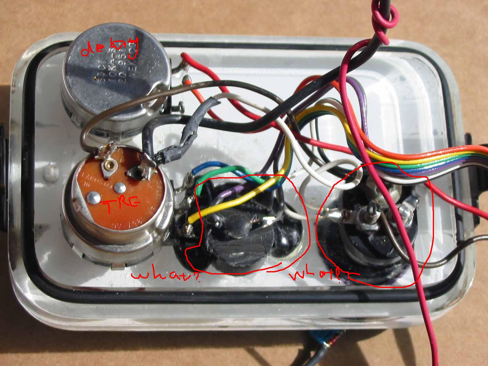

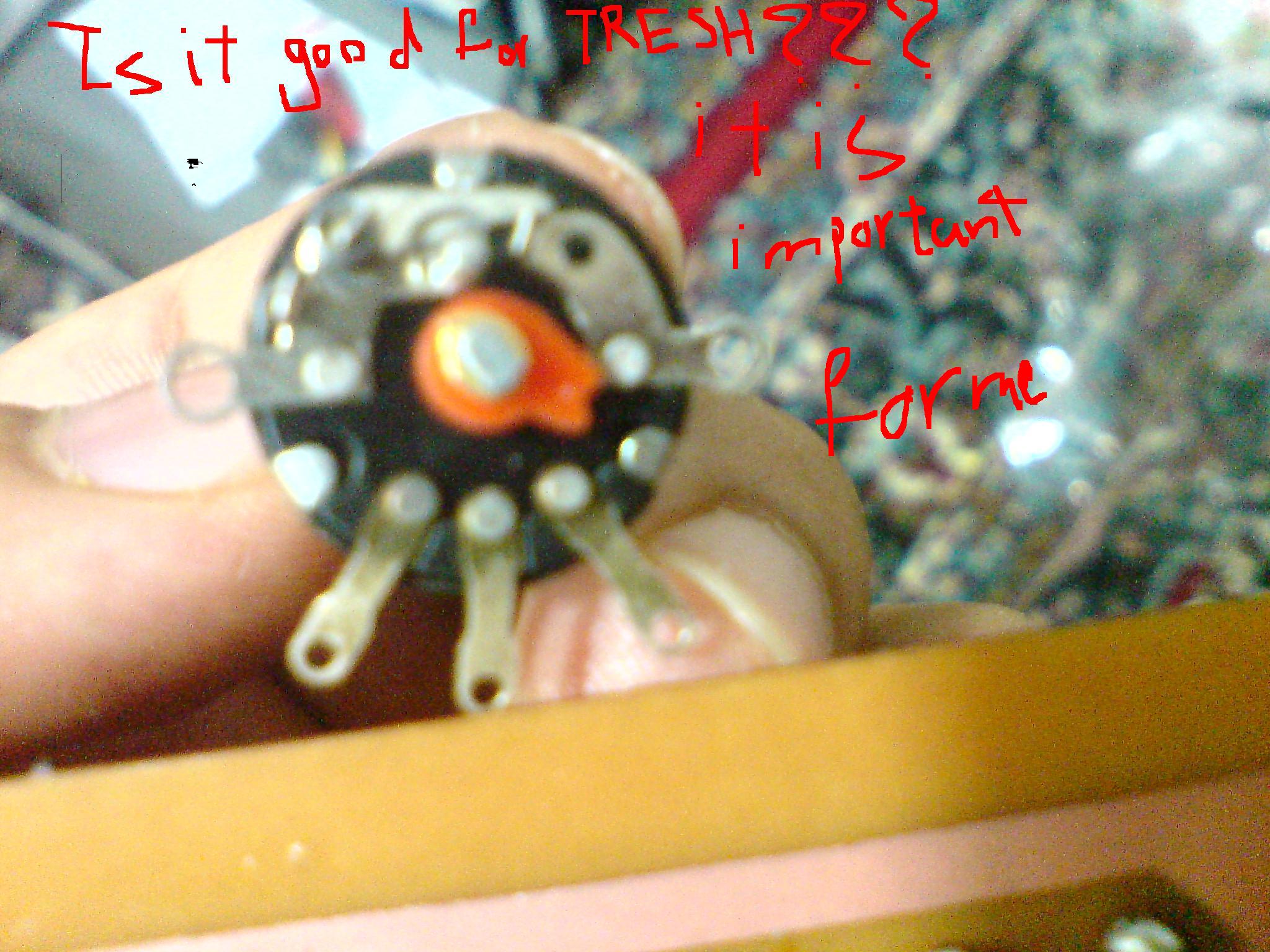

                        i need finall help
                        who can design in Paint or...for me ,my ? in the picture(simple and easy please)[i just to connect the switch and phone and..but dont know how do the wires,see picture and design simple for me ,please)
                        each picture you think is simple and better for me.

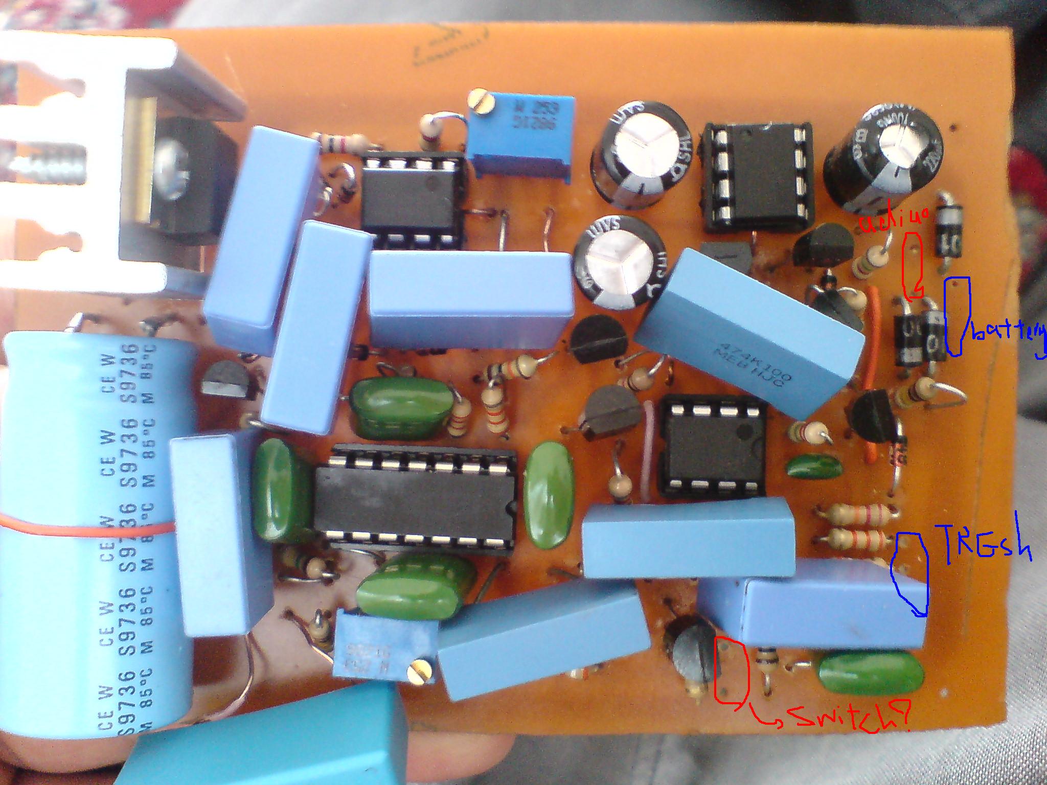

                        • tell me
                          Hi all
                          now i watting to your help , i put finall board and need to connect headphone, tresh pot, and switch and...i certain in past pitures,please tell me

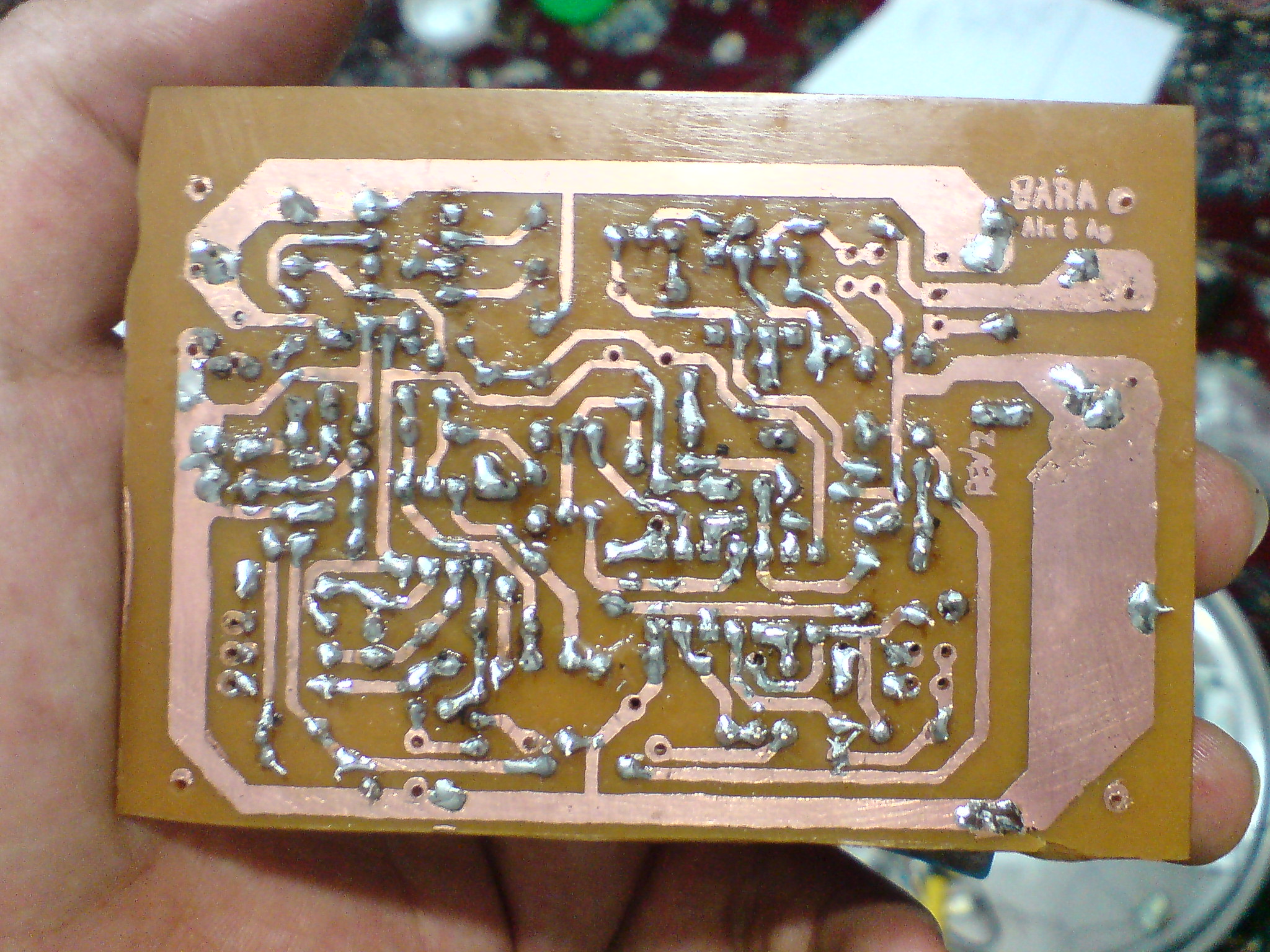

                          • Check possible short circuit in the welds.
                            • thanksbut i dont know how can i connect them to wire,if you can design for me in paint
                              • It might be best to look up each part on google, then learn to wire them. Start with something simple like the speaker or 12v plug, then do the potentiometer, then the stereo headphone jack with switch.
                                Your headphone jack may be different, the rest is clearly visible and labeled for you in the picture.
                                Get to work, you could have it done before somebody draws you a picture.
