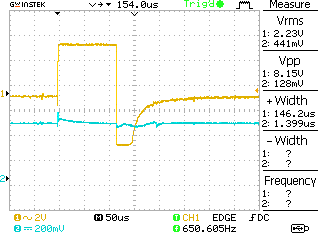

          but i can noy set pin6 5534 on 0 VAC.
          look pic under
          pin1 lf412cn and 5534-6
          another pin2 40106 and 5534-6

          • Let me think about this...
            Please put your oscilloscope on DC coupling and please LEAVE IT THERE. I was right when I told you that in a PM. Ignore anybody telling you you need the scope on AC coupling. That is a bone-headed idea.
            Why didn't I think of this yesterday... if you were nulling an IB coil then you could use AC coupling, but you are not. Use DC coupling when you are attempting to null a DC voltage. You cannot do it the other way.

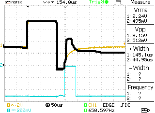

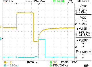

                    my friend i think my problem in pin6 ne5534.
                    i can not set 0volt by pot 25k , why?i use pot 1k ohm 3 watt to find the best set point .
                    when coil voltage near 70 volt , pin6 ne5534 is 0.13 volt and can not set it.and when i return the pot this voltage goes higher near0.4volt ( my means ne5534-6).AND LARGER out put voltage that i can see in the oscope is near 140 vgolt , i use irf9640 and tip127 and both of them are same voltage
                    the important thing that when i measure coil voltage by multimeter , it is between 0.02 volt and 0.35 volts (correct voltage is 2.9 volt tht says Apberg)
                    summary :
                    i think this wave should like under pic ,please tell how i adjust like it:

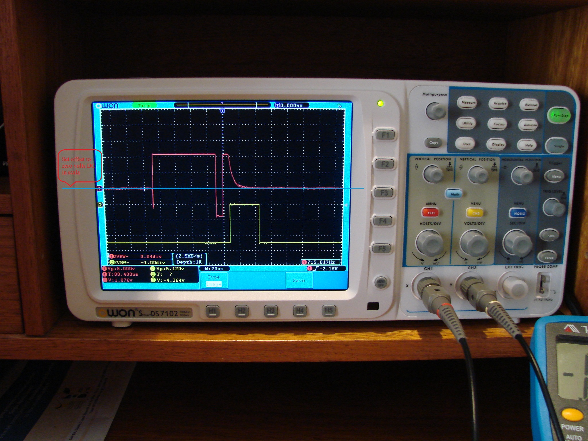

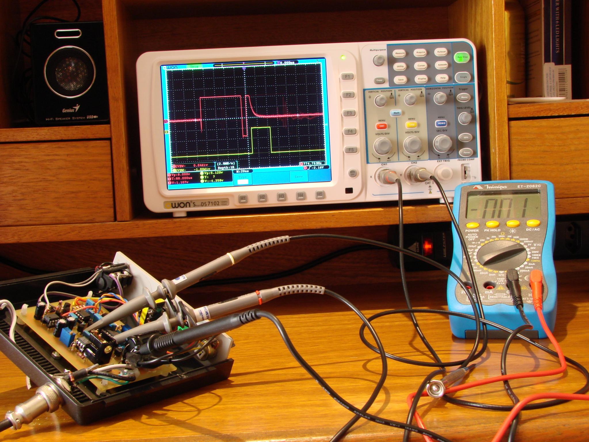

                      • Mohandes Hello, I'm sorry I made a mistake in stating for you to use the channel of the oscilloscope in AC. I use DC Corrigo I unfortunately can not edit the text after a while.
                        I usually use the oscilloscope to almost all measurements, follows a photo offset adjustment marked with a blue line. I make mistakes anguns using the translator because I do not speak English.

                        • Wilson, I don't know if you want to read this or not, but I think your scope display indicates a problem. Look at Mohandes' scope shots in #904. That is more like what your rx should look like. Problem is, I do not know what you need to do to fix it.
                          Q: What was wrong before, why did you replace NE5534 with OP27??
                          Mohandes, 904 is almost good (flyback is really slow but at least the rx amplifier is not ringing). You do not want to have what you drew in 909.
                          • Porkluvr Olá, eu tenho que ajustar o resitor Damper para corrigir ok.

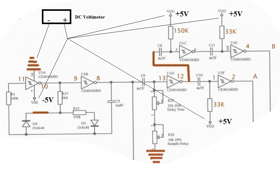

                            • Hello Mohandes, in post 909 which peak value of the pulse delay "blue". What was the scale division you used channel 2(X10 ou X1) "200mV or 2V", this pulse delay has to be around 4.5 to 5 volts peak. On the side of the screen of the oscilloscope indicates Vpp channel 1 8.15 VPP OK. Channel 2 512mV is not the correct value is close to 5Vpp. Check the IC CD40106 and its connections.
                              • Hello Mohandes, delay pulses 1 and 2 are really 512mVPP with the Q3 and Q4 fets no commute and no signal passed to the next stages. May be the cause of the lack of sound. Check the voltages as shown below if it is correct replace the IC CD40106.
