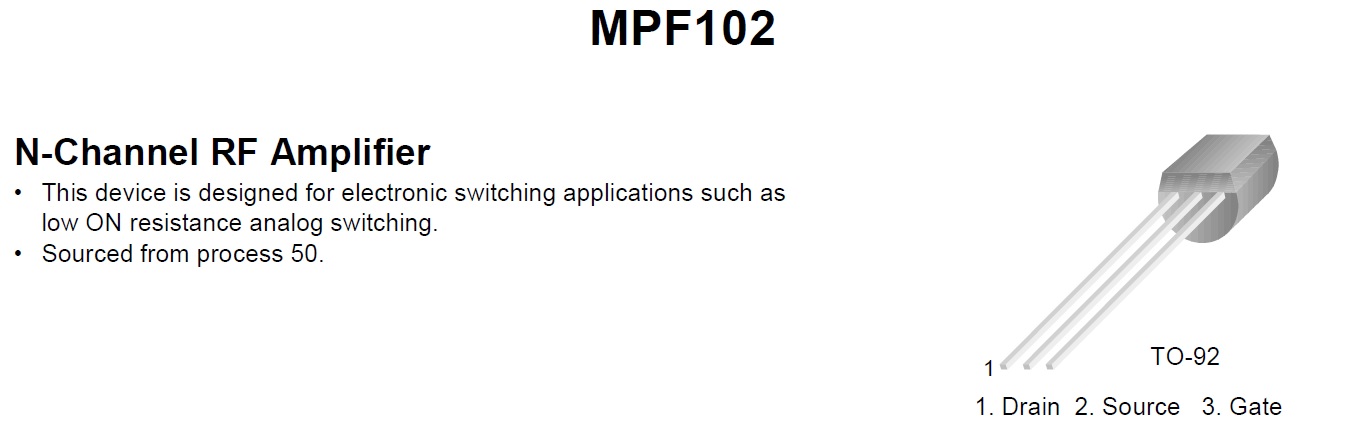

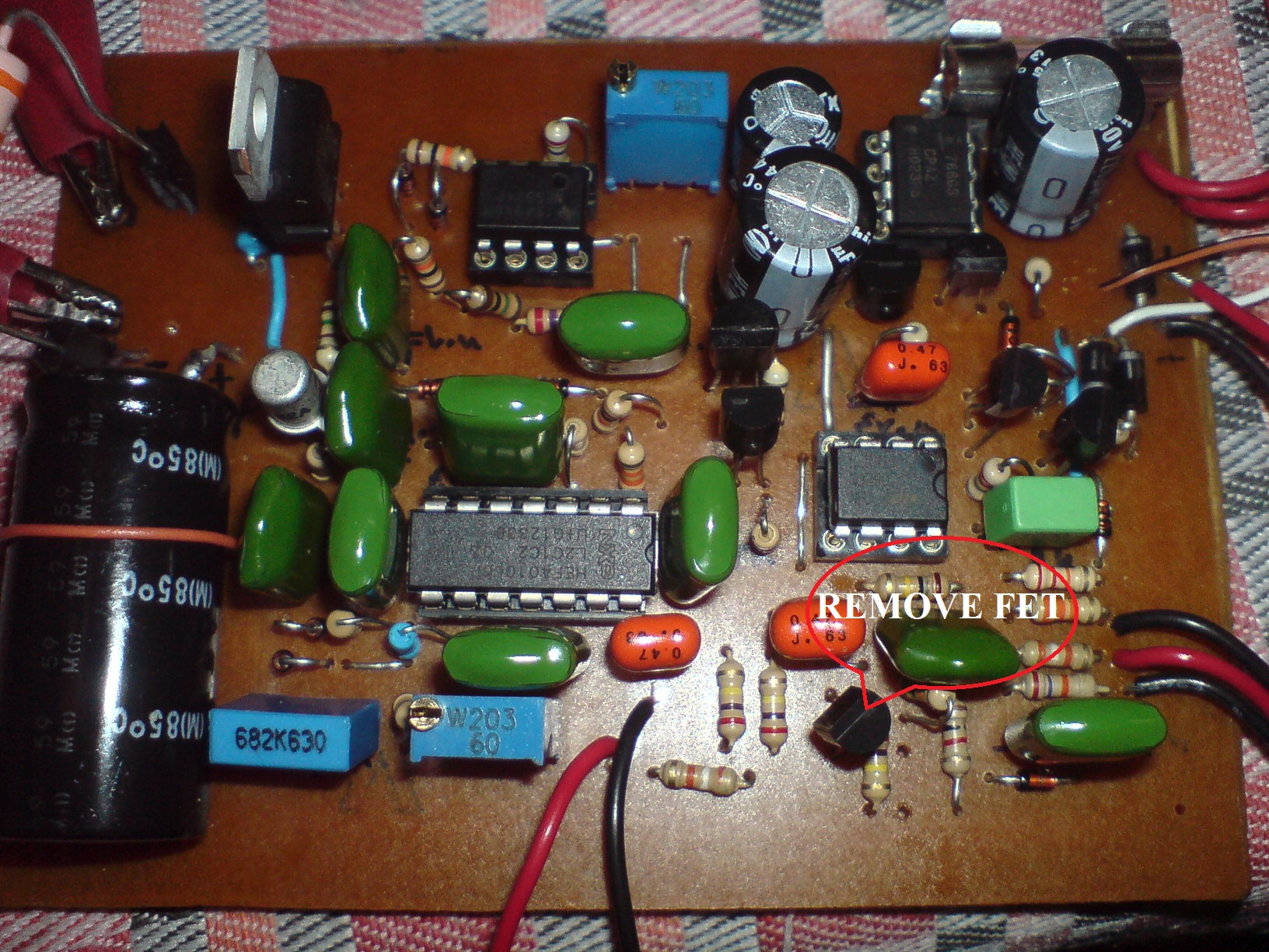

                • Hello Mohandes, remove the fet shown in the photo, it will work better.
                  • Hello Mohandes, here in Brazil is easier to find the fet fet BF245C I replace MPF102 and 2N5485 for him, careful pinning it should be welded with 180 degree rotation.

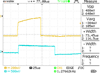

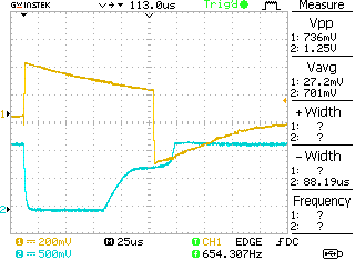

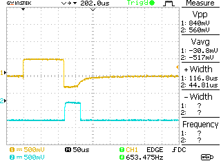

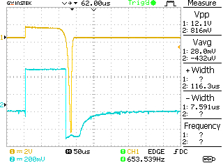

                      • Hi all
                        i upload my pics about the baracuda.help me.why not have sound in my detector.
                        i replace all mpf102 to bf245b.
                        and use bf256 instead 2n5485.
                        i use coil 451mkh and 2.2ohm.parallel res 330ohm.
                        i think pin 6 ne5534 not good(can not detect)ok?????????
Name:	pin8 40106 & pin2 Q3.BMP
Name:	coil trans & pin6 ne5534.BMP
Name:	pin2 Q3 & C16(between 39k and 1000pf).BMP
Name:	pin6ne5534 & pin2 40106.BMP

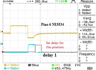

                        • Hello Mohandes, adjust the delay as pictured.
Name:	pin6ne5534 & pin2 40106.jpg
                          • [QUOTE=Wilson;176978]Hello Mohandes, adjust the delay as pictured.
                            thanks wilson
                            i do that but yet have problem ,have not sound!!!
                            mr Apberg say(many ago time) should adjust pin1 lf412 on 0volts.but how i can this?
                            i think wave for ne5534 not true?is it ok?
                            • Hello Mohandes, you must adjust the zero on pin 6 of the IC NE5534 and not in the LF412 pin 1, the adjustment should be done with the coil connected and away from metals. Adjust the trimpot ofset IC NE5534 with a multimeter measuring AC in scala pin 6. You can also use the oscilloscope, centralizing the cycle positive and negative, that does not mean that the pulses from pin 6 to disappear.
                              • Originally posted by Wilson View Post
                                hi wilson
                                thanks , i try too that but in AC show 0.75volts and on DC 0.335 volts (not change value on ac or dc points when i measure by multimeter)
                                why do put on AC point the multimeter and not DC point?!!
                                regards man and sorry me.
