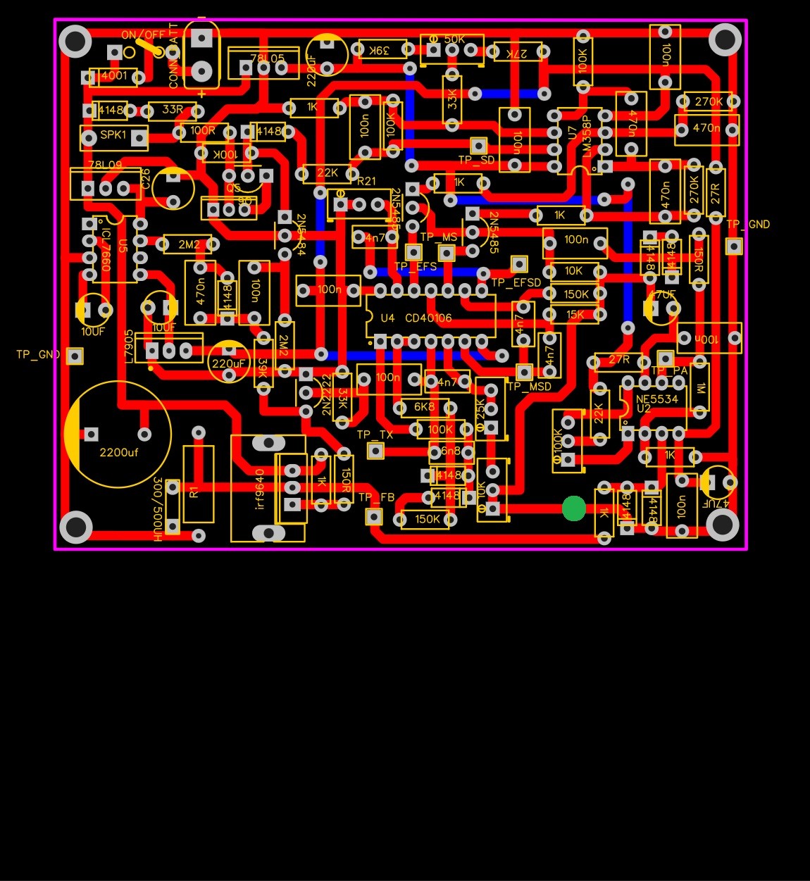

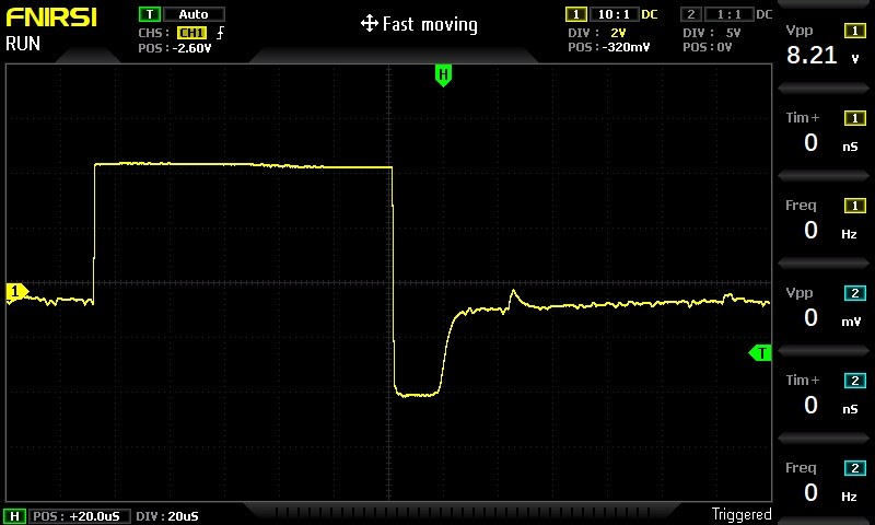

      I made this new pcb to add cermet resistance to control second sample ,and i hade this problem i dont know from where it come but i think its from +5v i change all components but nothing change

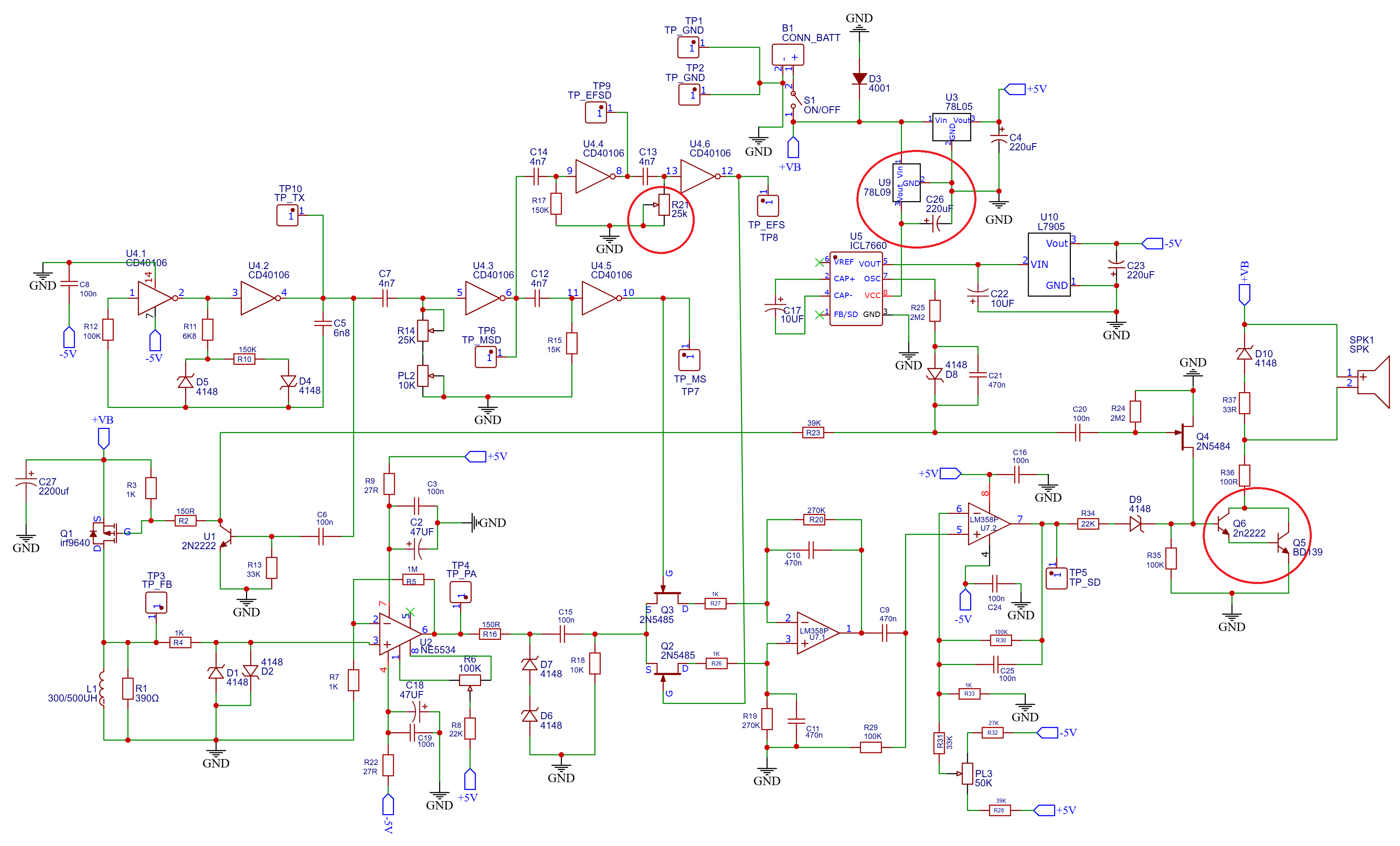

          the schematic is geotech rev A
          i modify little things highlighted in this picture

          • Hello Deghbar613
            I've taken a closer look at your schematic. It seems to be correct. I couldn't find any errors. I suspect the problem lies with the NE5534 IC chip, its socket, or one of the traces around the NE5534 on the board. I would first check the socket and all the traces on the board for continuity with a multimeter. There might be a small crack somewhere. If everything is okay, I would try replacing the NE5534.​​
              Hello Deghbar613
              thx GeoMax
              i found the problem
              but i solve only half of it
              when i change GND pin of coil close to ne5534 to green dot highlighted in this picture
              thats the resulte
              i know is not perfect output of ne5534 but is better
              i want to know what the cause of this problem
              i am sorry to bother you mr GeoMax

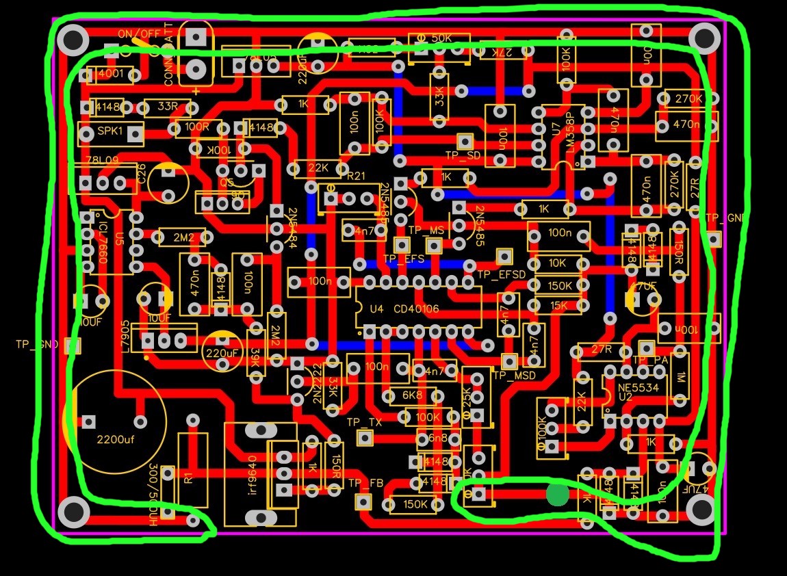

                  • Hello,
                    I've looked at your ground trace on the circuit board. You've created a nice loop antenna there, likely picking up electromagnetic interference. That's why the signal isn't clean.​
                      Hello,
                      Can you show me where ?
                      and how to make good ground
                        This is not an optimal arrangement for a ground wire, especially considering the placement of some components. Ideally, the coil connection points should be routed as close as possible to the capacitor (2200 µF) and the MOSFET (IRF9640). The 1 kΩ resistor on the NE5534 should also be placed close to the junction between the IRF and the coil lead. Position the NE5534 and the diodes near the 1 kΩ resistor. I would also connect the damping resistor directly in parallel with the coil lead.

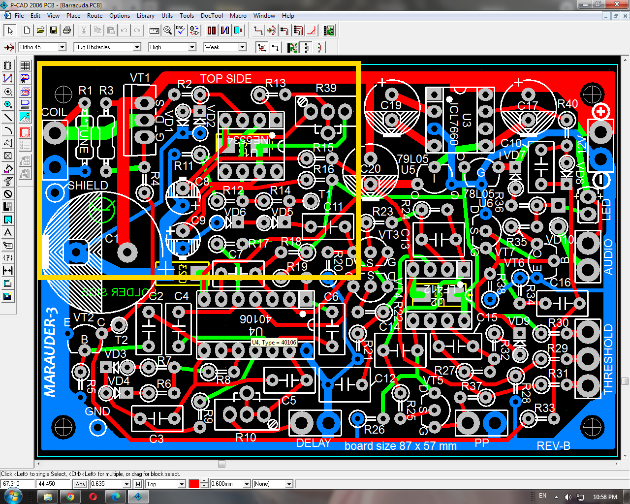

                        • Deghbar613
                          Below is an example screenshot of one of my MD PCB designs. The red rectangle shows the placement of the large capacitor, the MOSFET, the damping resistors, and the NE5534 receiver circuit. All components are placed close together and not spread across the entire PCB. Maybe this will helps.
Name:	PCB Placement (1b).png

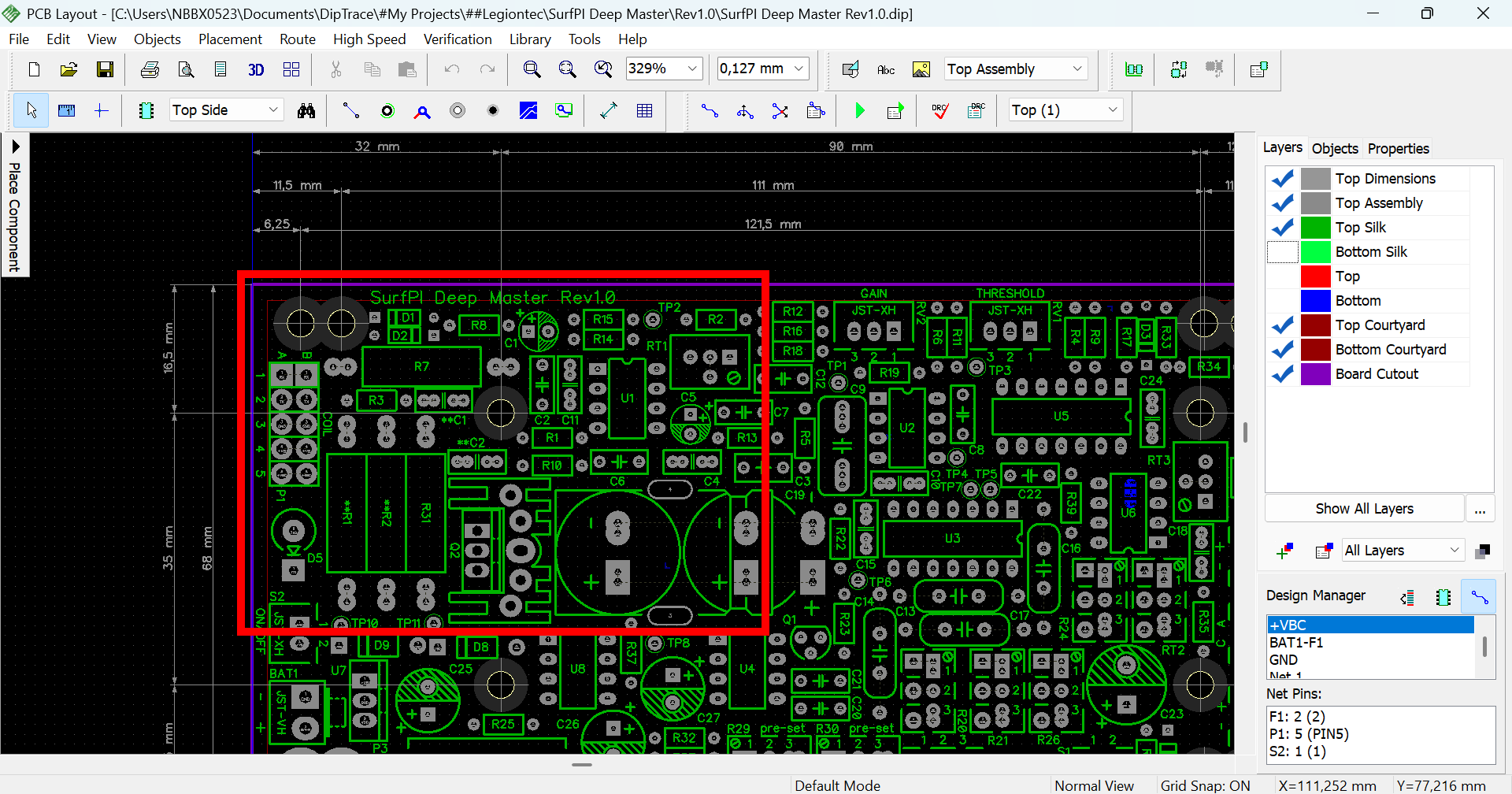

                          • gnd blue color

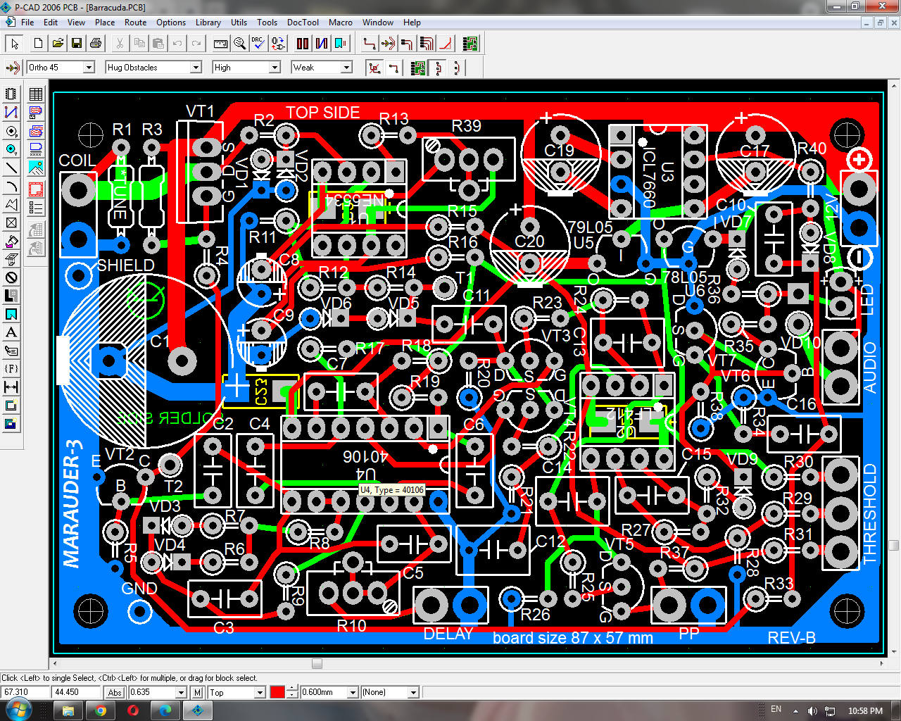

                            • Hi Deghbar613,
                              as you can see KT315 placed the components in a very similar way on his PCB like I did. All are placed as close as possible to each other (see orange box).
                                Hi Deghbar613,
                                thx for help now everythings work great , the problem was R7 must be close to the coil
