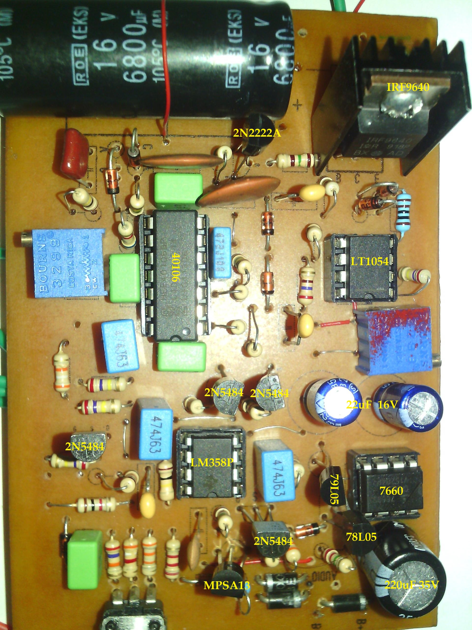

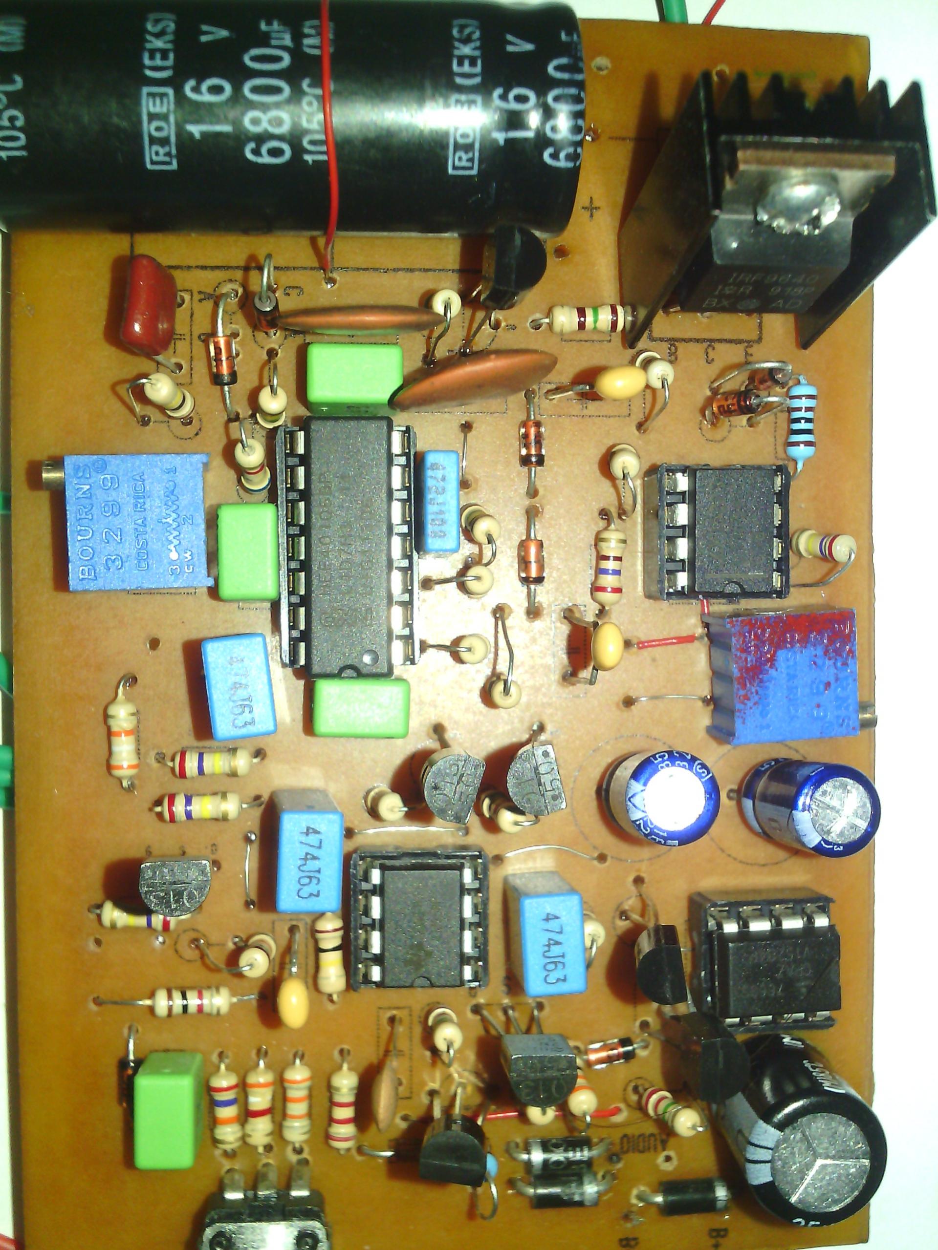

      [ATTACH]43357[/ATTACH]today i put together this bara (my first MD ever) and it did not even make a sound. coil 0.25mm 18cm 32 turns. Power 12V DC (two 9V batteries reduced to 12v).
      [ATTACH]43356[/ATTACH]
      [ATTACH]43355[/ATTACH]
      I suspect you populated the whole board at once, and then switched on ... hoping it would work first time.
      With a new project you should always populate the board in stages, testing each part as you go. You will now have a really difficult task debugging this, especially if you don't have access to an oscilloscope.
      • I tested it for first stage and it gave +5V so i was happy and today being a major festival holiday worldwide i decided to proceed as quick as i could. I have both multimeter and analog oscilloscope 20MHz. I tested each component prior to soldering. I share a better pic from right above to show what went where.Click image for larger version
        • The holes there are for switch and i soldered the wire for the switch from bottom side of the board.
          • Originally posted by chuubaba View Post
            I tested it for first stage and gave 5V so i was happy and today being a major festival holiday worldwide i decided to proceed as quick as i could. I have both multimeter and analog oscilloscope 20MHz. I tested each component prior to soldering. I share a better pic from right above to show what went where.[ATTACH]43358[/ATTACH]
            In that case you will need to debug the circuit logically, starting from the power supply, and then test each stage for correct operation. Please don't do what other newbies tend to do, and start randomly replacing components based on guesswork, or frantically resoldering every connection.
            At the moment the fault could be anywhere, so check things in order:
            1. Power supply.
            2. TX oscillator.
            3. Preamp.
            4. Sample timing pulses.
            5. Sampling integrator.
            6. Second integrator.
            7. Audio stage.
            Somewhere along the line you'll spot the problem.
            There's no point jumping straight to the audio stage if (for example) the TX oscillator is not working.

                    I HAVE HIGHLIGHTED THE VALUE OF COMPONENTS FOR THE EXPERTS TO SEE IF THESE ARE CORRECT. MY DOMESTIC EXPERT HELP IS NO MORE AVAILABLE S I AM ALL ON MY OWN TO PROCEED. I WILL MOVE TO DEBUGGING (OR WHATEVER) AFTER THIS Click image for larger version
                            Why don't you look into this and advise. My domestic help used some alternatives for ICs TRANs and CAPs while other comps are as listed in BOM. Could this cause malfunction etc?
                            You cannot identify the problem by guesswork. Logical debugging is the only option.
                            Firstly, is this design based on the Geotech Baracuda, or some other alien version?
                            If it's not based on the Geotech Baracuda schematic, then there could be a whole host of other issues. Read the Build Document to understand the problems that exist with the original design, and then you'll see that you may even have components that have failed.
                            Start with the power supplies (+5V and -5V). Are these the correct voltage?
                              You cannot identify the problem by guesswork.----
                              I GOT THIS FROM THIS SITE. IT SAYS "REV 2" ON COPPER SIDE. MY HELP MADE THE PCB AND DRILLED etc IT
                                In that case it probably contains all the original design errors. Can you post the schematic?
                                Also, have you measured the power supplies (+5V and -5V)?
