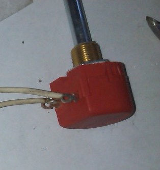

        • Wakko, you don't have to apologize to me. You would find out soon enough about the differences (ummh, they're both N-channel FETs but that is where most of the similarities end).
          Mohandes, you must get rid of the 2.5k pot and select a fixed value resistor. A potentiometer rated for 1W (for instance) can not survive for long if the wiper is turned to only 25% when that 25% section is forced to dissipating 1W. The 1W rating is meaningful only when the entire resistive material is used.
          In other words, if you were to use only a 25% section of the pot's resistance and then dissipate 1W in that 25%, you will have overstressed the pot by 4X! When you overstress resistive material it will change value (often dramatically, or just go open circuit.

            • thanks Mr Porkluvr and Toros
              i use this pot Click image for larger version
              i chage it by 330ohm 2w.

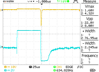

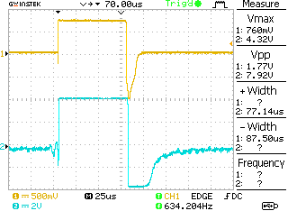

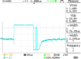

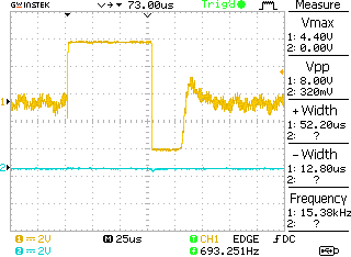

                Mr porkluvr and Torros
                i dont know why i have not the same like
                look my pics and i use 330ohm 2w
                first channel yellow another is blue wave
                ne5534-3 ,ne5534-6
                40106-2

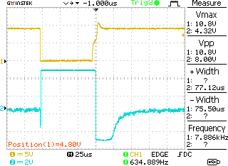

                2n2222
                and the final is inceridble when my fingers parallel to the R parallel the coil have a this shape , why??

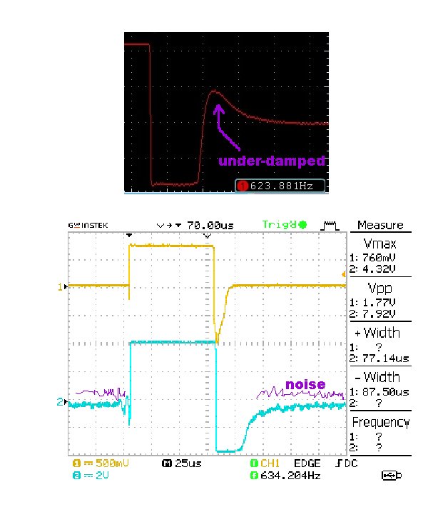

                • The picture you are comparing your waveforms to indicates an under-damped condition (damping resistor too high).
                  A small amount of under-damping is nothing to worry about, however the under-damping in that picture does appear to be excessive.
                  Your NE5534-6 shot shows -maybe- (and only maybe) some over-damping (damping resistor perhaps slightly too low). The best way to know if it is over-damped is to compare that waveform with what you get with a higher value resistor.
                  Try a higher value damping resistor, maybe 360 or 390 ohms. Keep going higher and higher until you see a slight upward hump develop (indicating a slightly under-damped condition). You would want to either keep that resistor, or go back to the previous, lower, value. Choose whichever damping resistor gives the best sensitivity.
                  Also, you have noise and it looks excessive but I have no way of knowing for sure. If you have another NE5534 you could swap it in and see if it makes any difference.
                  When you stick your finger next to the damping resistor, you add capacitance to the circuit which upsets the circuit. Why would you want to do that?
                  I have a request. Would you please refer to the damping resistor as "damping resistor", instead of calling it "resistor parallel the coil". We know what a damping resistor is. Quit babbling.

                    i put more res ( damping res ) but all time i have not same wave like wilson or i have not never over damp and under damping.

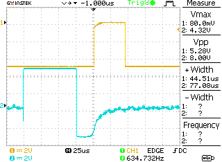

                    look when i add the damping R my wave like this and i have not over damp

                      It looks like you went from "maybe OK" to "very bad". Put it back the way it was.
                      I think you will never get good sensitivity with OP27.

                          Comparing DS0008.bmp in #1042 with DS0010.bmp in #1044, you, and only you, know what you did to make the change. That is what you need to undo.
                          I did not tell you DS0008 was bad, I said that it might possibly be improved. But then you broke it and just want to cry about it?
