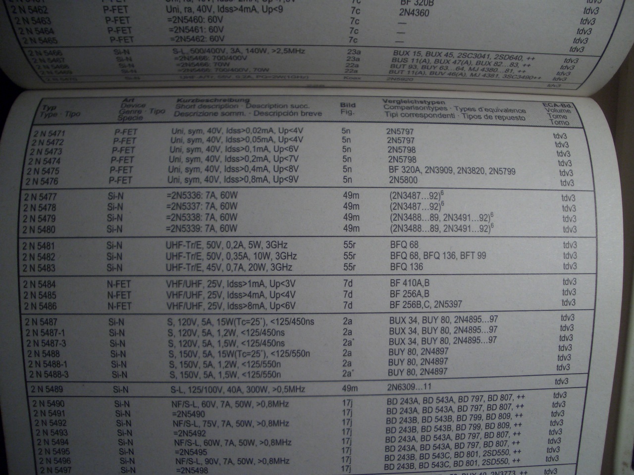

                      • Qiaozhi, I had a look at alltransistors.com and most of the equivalents are hard to get hold of at a reasonable price. Strangely it didn't bring up the 2SJ113 but it seems a close match, maybe I missed something, I'll doublecheck!
                        Alexismex, I've looked on ebay and the 2N5485 doesn't actually appear that many times and most of ones that are listed are at a ridiculous price. I'm not paying over £1 each for a FET, especially as I'll probably need a lot in order to match up a good pair. I have found a seller asking $6 for 10 which is a good price so I might go with that although the 2SJ113 at £0.18 might be worth a try to.
                        • There is a HUGE difference between J113 and 2SJ113. Why don't you search their datasheets and see for yourself?
                          • George. open this pic, this is equivalents.
