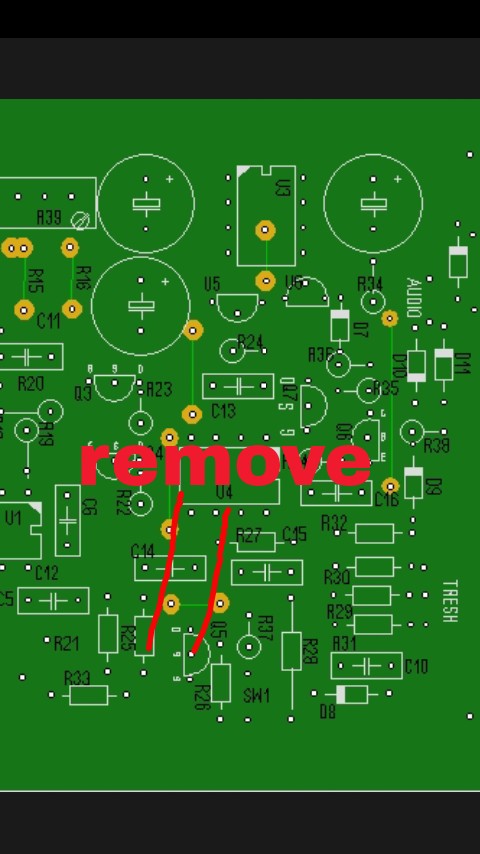

                    • Q5, R25, and R37 are supposed to omitted. My question is where exactly on the board are they "supposed" to go. I've been looking through this entire forum giving myself a headache trying to figure out which component they are. Any help would be greatly appreciated. I've looked over the schematic about 12 times and can't figure it out. I'm good at soldering and wiring, not so much in electronics.
                      • Originally posted by lzwillis View Post
                        Have you looked in the Projects section? -> Baracuda PI
                          • I got the silverdog baracuda kit, so the picture is not what I am looking at. Thank you for the help though.
                            • Thank you, I didn't even know there was an entire section directed for to the building of this board.
