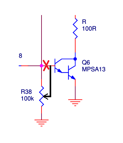

  • Originally posted by sukri01 View Post
    Anyone can tell how to add volume control here, thank you.
    add a 1k log potentiometer in line with one wire frome the speaker
    • Or this Click image for larger version
      • Ok thanks a lot..
