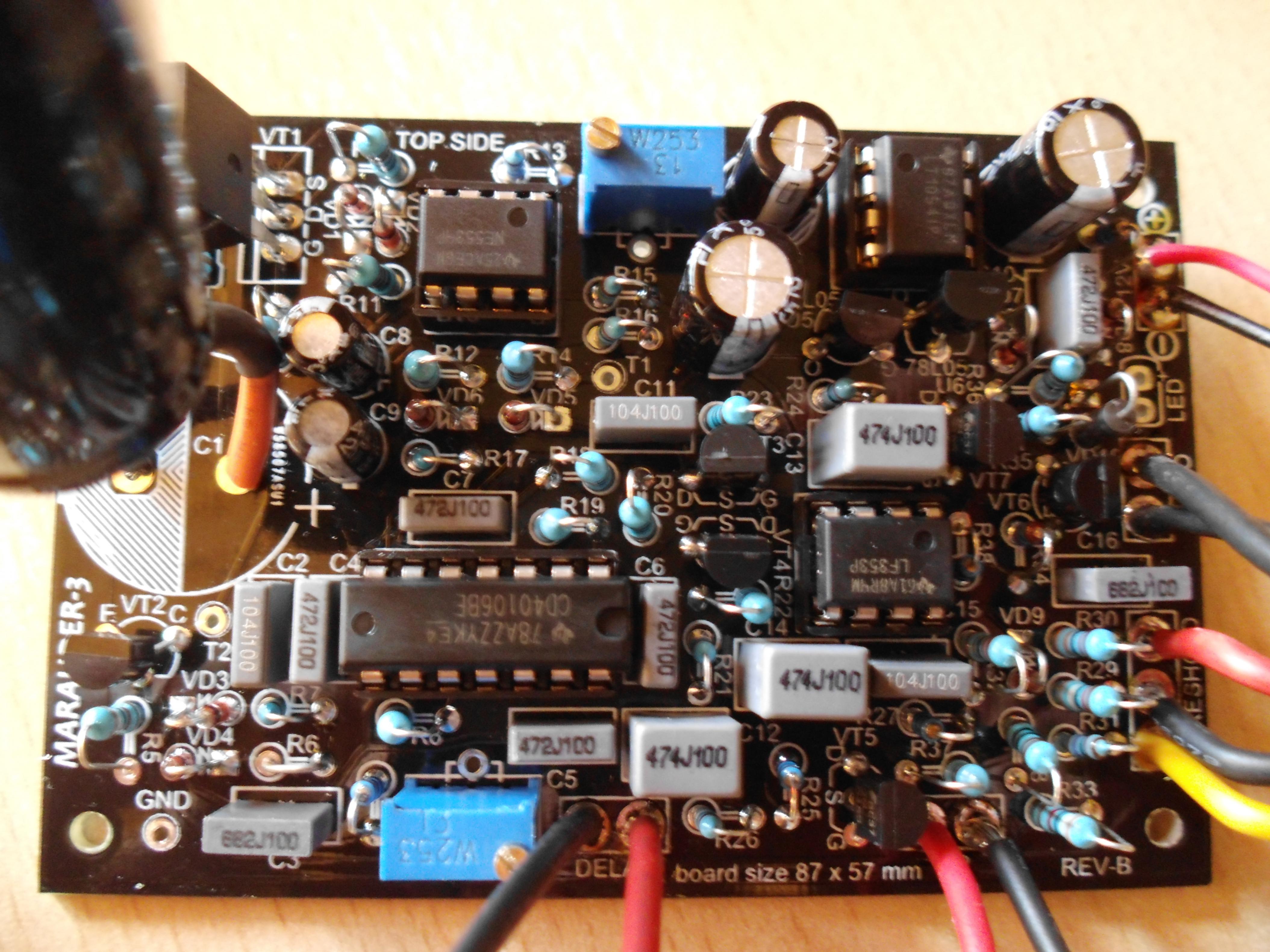

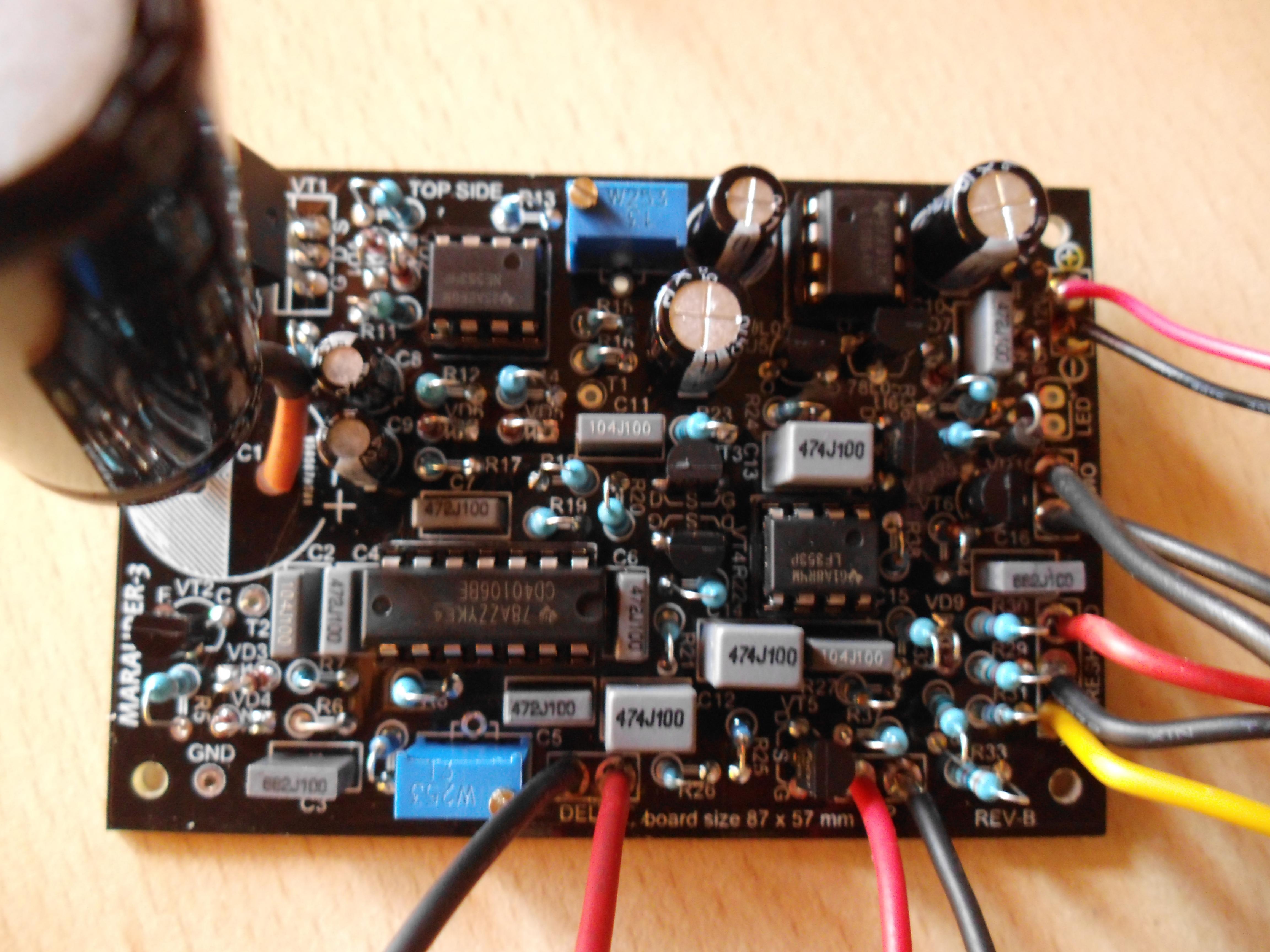

    • no second trimmer. THRESHOLD is a pot on housing panel.
      bara has two pots outside - thres and delay.
      • R10 and R39
        R39 -> for the 0V
        R10 -> I dont know -> (PDF said adjust till i get -2.1V at Pin1 U2 DC (Rev-A))
        I have adjusted it now by testing with a gold ring and a euro.
        I got about 20cm for the ring and 25cm with a euro with a testcoil from my Pirat Pi (290uH,15cm dia.)
        • R10 is preset for STROBE DELAY. you do not tune it without o-scope. set it in middle position and forget.

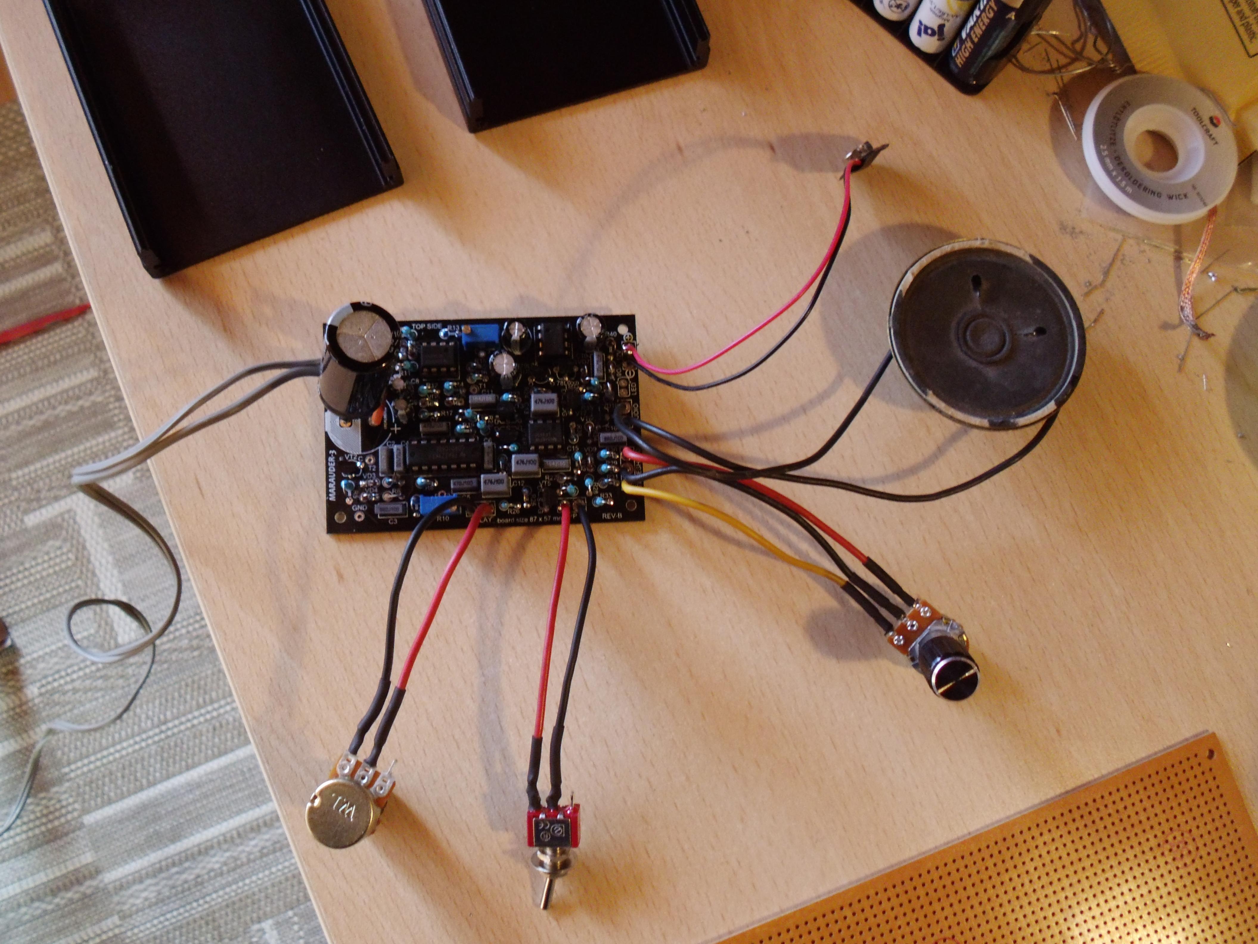

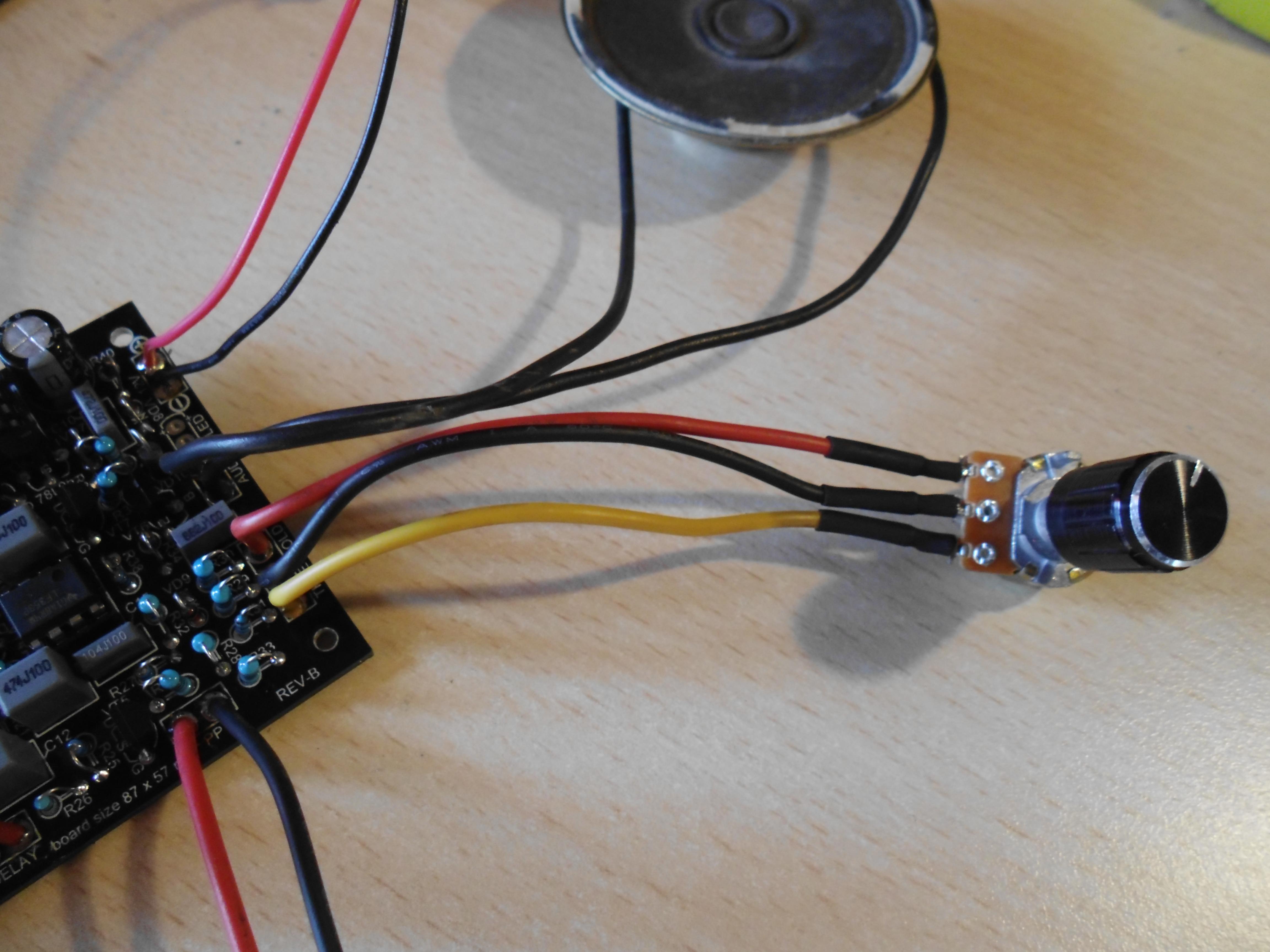

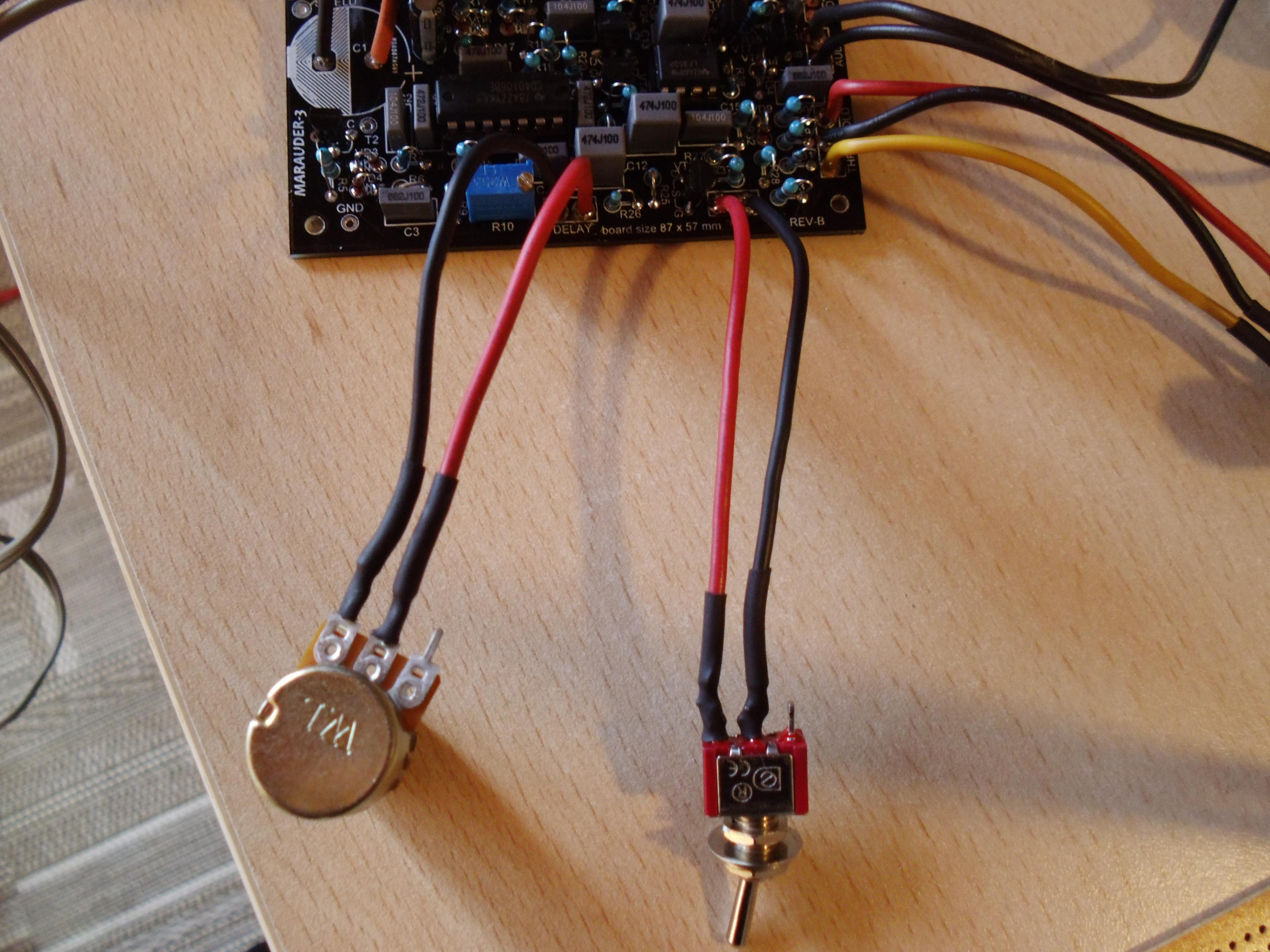

            Can you tell me why i cant use the PP switch? When i move the switch i have a steady tone and i cant detect anything.
            • few pics of your board will make my day.
              • Sorry , the battery of my camera is empty.
                I have an on/off switch at the "PP" Board connector.
                My upper trimmer is in the other direction than in this video:
                https://www.youtube.com/watch?v=gTEED-2Z_lM
                Also my Thresh Pot is in other direction.
