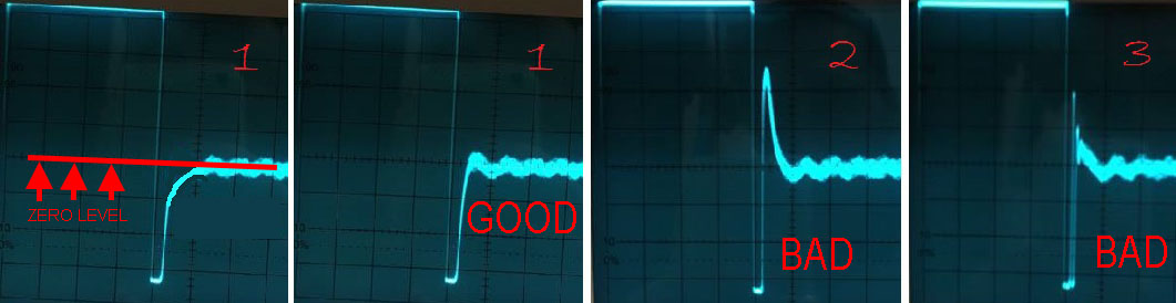

                    • I have a problem with the adjustment of my Trimmers.
                      Can somebody tell how i need to adjust them?
                      I saw in the PDF that i need to bring the voltage at pin6 of the op amp to 0V and then i need to short the delay pot and
                      measure the voltage between gnd and Pin7 of the same op amp.(LF353). This voltage should be -2,1V.
                      But i tried this and the voltage doesn't change.
                      Its the kt315 Rev-B small board.
                      • Try grounding the other end of the pot.
                        • I have desoldered the IRF . Then i realized that i need to measure at pin1 instead of pin7.
                          I still cant change the pin voltages with the trimmers.
                          I have two testpoints at the trimmers i can measure a changing current there.
                          Do i need to get -2.1 V? and where?
                          Which Pot do you mean? Delay?
                          • Grounding Delay pot doesnt change anything.
                            I tried to adjust the 0V at the wrong op amp.
                            But i still need to find out how to bring the other one to -2.1V and which pin.
                            My Pin1 is about 600mV and i can change it with the trimmer but not to -2.1V.

                              Originally posted by BKY1337
                              Originally posted by kt315
                              you have to get zero voltage (balance) on U1 pin6, output, or Test point 1 by tuning of R39 trim.
                              Yes , i already did this without IRF. But i need to know how i tune the other trimmer.
                              My Pin 1 (U2) shows me about 600mV and i can turn the lower trimmer until i get 250mV or something like that.
                              But not the wanted -2.1V.
                              Do i need to get -2.1V?
                              i say you again - you need o-scope in your kitchen room. you operate by categories that i do not use and
                              ask me HOW to measure AC signal with EMI noise in your home by chinese multitester.
                              YOU HAVE TO GET THE ZERO NULLING IN POINT T1. why you ask me about DC voltage on U2
                              if you have to get ALL AUTOMATICALLY. no more adjust in this primitive schematic.
                              • zero level Click image for larger version
