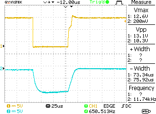

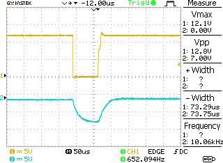

      it is a COMIC mistake . i wrote in my resistor box 1K , but inner it 10k !!!!!!!!!!!
      when i soldering dont attention to them/
      now my detector work but in Gate Q7 yet have near 7 volt
      the sounds is good
      but detection is bad

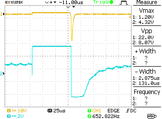

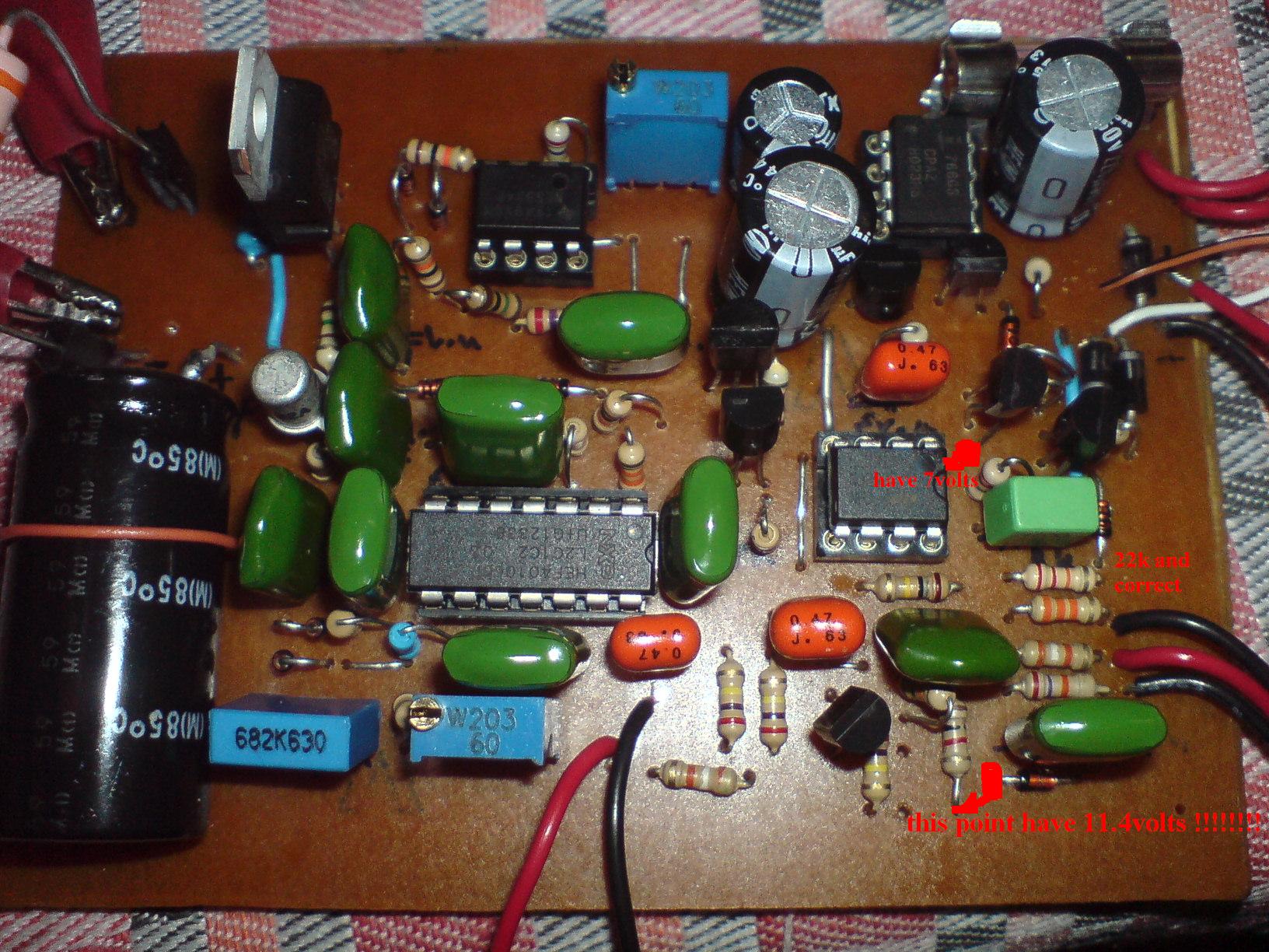

      i take photo and put for you
Name:	Copy of DSC01736.JPG
      and look the another
      many thanks
      • BUY
        hemmmm
        thanks all

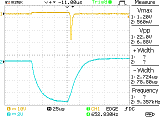

        know the GATE OF Q7 better (3volts up and become 10.1volts)
        I REPLACE IT BY BF245B AND BECOME Ok
        look :
        now i find the coin (under pic )in 10 cm and when detect the sound not continue and say BIP and nothing ,,,,ok?

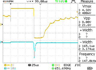

                for last request
                teach me for find best r parallel to coil,i have pot and an set it but i dont know which R is best regards.
                i can detect the above coin near 20cm.
                thanks

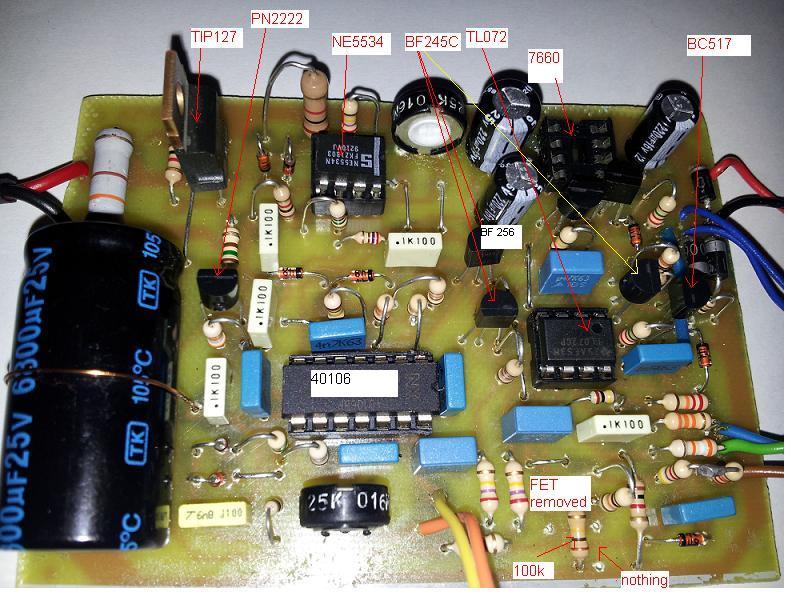

                  MY friend i think you see my different figure in pin6 ne5534 to your figure check these :
                  and my low detection UPSHOT this pics(dont like your pic)
                  I think the problem in mpsA13
                  can you send me value and pics about bc517???
                  can i replace it by bc337 or mpsa25
                  thanks and sorry me

                              • Mohandes,
                                Typically, the resistor is 330 Ohms. Contact oscilloscope to pin 6 NA 5534. Instead resistor 330 ohm put resistor 220 ohms in series with potentiometer 1 kilohms. Potentiometer is placed in position - max. Begin to reduce the value of the potentiometer until the oscilloscope signal is clear and no parasitic peaks. Measured values ​​of the pot and add to it 220 ohms. You'll get the value of the resistor that you care. Change resistor 220 ohm and potentiometer with another resistor, which has an estimated value of you. You're ready!
