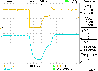

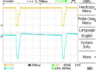

BARACUDA-Legend-1

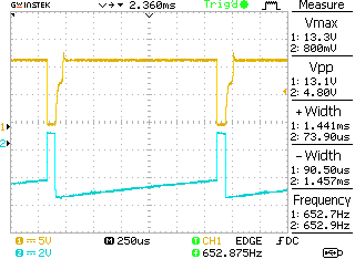

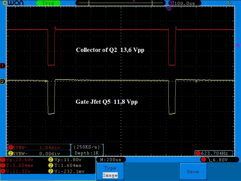

  • Mohandes, check the waveforms in your circuit ok.
ID:	337764Click image for larger version
ID:	337765Click image for larger version
ID:	337766Click image for larger version

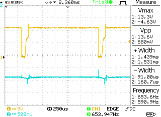

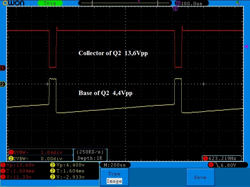

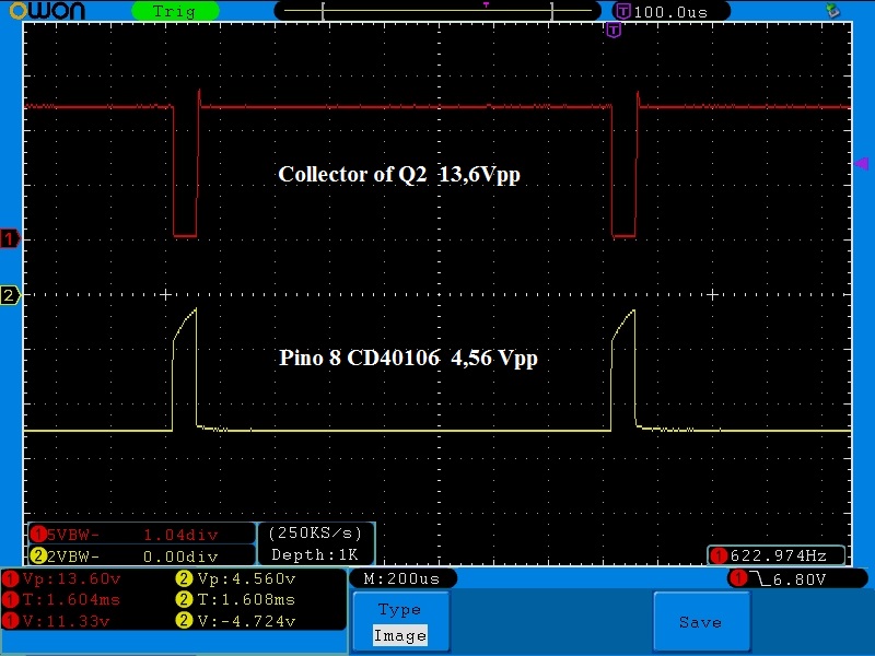

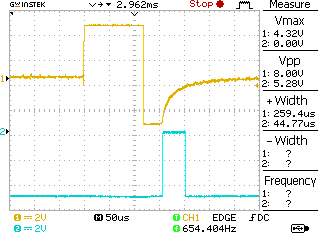

    • Hi mr wilson
      ok,i put for you all waves BUT you say REMOVE THE Q5, so for your request i solder it in my board and then measurement all:
      see waves like you to COLLOCATION :
      hemmmm,Q5 no have no signal maybe have problem , any idea??

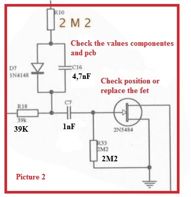

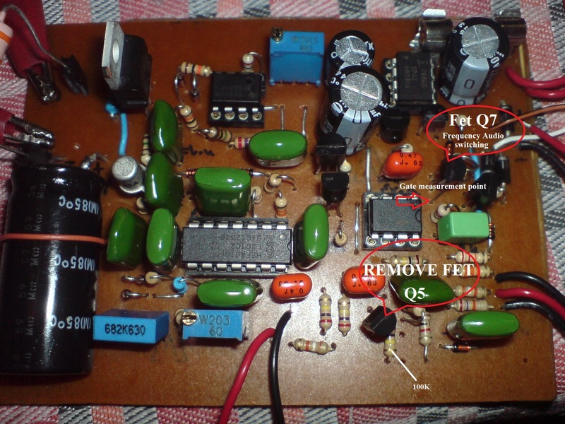

      • Mohandes Hello, I'm sorry, the forum has different schemes using or not the fet with SW1. I consulted the scheme that does not have this fet but your PCB uses the Q5, I asked to remove the previous post. In the picture below I explained correct.
        The pictures I posted # 976 I missed in naming Q5, Q7 is correct.

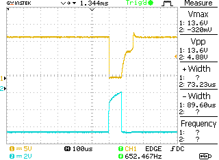

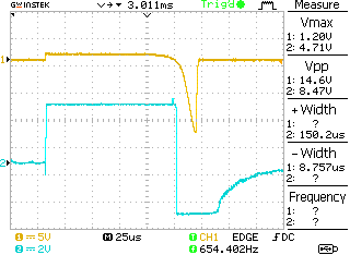

        • I find error guide me please
          ok
          i think this error in Q7 look the pic. please tell me where is my error ?? i use bf256 but i have another equivalent transistors like :BF256b , BF245b , 2n3819 .maybe this error for my equivalent or no , so where?
ID:	337791Click image for larger version

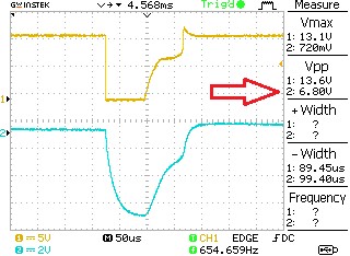

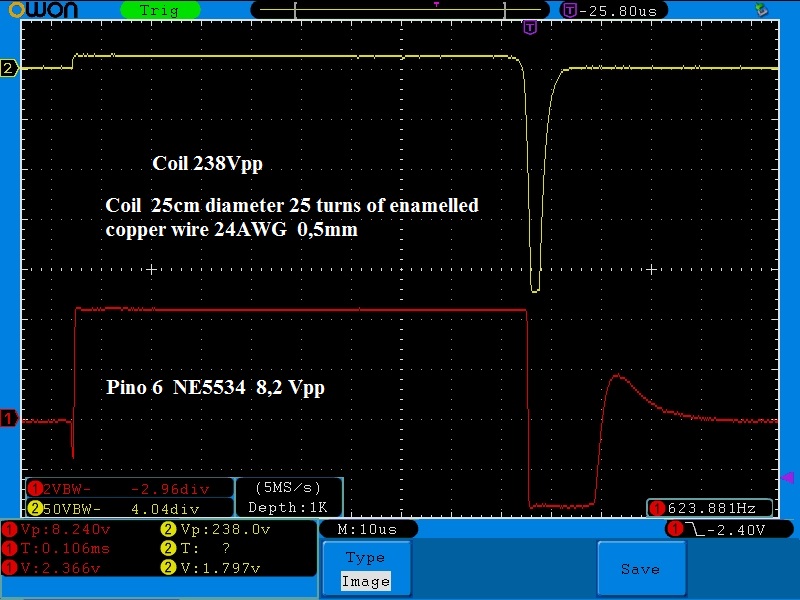

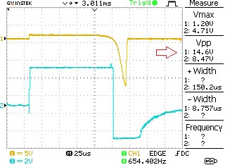

          • Hello Mohandes, the voltage at the gate of Q7 is below the voltage in my circuit, check picture as below.
            The tension of this coil is low, check your coils or mosfet.
ID:	337793Click image for larger version
Name:	Barracuda_mod pimpointer.jpg
ID:	337796Click image for larger version

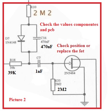

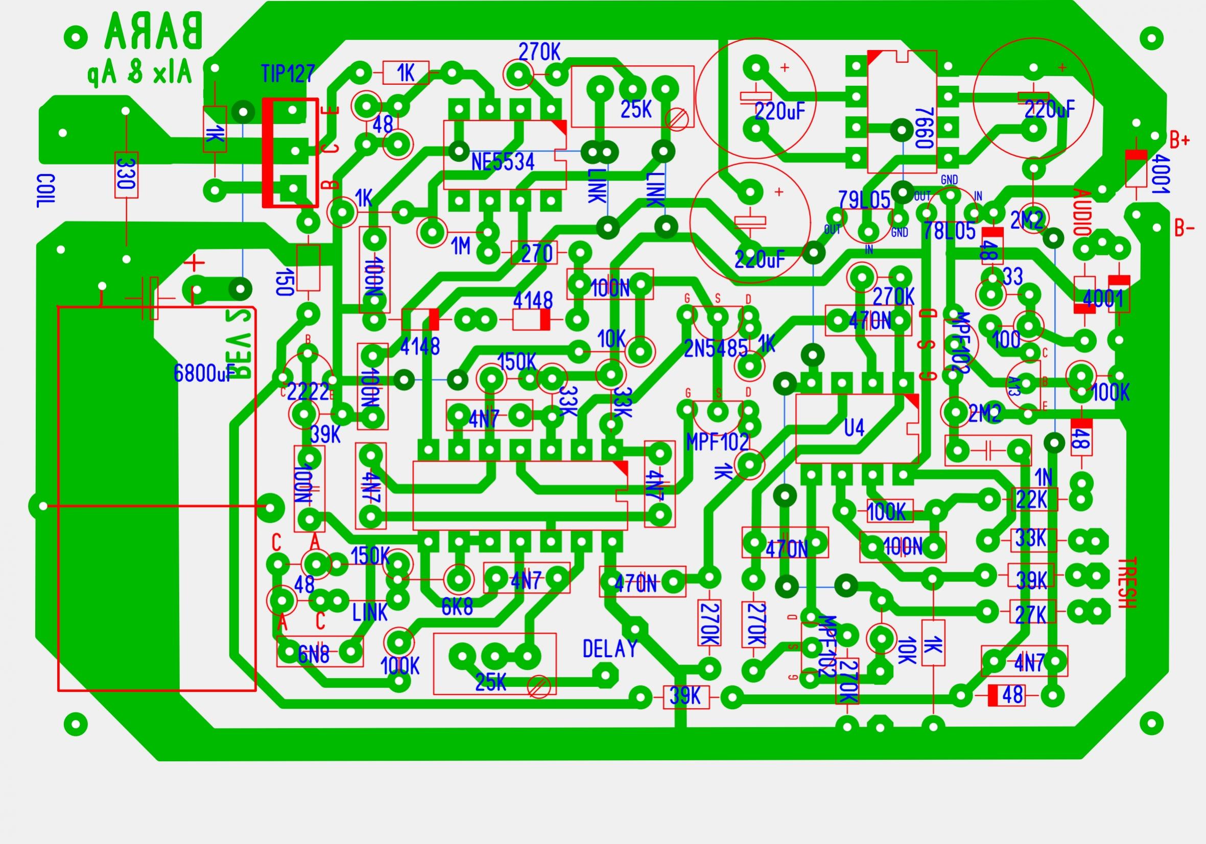

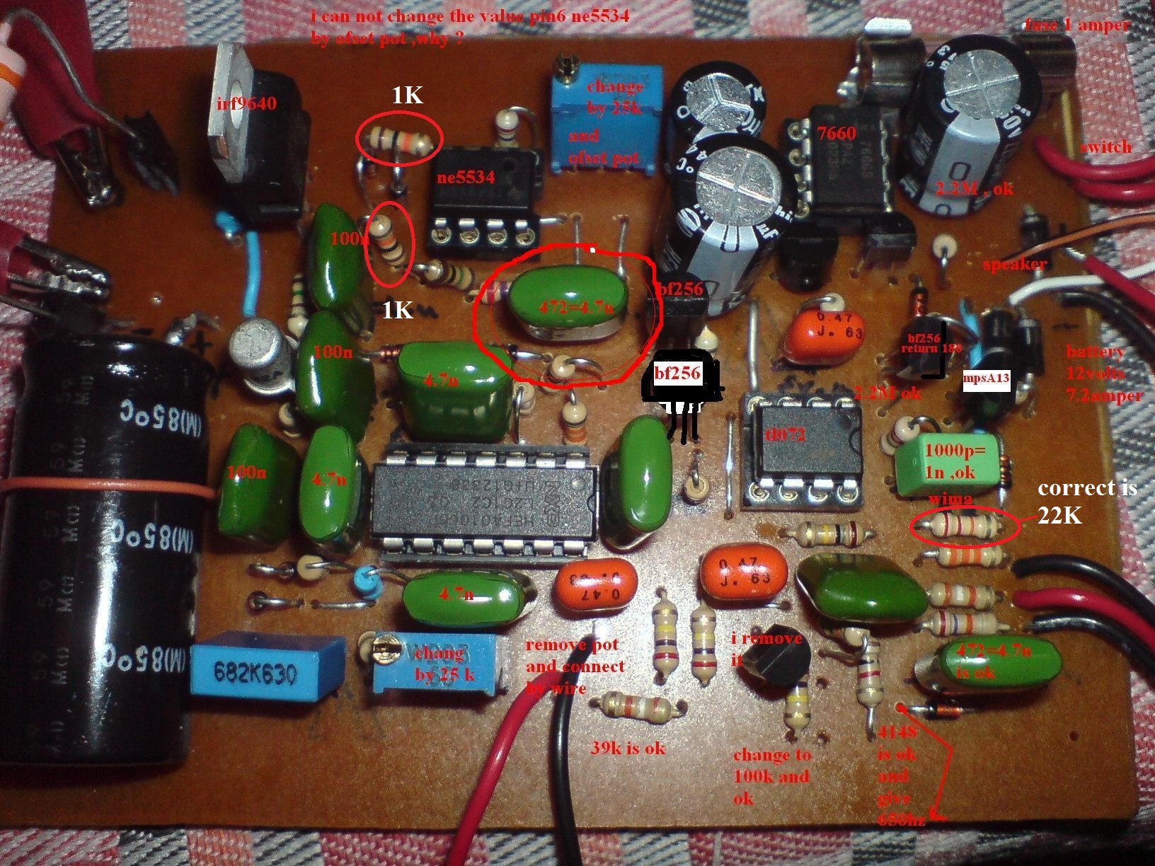

            • Mohandes, the image with capacitor C16 470nF this wrong, I could not remove after editing.
              • Originally posted by Wilson View Post
                Hi

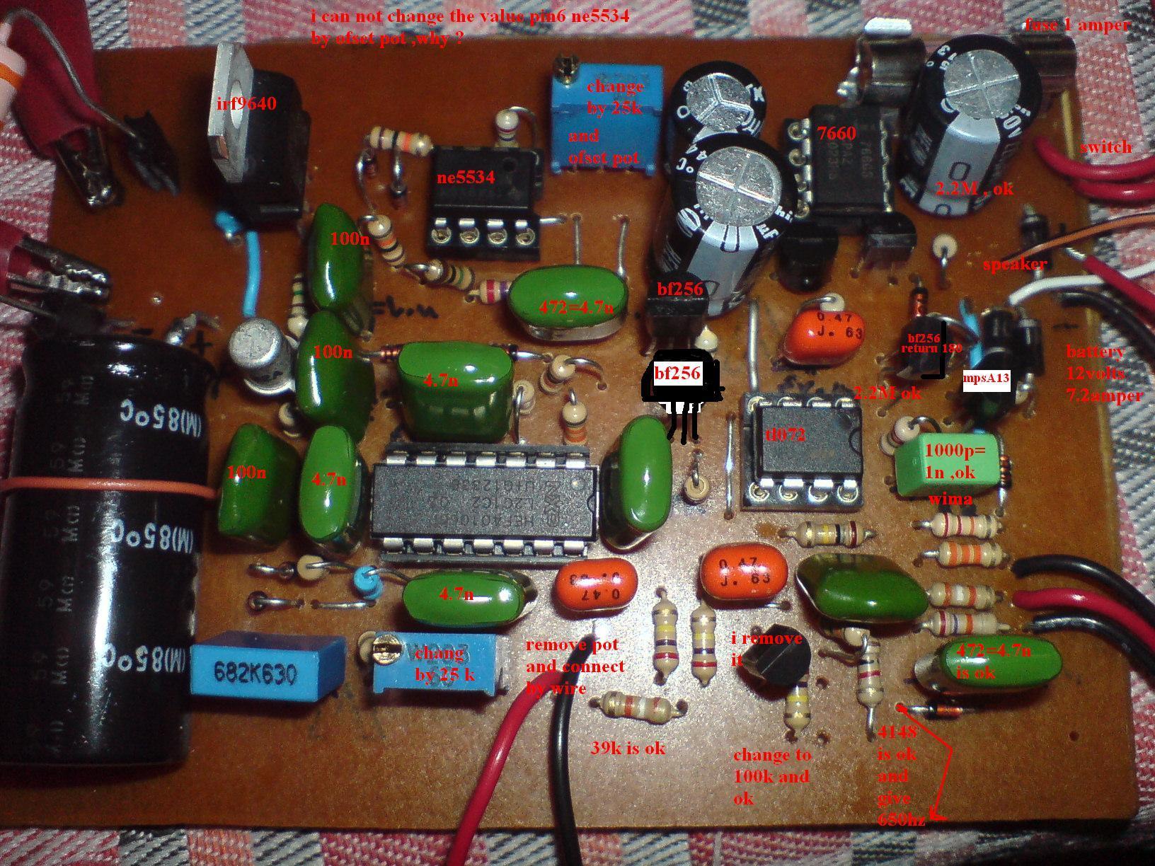

                all is ok , this is big ? for me.why ?????
Name:	Copy of DSC01736.JPG
ID:	337797Click image for larger version

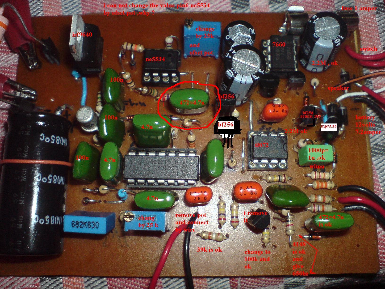

                  • Capacitor
                    Hello Mohandes: In your photo, Cap 11 has an incorrect value. Must be 100nF.
                    Greetings.
                    FabianClick image for larger version

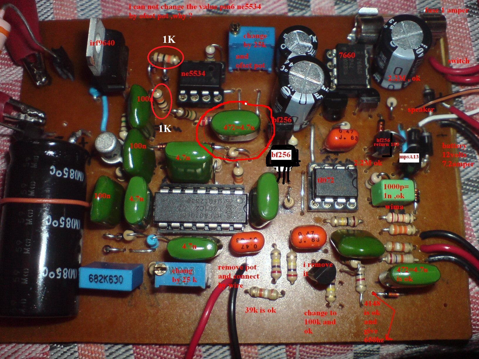

                          • Hello Mohandes, good news you missed two resistors, the correct is 1K and 10K you installed.
                            The gain was reduced from 1000 to 100 times.
                            • Mohandes, I seem to have another resistor wrong, the correct is 22K if I'm not mistaken the image is 220homs check.
                              It is advisable to review all components carefully. You have to make sure that the components are correct not to create problems and make it difficult to correct.
                              The first thing to do is a visual inspection of the components, solder and pcb before putting into operation.
                              Hug.
                              • Check the resistor behind the IRF9640, the correct value is 1K.
