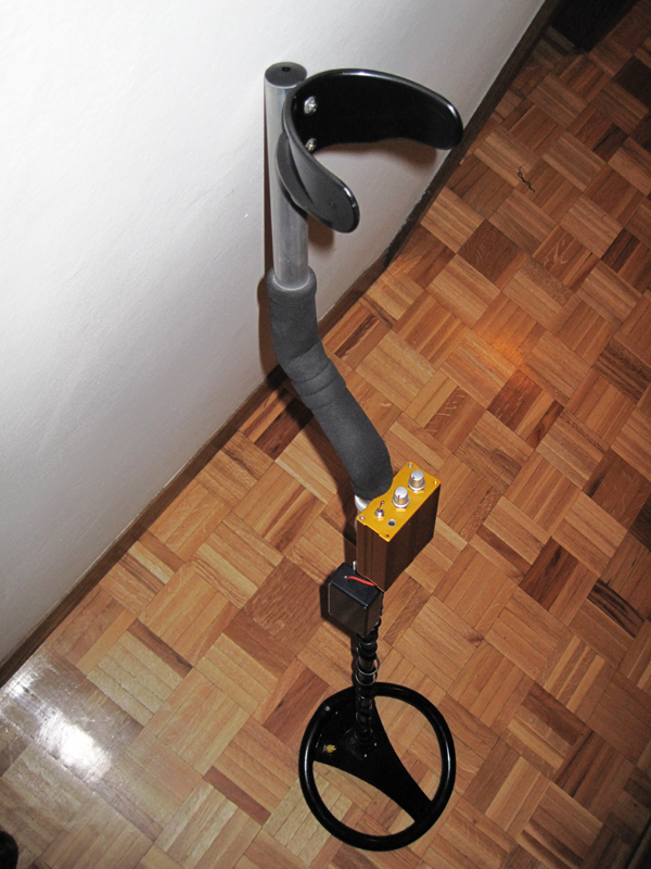

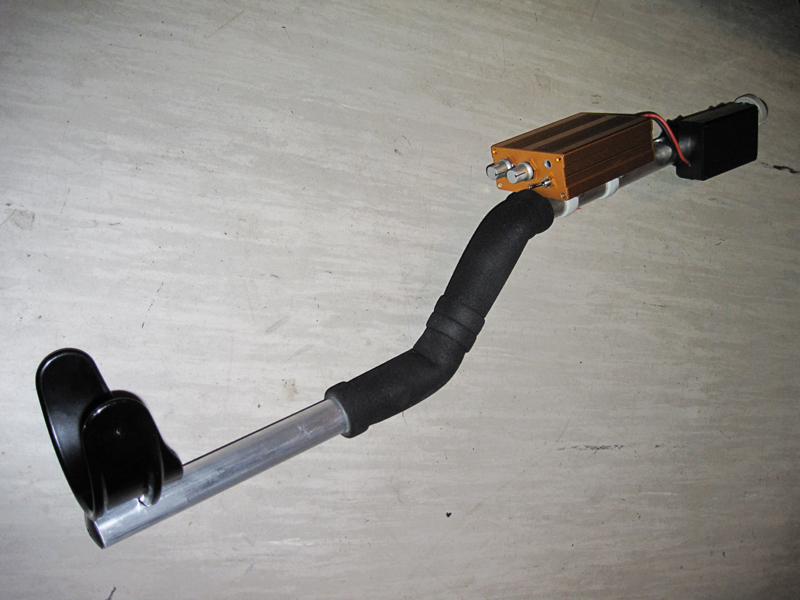

                • Hello all!
                  Ok so i finally finished my Baracuda today. Tomorow i will do some field test i hope Here are some pictures. The housing with lipo battery is separated from the circuit box. Also the upper frame is made from aluminium tubing and the lower part is made from fiberglass tube. The coil and coil housing is also home made. I think it turned up quite well. And thank you for all the help from you guys!
                  Ok now in figure 1 is the whole detector.

                  And now only the upper part with baracuda and lipo battery housing.
                  Have a nice day!
                  • Well done
                    Nice job Pepsi

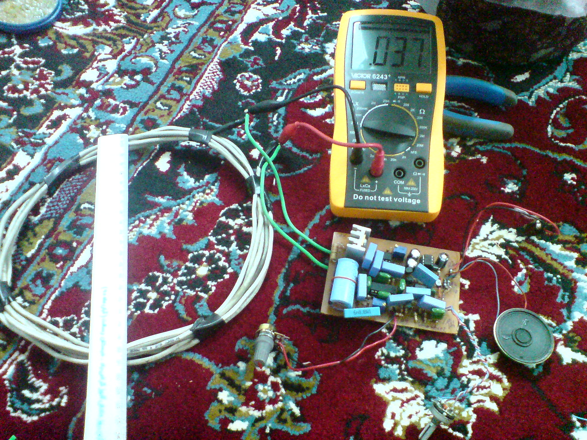

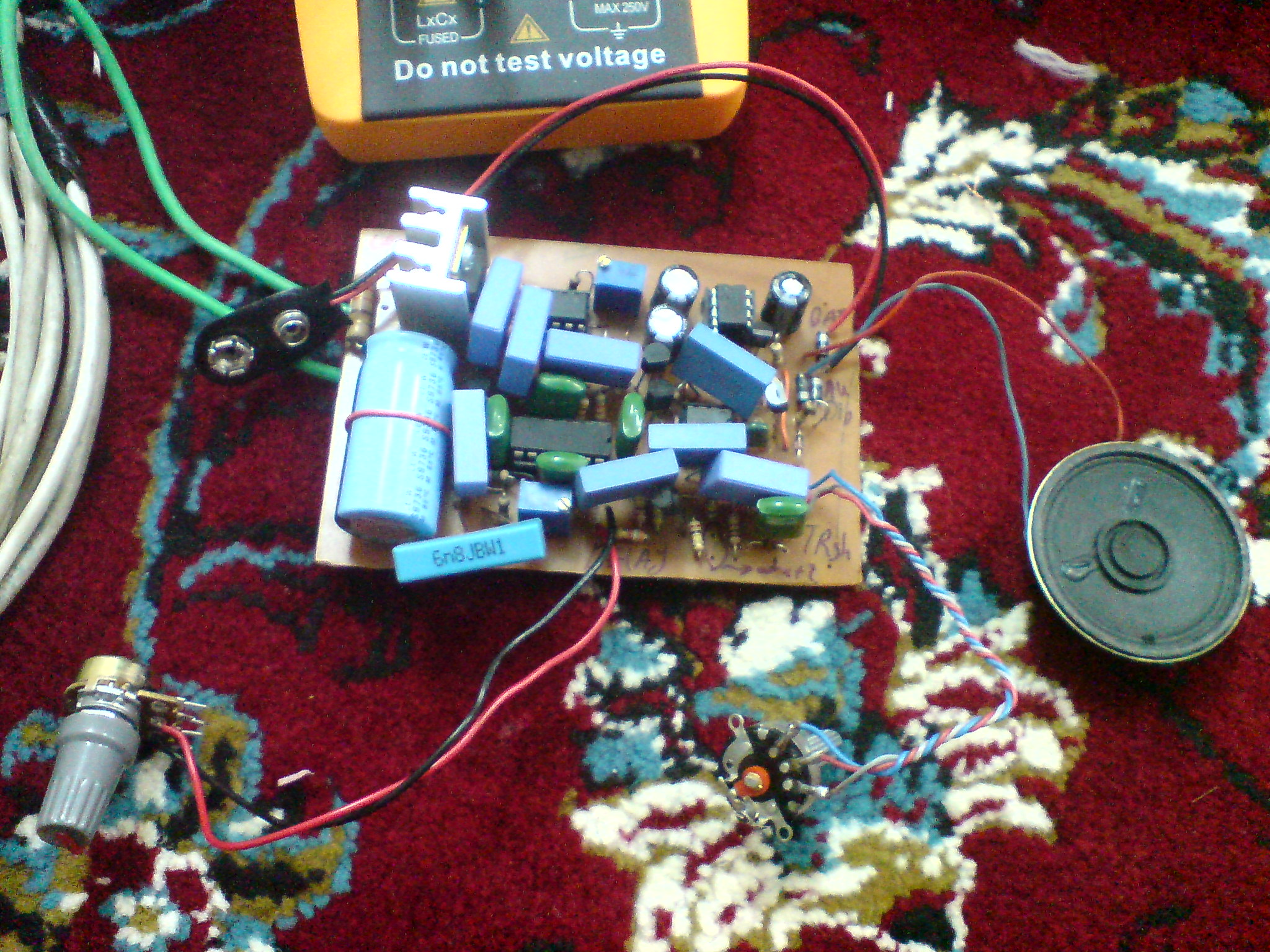

                              • finall help
                                hi all gurus
                                mr Apberg & wilson and porkluver ...help me for the wiring
                                tell me please about the differents ? should be i remove the delay and mpf102 near delay volume?
                                if have error tell me please
                                i happy if you guid me
