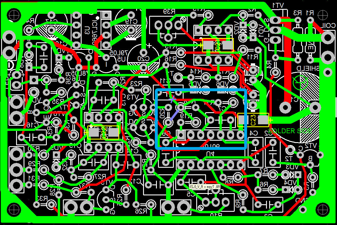

        • I haven't build the barracuda yet , i only looked at the schematic because im building the board.
          I want to use my 3.2 - 3.3V LED instead of a red one with a forward voltage of 1.9v which.
          • do not looked the schematic. you waste a time. no differency what LED you use.
            better do George's mod and set the resistors from his schematic.
            i corrected BOM included the mod.
            • I dont know Georges mod. I have bought LED Bezels and i want to have a LED in the front of my Housing where the Pots are.
              Is this mod already in my bom and gerber files?

                • i have 9pcs boards not sold... i correct a layout only after full realisation.
                  mod is simple to do.
                  take George's schematic and mine, compare, and you will see differency. look on resistors on 40106.
                  It's both. The Geotech Baracuda REV-A (when it's finally released as a PCB) will be a corrected and slightly modified version of the original Baracuda. If anyone wants to patch their original Baracuda, I can post a list of changes required. These changes essentially consist of connecting the pull-up resistors to 0v instead of +5V, and some modifications to the power supply smoothing capacitor connections, plus one additional capacitor and a value change. The offset null on the NE5534 can stay as it is. A final [optional] update is to unplug the 7660S, and plug in an LT1054.

                    • you have to cut one trace and do one connection, on bottom side.
                      • Originally posted by BKY1337 View Post
                        Ok , i will take a look at it but i already have everything soldered.
                        ok, you can use the board as-is. but if you meet a problem with 40106 burnt you know a way.
                        • Ok, can you tell me what this mod does? Will i have more depht or more sensitivity?
                          And can you tell me pls which coil i should use? Wire thickness and uH.
                          Do you think 0,5mm wire is good and 330 uH with graphite shield.
                          • about coil for bara i told scaled http://www.geotech1.com/forums/showt...l-for-baracuda
                            George mod is not about sensitivyty and the depth =) leave all as-is.
                            do not do the mod now.
