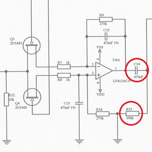

              • Originally posted by pnp007 View Post
                i have a problem with my barracuda. when swing the coil to the right beep will occur, swing to left no beep. When i change the wire beep sound at left side.
                Hello pnp007 check these components in red circles. C14 and R35 can check this with the wrong value, if the values ​​are greater than the original on the RC time will be greater and may possibly happen as you describe. Take a test, place a coin on the floor and pass the coil over it and wait for 5 seconds to return the coil on the coin again and check if the audio plays both ways, always giving a time frame to return the coil.
                If the values ​​are correct, check the PCB on both sides of R35.
                Pnp007, this is my opinion I could be wrong not hurt to check.

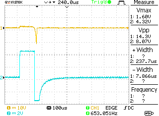

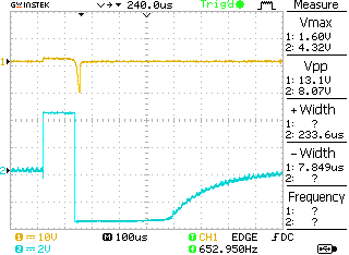

                • WHO can help me ;
                  i make another coil 25 cm and 480mkh and 0.7ohm.
                  i replace all transistor by bf256.i have problem in detection.and use irf instead of tip127.
                  explain more :
                  i have all voltages and all frequency (+5,-5v , 650 hz) JUST in my coil i have not 250 volts.
                  i think my problem can not in my coil and it is in equevalent parts(just transistors),do i say ok???
                  please tell me
                  edit :
                  without thing near the coil like this wave
                  when i put large ferrous like this :

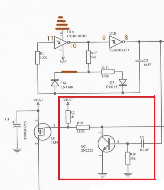

                              • Hello Mohandes, check the components and pcb tracks inside the square in red, you are using the transistor right? 2N2222A, make sure the position is correct base, collector and emitter. Check with oscliloscópio collector Q2 (2N2222A) and post the image.
