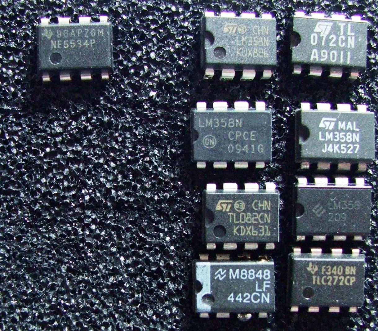

          Hello,
          Made a small test... for U2 I only have the Ne5534p ...
          for U4 I tested 8 IC's, they als work and not much differents .... I like the LM358 (j4k527) the TLC272 and the lF442 ... some re-adjustment with the tune(threshold) potentiometer is needed , but then they al get good sens....
          Best regards
          Ap
