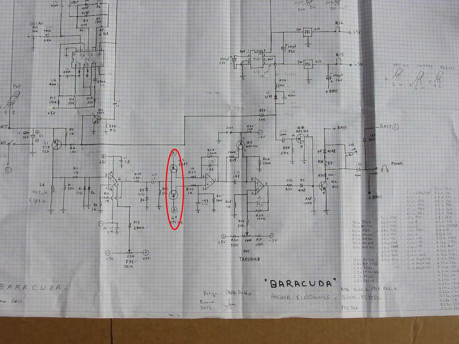

    Great job ApBerg!! Good work, as always from you!
    As you know I thought it was strange to have 2 different FET's, now we can guess why - it doesn't matter as long as they are matched!
    Regards, Jim.
    • Thanks for trying to help me. Still don't understand it. Like I said this is greek to me, if someone could just point out which 2 fets should be the same I would appreciate it.
      Bob

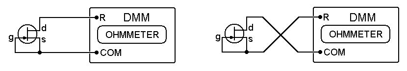

      • Hi! All
        If you use 4066 instead the fets, like Surfmaster, then...
        Dirceu

          Bob, I agree with DIRCEU that you can use 4066 because Q3 and Q4 operate as analog switches. In this case the most important parameter is Rds_on.
          The parameter can be measured with an ohmmeter as shown below.
          • ...But then sample pulse pulse polarity must be changed
            • Originally posted by habitbraker View Post
              The analog switch should operate with both polarities. What is the funny?
              • Should add FET Sockets
                Should add some simple 3 pin sockets in place of the FETS so you can experiment with FETs to find a good match.
                  oh yes of course - you always can connect negative supply to VSS and 0V to VDD.
                  Why funny?

                    • PLEASE can somebody show me which 2 fets should be matched???? I don't want to cook my one and only board.
                      Bob
                      • Originally posted by plumabob View Post
                        Bob
                        There is talk of Q3 and Q4.
                        • Thanks, Maikl! Now i got it!
                          Bob
