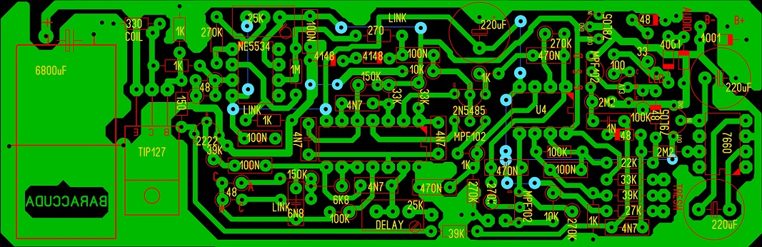

  • Originally posted by ApBerg View Post
    Hello Mohandes,
    . [ATTACH]24580[/ATTACH][ATTACH]24581[/ATTACH]
    think this are the JPG's that are for the baracuda as in the forum, the pcb is copper outsides 94 mm (..I made to many different layouts) so check things before you start ! The circuit diagrams are at the start from this baracuda topic, made by Alex . Before you start look at them to see what parts you have in Iran or what replacement you can get and collect the needed data sheets from WWW to see the pin-connections.
    Succes

    • hello mohanes
      easy print the layout and see at printout if ic socket or ic fit onto holes
      also check caps most 5mm spacing
      if printout is not right sizes scale printout via printer control

        • long pcb
          I redid the PCB. The long version. I do not do it. Check before assembly.

            • Thanks smity nice board, should be easy to etch as well!.

                            • Fixed a bug in the printed circuit board (post number 694). There has been no power to the 8 pin 7660. Corrected circuit board in the archive.
                              • hello smity many thnaks for a longboard
                                would you please post a black white picture jpg or gif format
                                is it sprintlayout 6 format? because of ending ***.lay6 ?
