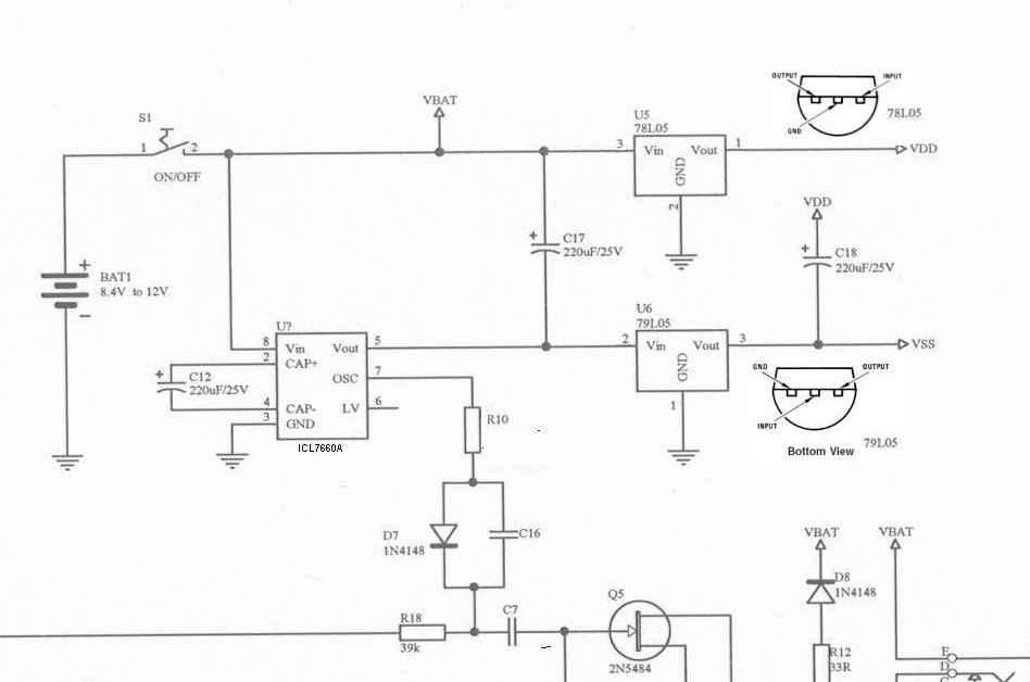

      In the Barracuda circuit, the 7660 voltage converter is powered from a 78L05, which means the negative voltage at pin 5 will not be -5V as shown in the schematic. This voltage is always lower than expected. You could improve this circuit by breaking the track that goes between the 78L05 output and pin8 of the 7660, and connecting the 7660's input directly to the +ve side of the battery. In this case you must use a 7660A, as the 7660 has a maximum input voltage of 10V. Also, the 7660 is synchronized to the TX oscillator via pin 2. Since the TX pulse rate is relatively low for the 7660 to operate efficiently, this will also cause the -5V supply to drop out when the input voltage is lowered.
      I've got to disagree with you on that, Qiaozhi. I don't have a Baracuda to look at but from looking at the RE schematic (from I don't know who) the 7660 pin-8 input and 78L05 input are both connected to the B+.
      Alexismex's hand drawn schematic also shows 78L05 and ICL7660 inputs connected, to what must be B+.
      If there were less than -5V being outputted from the 7660, there would be no need to have a 79L05 in the circuit because it would not work.

        ?? The Barracuda's 7660 has his + in from the batt's/power supplay ...that way care must be taken for the batt/power supllay ...not more than 12 volts !! higher voltage's are not healty for the 7660 !
        For the surfmaster is Qiaozhi's explaining OK.
                Interesting ... the schematic I was looking at is labelled "Barracuda PI", but on closer examination it's obviously a Surf PI.
                You can see that the designer of the Barracuda must have also spotted the same problem with the power supply. In that case, try applying this mod to the Surf and see what happens.

                      • Just a note on the -5 volt output
                        on one of the barracuda boards i fixed , it had a low output of about -3 volts with the rest of the chips plugged in, turned out to be a faulty 40106, changed it and it works nicely
                        • "build mono fast coils" was not regsniff the autor was bbsailor excuse me
                          • Hi 6666, I ordered a 40106 for my bara today. tried replacing the 7660a but still have less than -3volts with poor sensitivity. sounds like you were experiencing the same problem. Hope replacing the 40106 clears up my problem.

                            • Hello guys,
                              I encounter the problem for the 40106..... years ago...it is very simple :
                              every manufacturer has a different specification in this particular CI
                              Because the 40106 in the Bara fix Delay, window , etc.... if you has installed a 40106 from TI it want give you a "x" delay o window....change it with a different manu (ex NTE) and it will give you another delay o window ,with STMI another !!!!
                              Here is the trouble ... you must work with the same 40106 manufacturer !!!! and all the Bara will working the same
                              • Hi Alex
                                yes we should be using the same chips
                                with my faulty 40106 chips, they had something wrong with them
                                on the bara I made I had a -5 volt rail that was down to about -3volt
                                changed it to a HEF40106BP made by NXD and its works at -4.98 v
                                on the other board I fixed, the -5volt rail was down to about -2.5 volts
                                and the coil had an audio sound, yes it was oscillating so I could hear it.
                                I tried that 40106 chip in my board and same thing, low voltage and audible coil sound
                                so changed to a CD40106BE made by TI, and it all works
