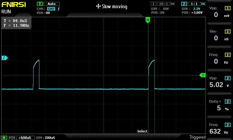

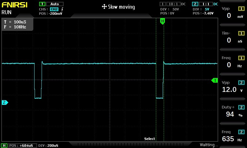

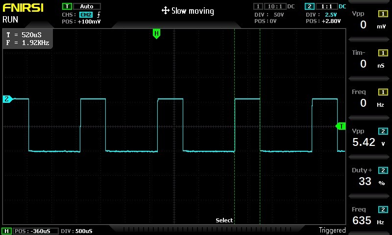

    i can't adjust u2 (ne5534) pin 6
    here some info
    2n2222 base
    Click image for larger version  Name:	8.jpg Views:	0 Size:	70.7 KB ID:	440472
    irf9640 gate
    Click image for larger version  Name:	7.jpg Views:	0 Size:	69.3 KB ID:	440473

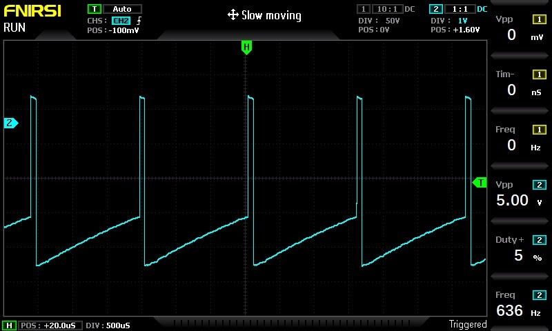

    cd40106 pin4
    Click image for larger version  Name:	1.jpg Views:	0 Size:	68.3 KB ID:	440474

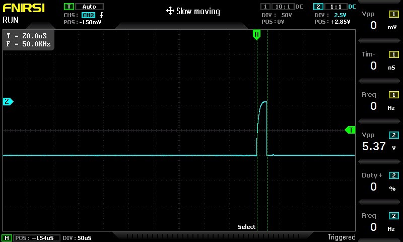

    cd40106 pin6 (main simple delay)
    Click image for larger version  Name:	2.jpg Views:	0 Size:	65.0 KB ID:	440475

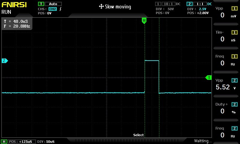

    cd40106 pin10 (main sample pulse width)
    Click image for larger version  Name:	3.jpg Views:	0 Size:	65.4 KB ID:	440476

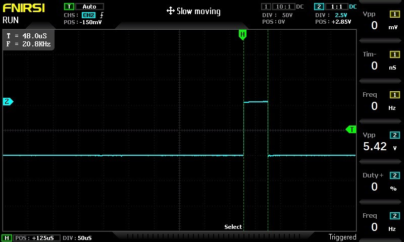

    cd40106 pin 8 (Secondary sample delay)
    Click image for larger version  Name:	5.jpg Views:	0 Size:	70.1 KB ID:	440477
    cd40106 pin12 (Secondary sample pulse)
    Click image for larger version  Name:	4.jpg Views:	0 Size:	66.8 KB ID:	440478

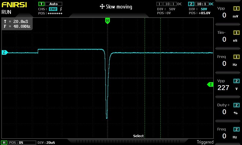

    fly back
    Click image for larger version  Name:	6.jpg Views:	0 Size:	68.9 KB ID:	440479
    this video playing in damping resistor
    THX FOR ANY HELP
    • You've posted a bunch of waveforms that have nothing to do with U2-pin6. What, exactly, is the problem? You can't adjust the output offset of U2?

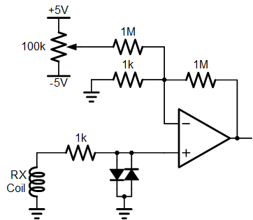

                      • It's possible the NE5534 is a fake. Can you post the waveform on pin 6? Also double check the values of R6 and R8, and that R8 has a good connection to +5V.
                        Here is a more universal method of offset adjustment that will work with any opamp:
                          Click image for larger version  Name:	image.png Views:	3 Size:	12.6 KB ID:	440503​
                          This is the waveform of ne5534 pin6 in video below
                          i am playing in damping resistor
                          • the horizontal part of the signal must be sure lie on X axis. is it clear?
                              Yes
                              i need to change ne5534 i think it's fake
                              the others waveform i posted are they ok ?
                              • Originally posted by Deghbar613 View Post
                                The response decay is way too slow. I suspect a fake opamp.
