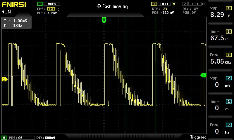

  • From where have you bought your NE5534 IC chip?
      The response decay is way too slow. I suspect a fake opamp.
      Yes it's fake i changed it with lf356 null offset works perfect but there is lot of noise so i will try find original ne5534
      but in datasheet lf356 slow rate is 12v/us and ne5534 is 13v/us i don't know from where this noise

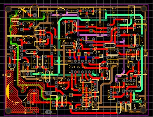

          I've taken a look at your PCB design. There's a ground loop on your circuit board. You should avoid ground loops. The ground loop might be picking up the noise. Just cut the loop somewhere. Also, the resistor in the negative terminal of the NE5534 is quite far from the actual IC chip. I would place it closer to the IC chip.
              Thanks for advice GeoMax i will working on it

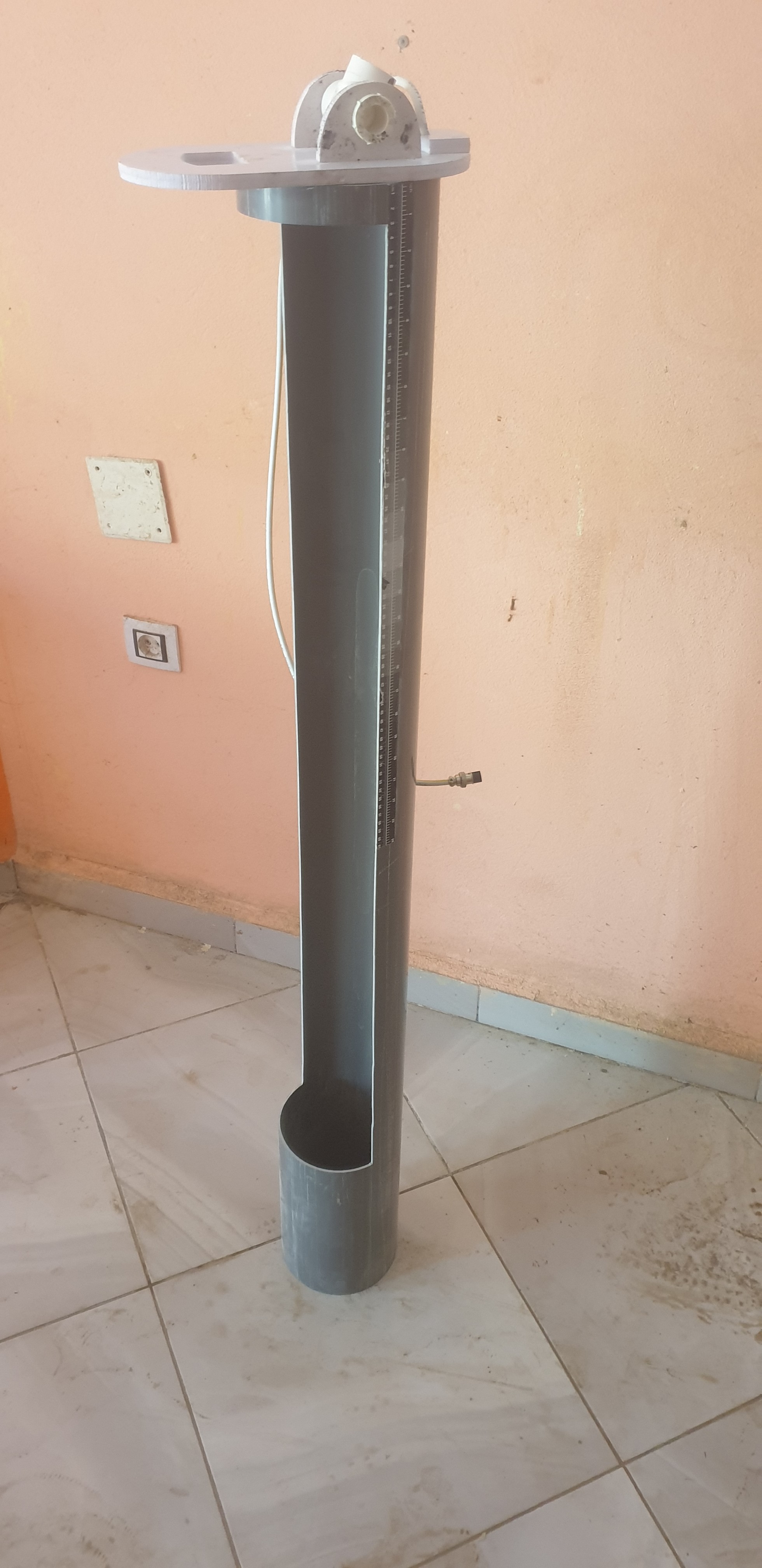

                    indoor i am using this
                    Click image for larger version  Name:	20251025_140238.jpg Views:	0 Size:	981.5 KB ID:	441947
                    • Hello,
                      Perhaps the noise is caused by the cables in the wall, the fluorescent light, or the iron mat in the concrete floor, etc. – all possible sources of the problem.​

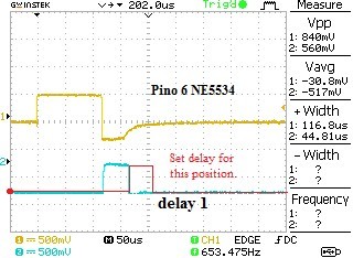

                      • i found this picture in the forum
                        Click image for larger version  Name:	pin6ne5534 & pin2 40106.jpg Views:	0 Size:	30.3 KB ID:	441958
                        from where can i adjust delay position .
                        and why move delay to this postion ?

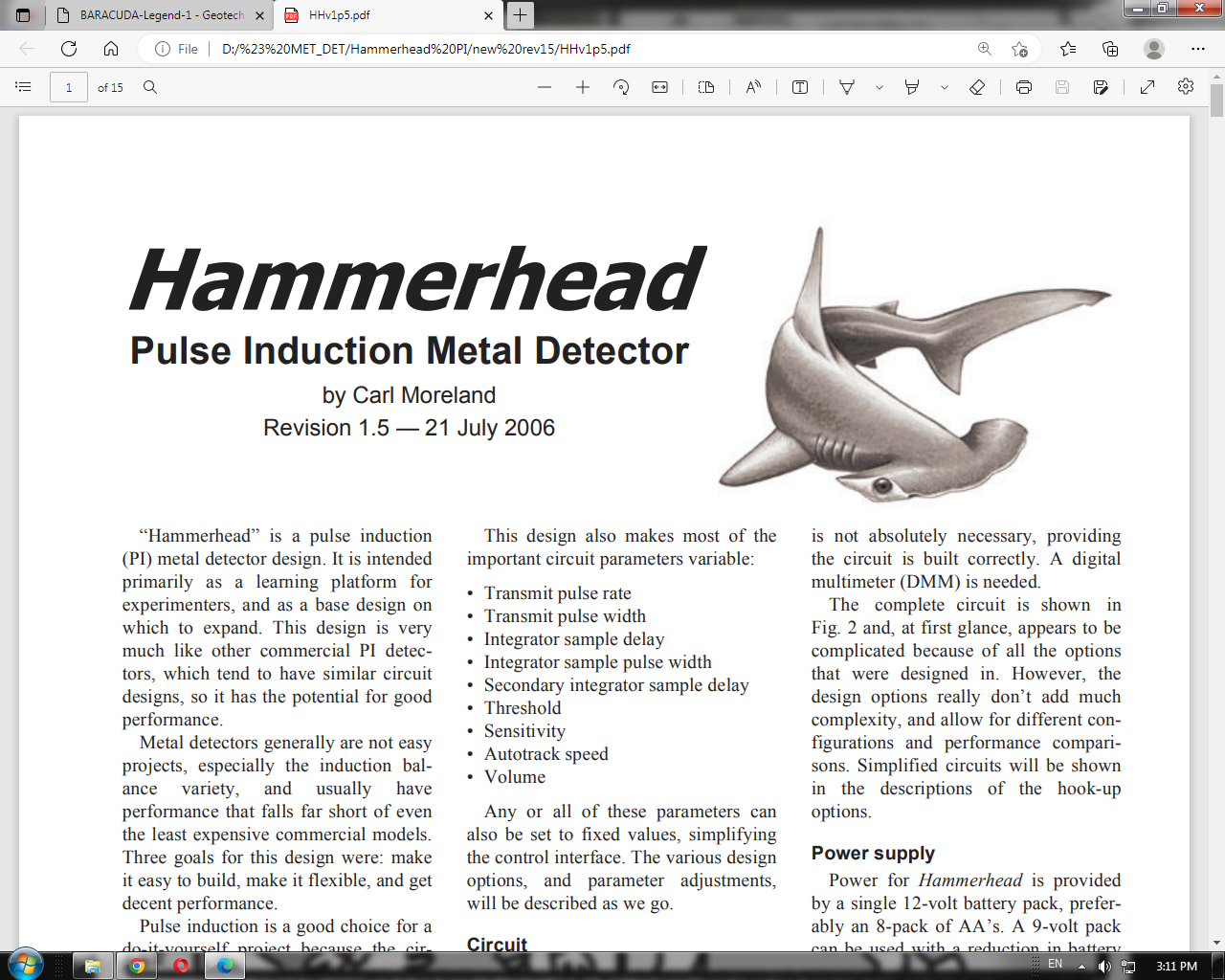

                        • you ask general principles how-PI-work. do you need to read ITMD? ITMD is a some book released by Carl Moreland and George O. Carl Moreland is an administrator/creator of this forum.
                          also, you can find all theoretics you so needed in an article HAMMERHEAD PULSE INDUCTION METAL DETECTOR by Carl Moreland.

                              • hello evryone
                                i need help
                                first i want gives some info

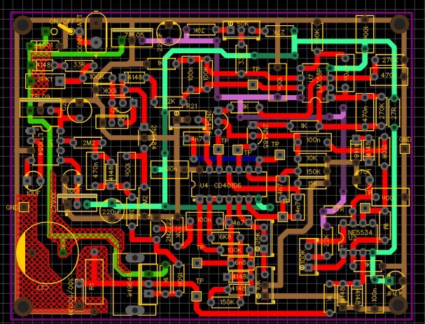

                                this is my PCB
                                Click image for larger version  Name:	Capture d’écran 2025-11-04 140752.jpg Views:	0 Size:	151.5 KB ID:	442151
                                this flyback
                                Click image for larger version  Name:	1.jpg Views:	0 Size:	62.6 KB ID:	442152

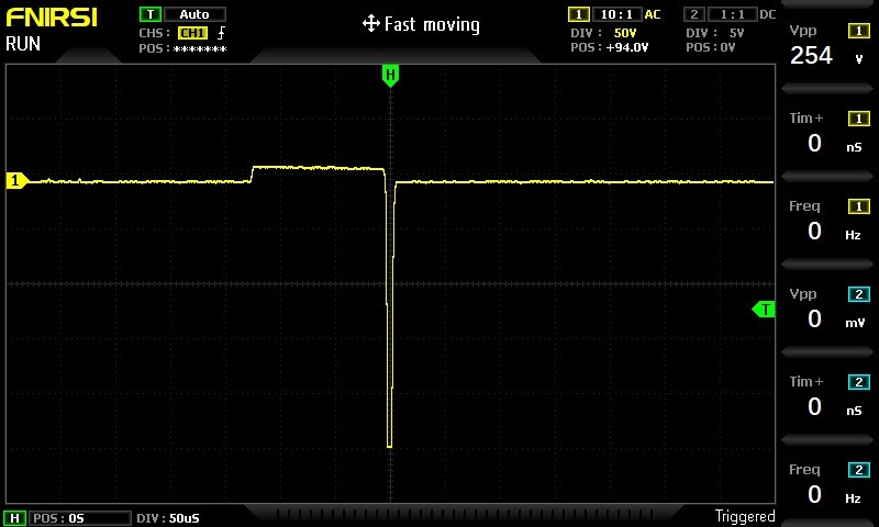

                                this ne5534_pin3
                                Click image for larger version  Name:	6.jpg Views:	0 Size:	62.0 KB ID:	442154

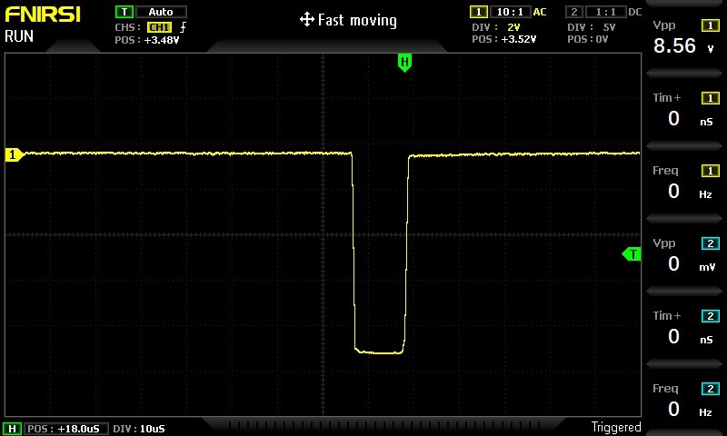

                                here is the problem
                                ne5534_pin6
                                Click image for larger version  Name:	2.jpg Views:	0 Size:	89.3 KB ID:	442155

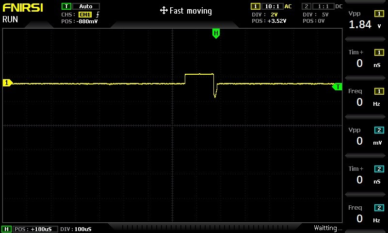

                                when i remove R8(22K) i get this on ne5534_pin6
                                Click image for larger version  Name:	5.jpg Views:	0 Size:	65.3 KB ID:	442156
                                ne5534 not fake
                                please any help
