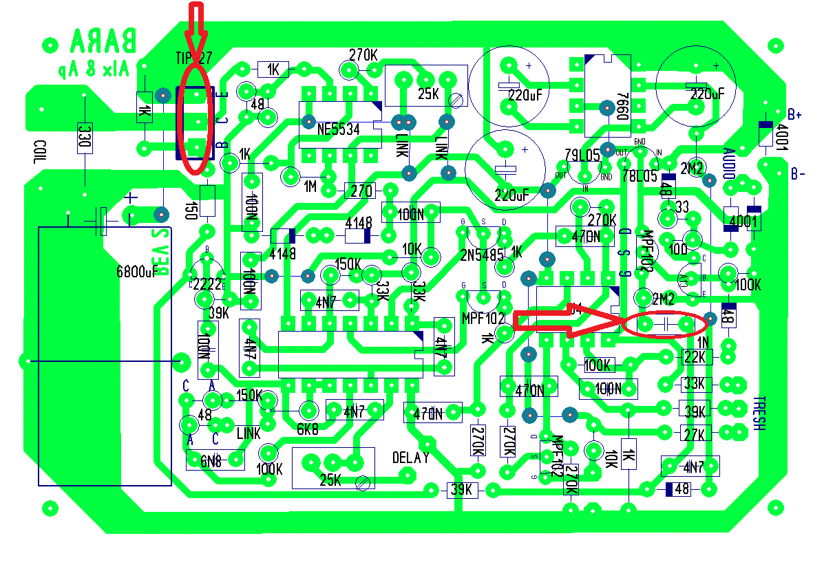

                        • What is the value of these components highlighted in red circles? I have almost completed soldering the components except these two.Click image for larger version

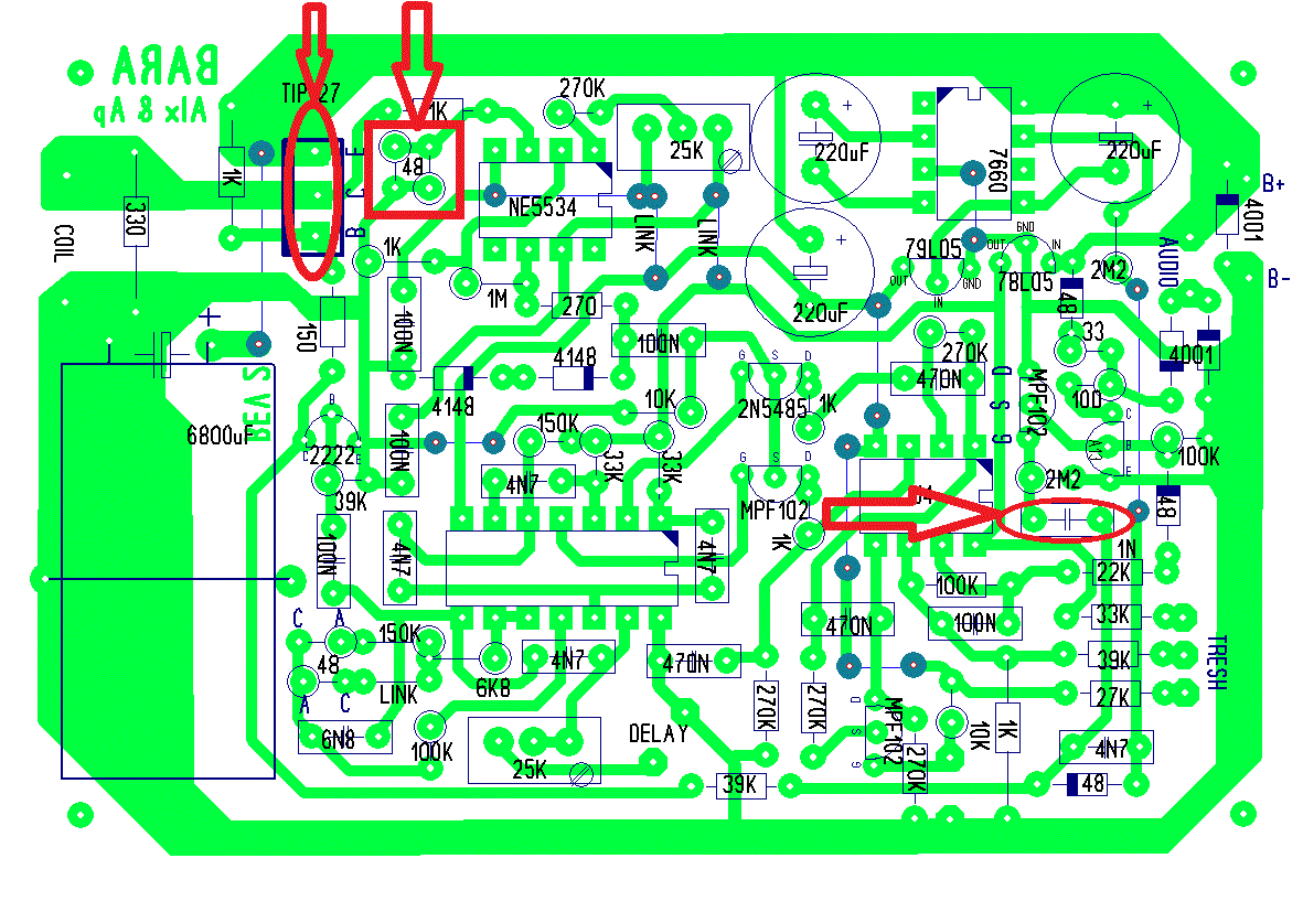

                          • And what is the value and direction of components highlighted in red square?Click image for larger version
                            • TIP127 in TO-220 pack. two diodes 1N4148. 100nF.
