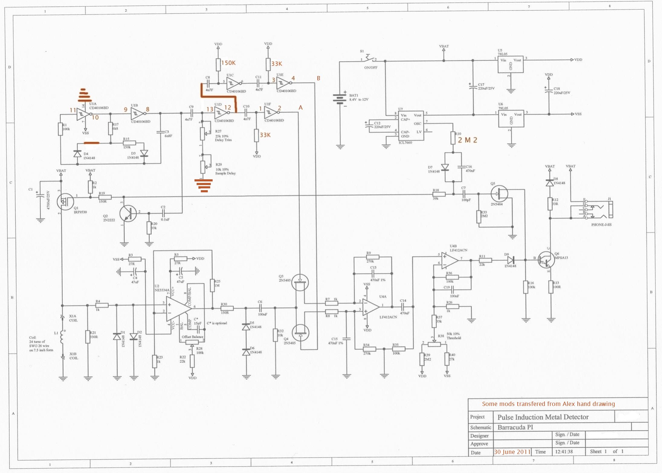

    I have transferred some of the mods by Alex / APberg and Silver dog PCB to the old Barra schematic
    it is not fully complete, I will complete it as I build it and get it working
    I think I have done the drawing right so far, mods in orange colour dated 30 june 2011
    I did it late last night and I am not well with flu

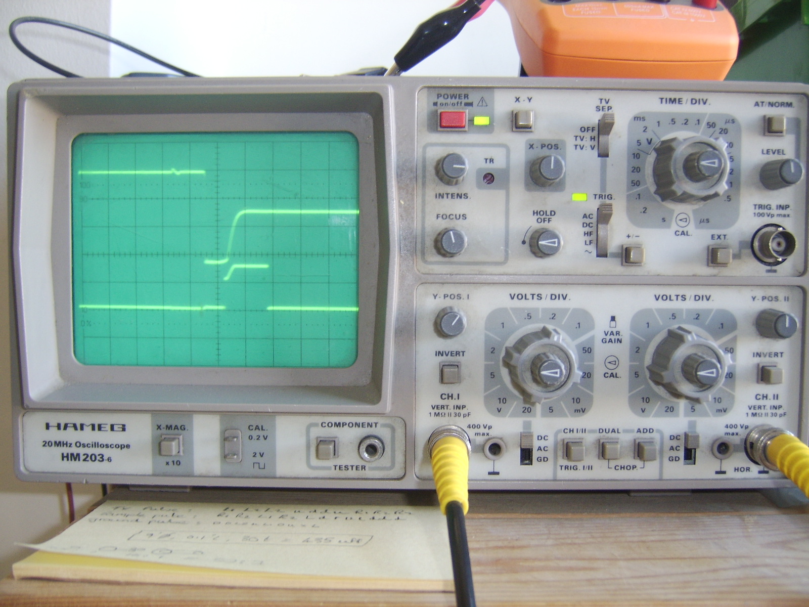

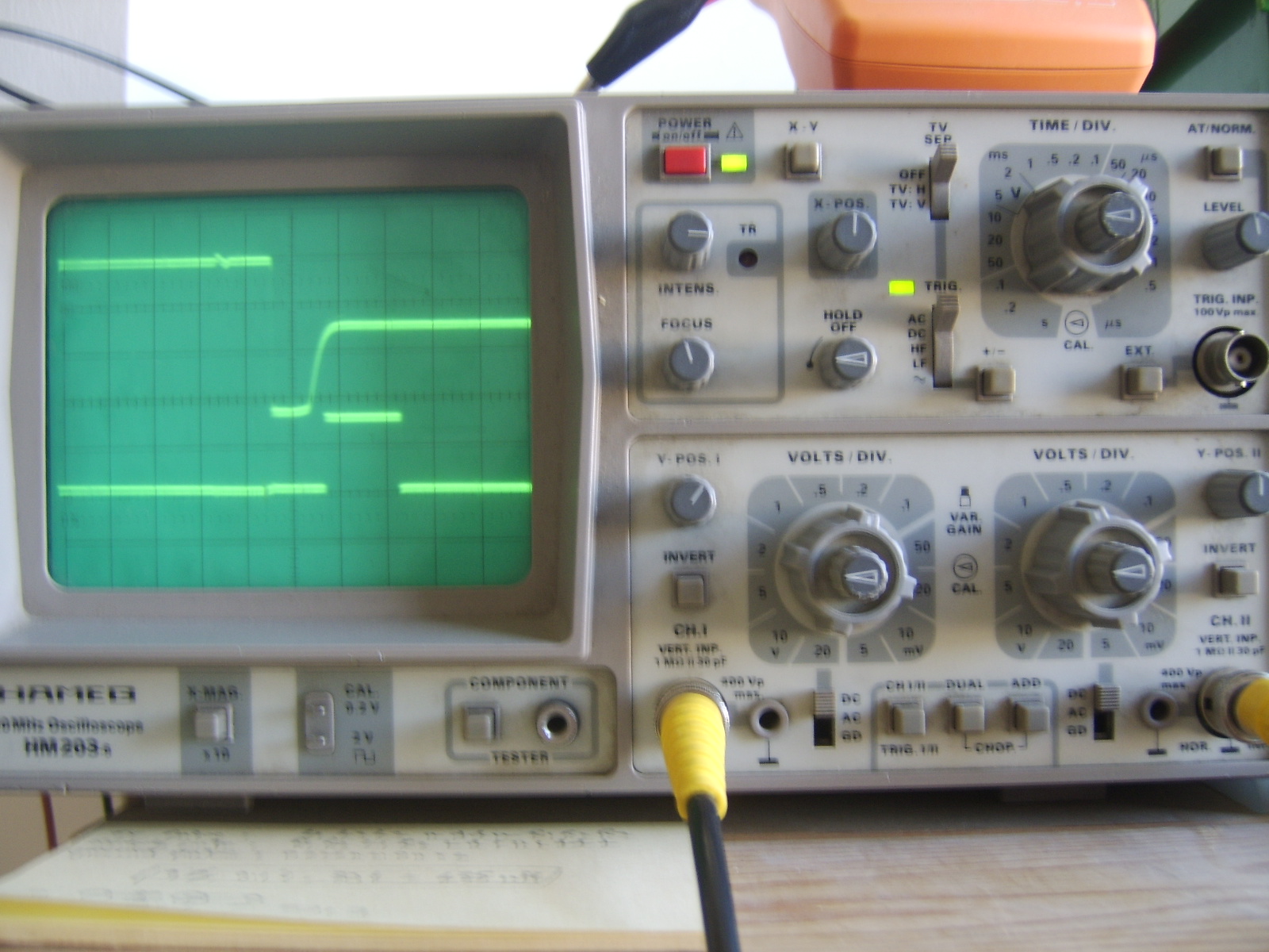

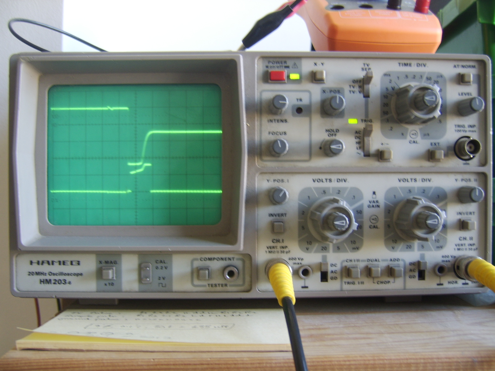

            • Hi ApBerg and other friends,
              Have attached some photos of my delay pulses. The top trace is the output from NE5534, the bottom trace is the delay pulse from 40106/2. I was incorrect yesterday when I said that the shape of the delay pulse was a mirror of the decay curve - it is in fact as you can see below a copy instead. Anyone have any ideas why the delay pulse is distorted like this? Would expect to see some feedback on the base of a BJT, but not on the high input impedance of a FET? Needless to say the signal coming out of gate A is a similar shape too.
              ApBerg, I'm glad to hear you have the same result and still have good performance, I won't worry about this being the cause of my poor results.
              As for the SW1, i think Smitty is correct in post 56, i followed his instrucrions and then found that the delay is set to a nice point over the decay curve (photo 2) and that the switch then puts the machine in motion / non motion modes. Very handy
              My threshold still needs to be turned completely to one side, that doesn't seem correct.
              My barracuda is now almost as sensetive as a surfPI, but if its gonna draw twice as much current as the surfPI - THEN I WANT IT TO PERFOM BETTER!!!
              Regards to all, Jim.

                  • Originally posted by TH Jim View Post
                    Hello Ap
                    One strange thing i have noticed is that the shape of the pulse on pin 2 of the 40106 seems to mirror the shape of the portion of the decay curve being sampled. The pulse on pin 4 is always a nice clean square. When the delay is adjusted to the longest setting then the pulse on pin 2 is nice and square (where the Rx signal is zero) and measures 30uS. But when it is set to a short delay (say 15uS after Tx switch off) it becomes distorted and shortened to as little as 15uS
                    Has anyone else observed this happening on pin 2 ?
                    Regards, Jim.
                    The reason you're seeing that difference between the base signals on the two sample FETs is because the non-inverting opamp input (primary sample) has a very high impedance but the inverting input (secondary sample) has an impedance approximately equal to the input resistor; 1k in this case.
                    That underscores a difference between the Baracuda and most other PI's where other PIs usually feed the primary sample to a non-inverting input with the secondary sample being fed to an inverting input.
                    Loading on the FETs would be less apparent if the samples were reversed because the primary sample would be seeing a high impedance. Although there would still be some curvature to the gate drive signal due to the shape of the decay curve, it would be much less obvious.
                    Ideally, a differential amplifier would have equal impedances on the two inputs but because of the nature of pin-2 being a 'virtual ground', that is not true.
                    I hope I clarified that.
